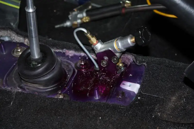

I was also considering an adjustable prop valve to put more bias to the rear. I'm still running stock gear on all 4 corners, with new disks and pads on the rear. I'm really disappointed with the ineffectiveness of the rear brakes, but I don't see a need to upgrade to better braking hardware, since it doesn't seem that the stock gear is actually getting used much! That led me to the idea of an adjustable prop valve, so I can dial in the rear bias that I want.
I'll probably add that in the spring, when I upgrade the front brakes (they need replacing anyway).
Sounds like Aerospace is pumping air up your skirt about the rear kit, IMHO.
mounted in an ash try location of a probe we did.
How do you go about setting these kurt?
