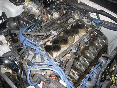

Attempting to pull lower intake. Need help, pics included.

I was pulling my lower intake off today so I can send it off to be ported by Tmoss. I was able to get the upper intake pulled off, the valve covers, and I'm stuck on where the lower is separated from the valve springs. The lifters and valve springs dont need to be removed do they? I just cant seem to find the separation.

you gotta disconnect the injectors by either pulling them out from the manifold or by disconnecting the fuel lines from the rail. then i believe theres 12 bolts holding the intake onto the heads. they are all right along the edge of the manifold. i cant remember offhand if you have to remove the distributer to get it off but if you do make sure you mark it.
Cool, thanks for the help. Yeah, pulled the injectors as well as the ACT sensor and the 12 bolts. Will pull distributer next weekend. Thanks for the help guys.

Stock radiator? Standing in front of the car it's on the passenger side bottom corner.
Also it's a good idea that once you get everything back together to change the oil before starting it back up. Water/anti-freeze will more than likely find it's way into the pan.
the right way is i think theres a drain plug on the block somewhere but.....if you drain the radiator or pull the bottom hose that will help.......there's still gonna be some water in there and you wont know it till you pull the manifold....which, i've done it that way before and gotten water in there and just made sure to change the oil before i started it again.....i guess theres a neat trick of sucking the water out of an engine with a shop vac to but i'm not sure how thats done....
you don't have to pull the distributor to get the manifold off, but it does give you more room to work, especially when re installing it and dealing with the front seal/gasket area.....
Coolant will make it's way into the engine and down into the pan...yeah even if you drain it some coolant will make it's way down. The coolant does not mix well with the oil and can definately create problems for the internals in terms of proper lubrication. You MUST change the oil after an intake change.
yes as long as you do NOT start it untill you change the oil.......the water will run into the lifter area, down the drain back holes and into the pan.so technically it wont get into the filter.......if alot of water gets in there you may wanna change the oil and filter again after its up and back together just to make sure cuz it don't take much water to turn your oil into baby poo in a hurry.......
