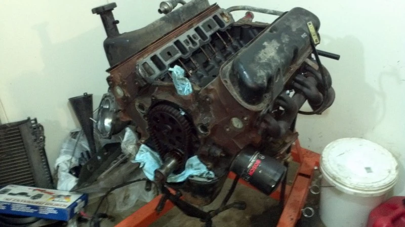

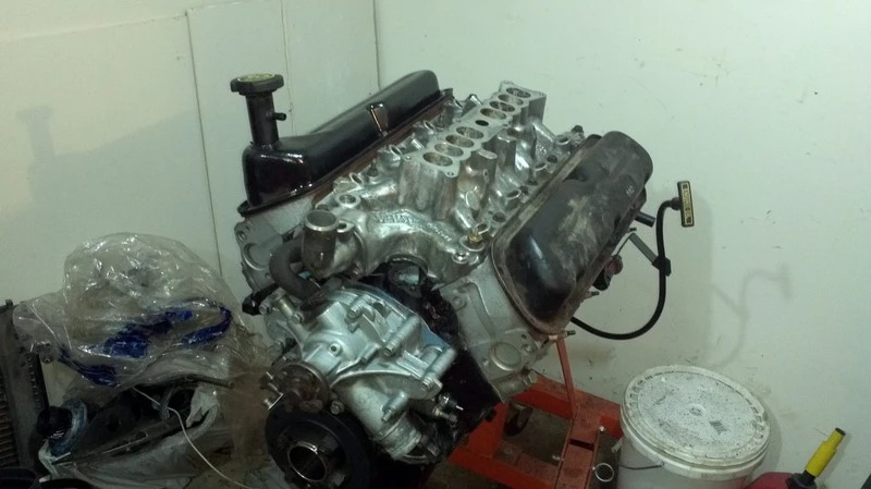

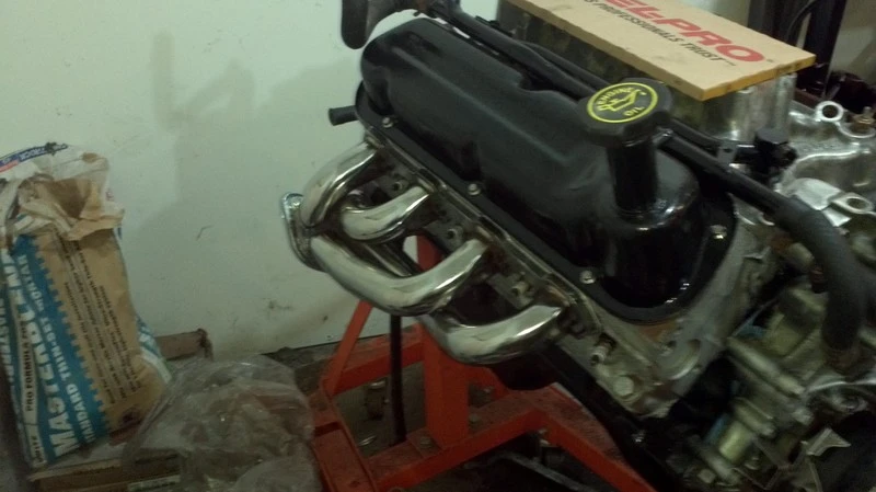

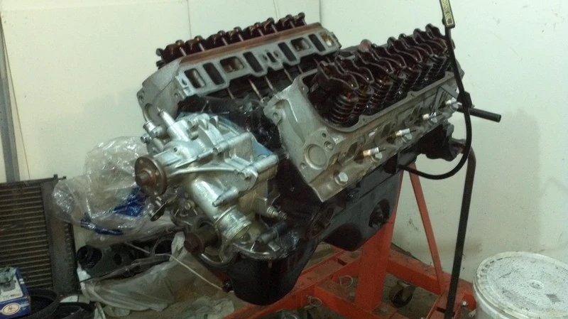

The engine I got is from a wrecked 95 GT with 120k on it. I can't just drop in an old nasty engine so I've been working on it for the last couple months. Replaced the balancer, timing chain, and lifters....cleaned up and ported the lower intake...The valve covers were rusted and nasty so I cleaned them up and repainted them. Working on polishing the upper intake. Also ordered a set of shorty headers that should be here today.

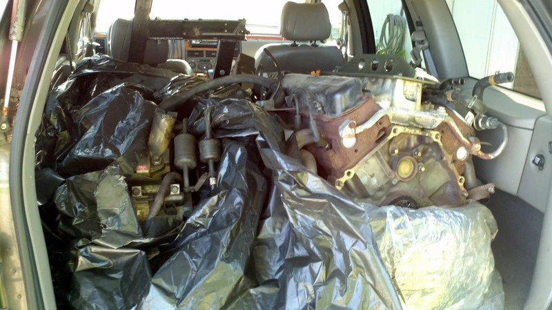

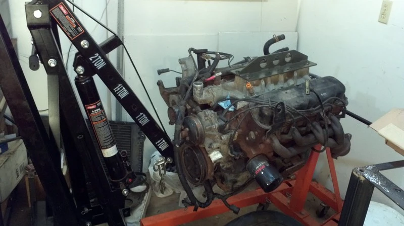

Loaded in the Jeep :)
On the stand

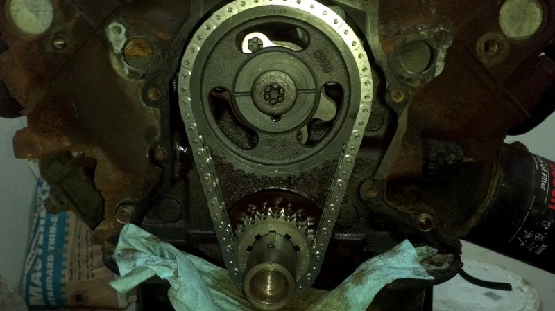

New timing chain. Installed +2* at 112 ICL after a ton of research.
Quick and dirty paint job
How it looks right now. Still working on the second valve cover

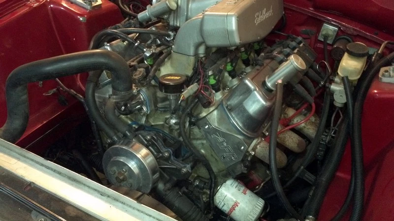

Made some decent progress last night. I drove it one last time so it was really hot when we started working on it. Oops. Got the transmission out and the front accessories off. We'll have the engine out tonight and the 5.0 dropped in either late tonight or tomorrow afternoon.
Cheap SS headers. Not great, but can't complain for the price.

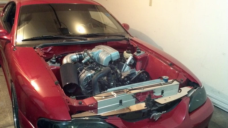

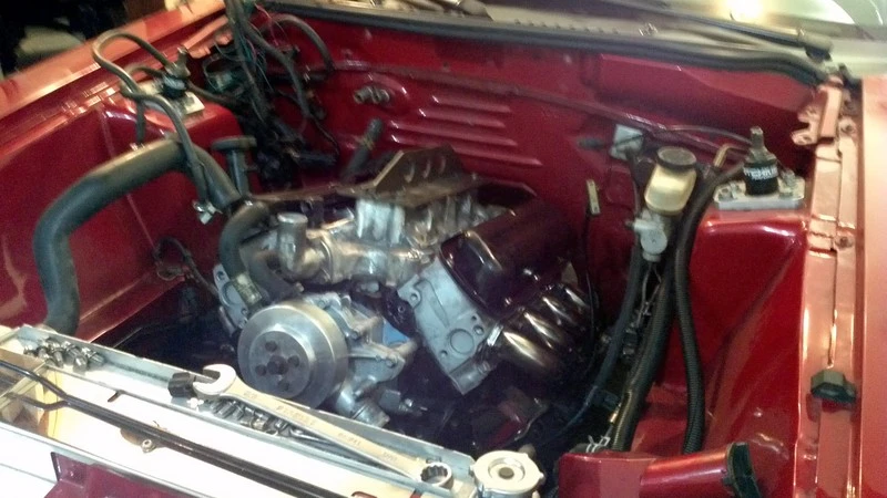

Got the engine set down in the car. I'm wore out so I'm taking the rest of the day off. I'll work on finding a transmission this week as well as finish the wiring and other misc stuff.
