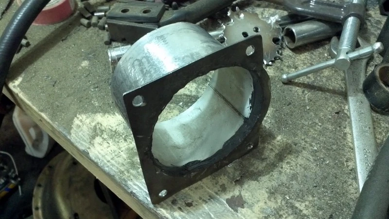

Here's the MAF adapter I fabbed up. It doesn't look great, but it works.

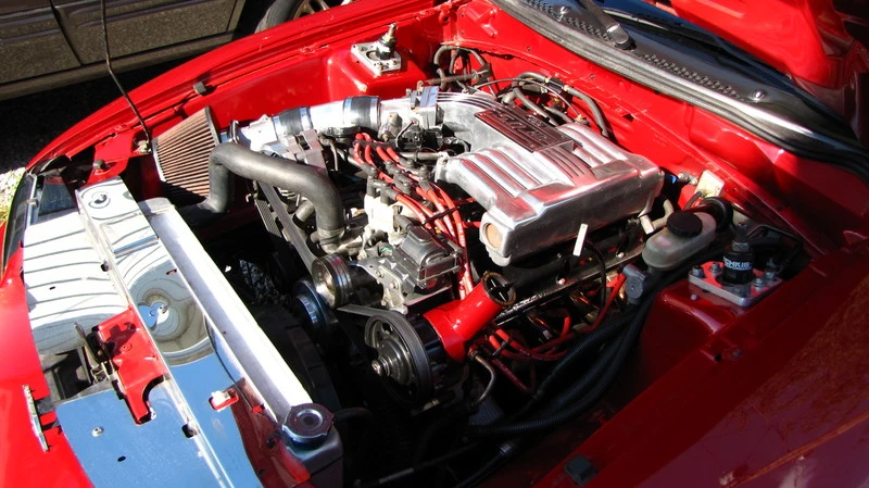

And the engine bay. I'm not happy with the intake setup, but it'll work for now.
