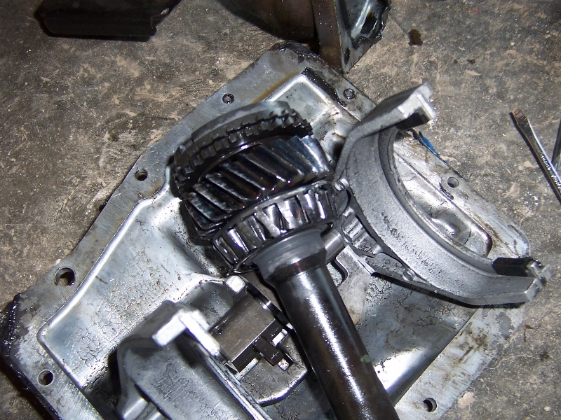

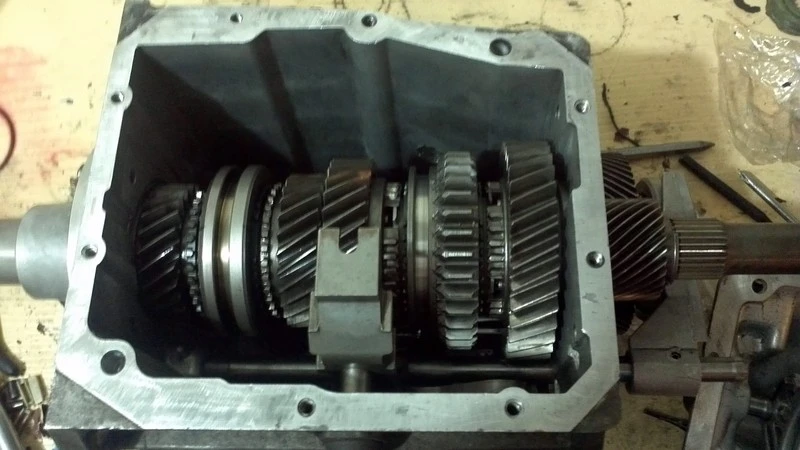

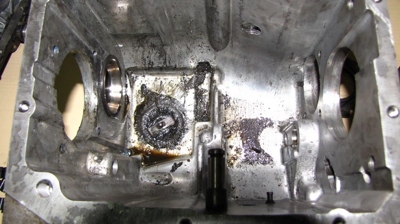

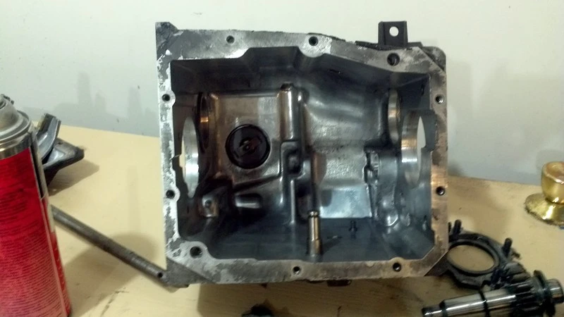

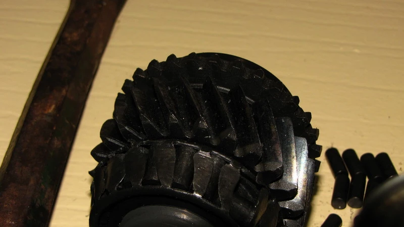

Back on topic, I'll be tearing apart my old T5 tonight then ordering the parts that need replacing. I think I'll need to replace the input shaft at least, the gear looks kinda rough.

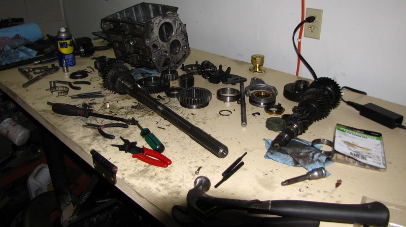

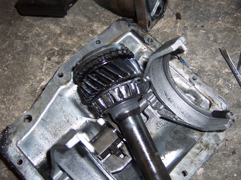

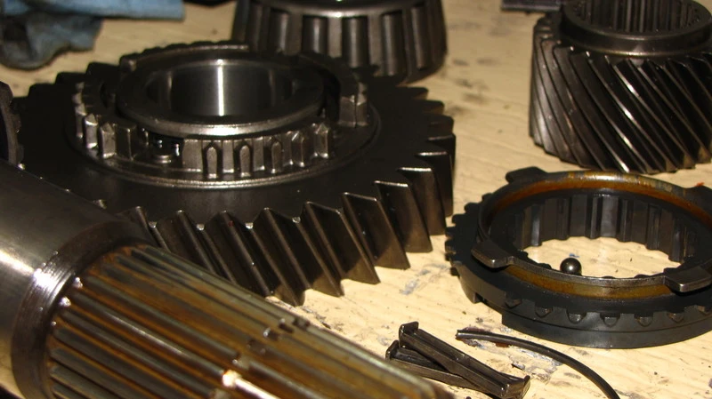

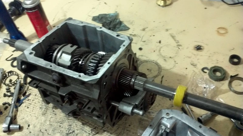

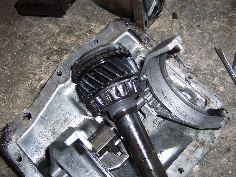

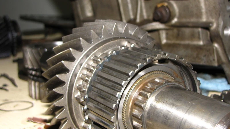

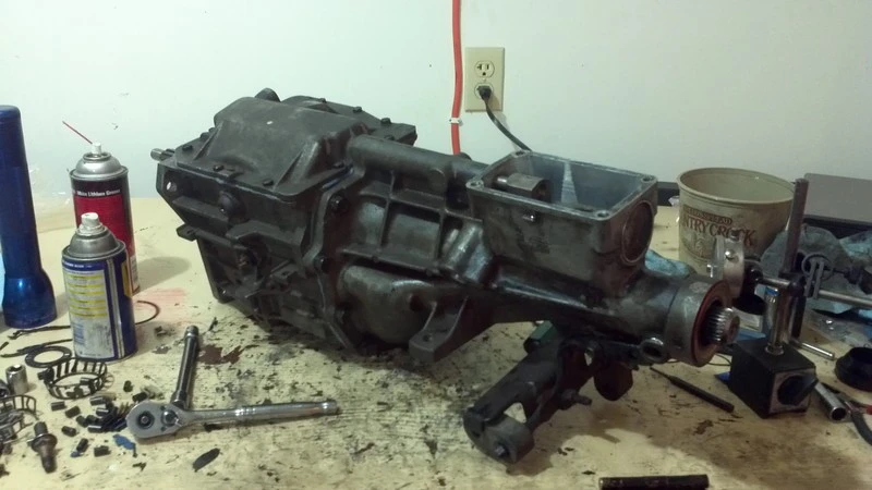

Got the transmission almost completely apart. My snap ring pliers I bought for this job couldn't handle the snap ring so 3rd gear is still installed. Everything looks good other than the input shaft/4th gear. Even the syncros are in good shape. The counter shaft made some noise that I didn't like when spinning so I removed it and I'm going to replace all the bearings. Ordering the parts tonight and hopefully I'll have it back together in a week or two.
Nasty!

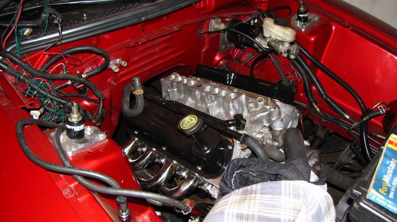

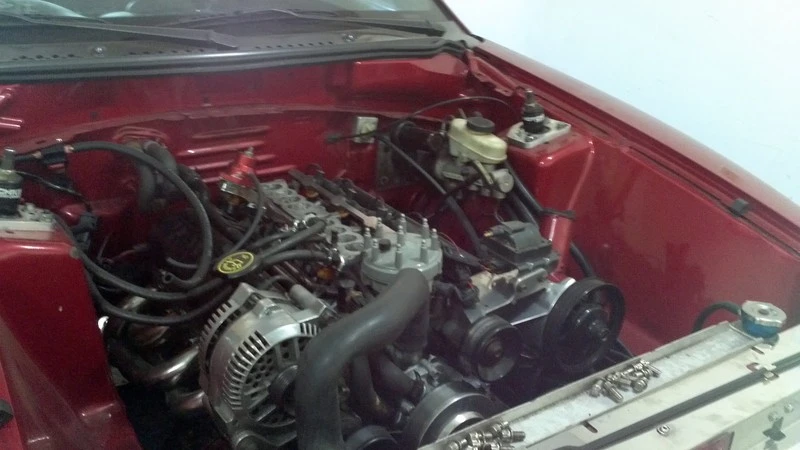

And here's a slightly better shot of the engine. It's leaning way back because of no transmission, and I think my engine mounts are getting wore out.

Looks like some of those gears are really blued. Coming along nicely. Slap a blower on there and have fun again. You'll have the driveability of a stock motor and an extra 100HP when you want. An 03 Cobra is a nice ride, Rog had a sonic blue one. I really liked that one. I know I regret selling my 94 daily. Will never find one in the shape I kept mine. Hell you're running out of time with an 03 in really good shape (8+ years old already).

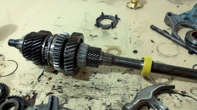

Made a little progress over the weekend. My rebuild kit showed up today so I hope to have the T5 back together tonight or tomorrow. My goal is to have it running this weekend.
The rebuild kit didn't come with new spring clips, which I lost one of, so I had to order a new set. Arrr. Hopefully it will be here by friday. I got everything reinstalled on the output shaft up the 3/4 slider. After closer inspection I found the front of the output shaft is blued and has a few rough spots. It's not real bad, and a new output shaft is $300 so I'm going to re use it.

Went good for the most part. End play looks good on the countershaft and output shaft. One of the bolts for the throwout bearing retainer stripped... I put some loctite on it and tightened it down til it felt like it was going to start turning through, I'm hoping that will hold it. It still has 3 good bolts in it too so I think it will be fine.
I also changed the speedo gear on the output shaft so now my speedo will be right with 3.73's. Woo! :)

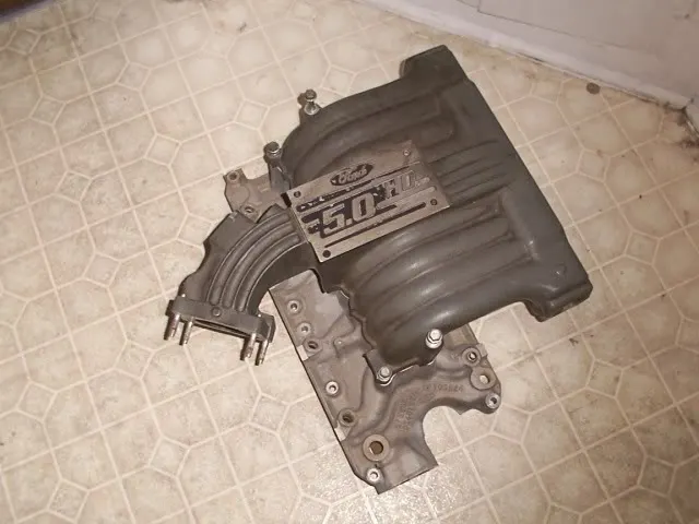

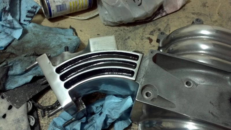

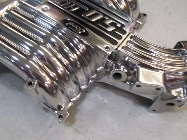

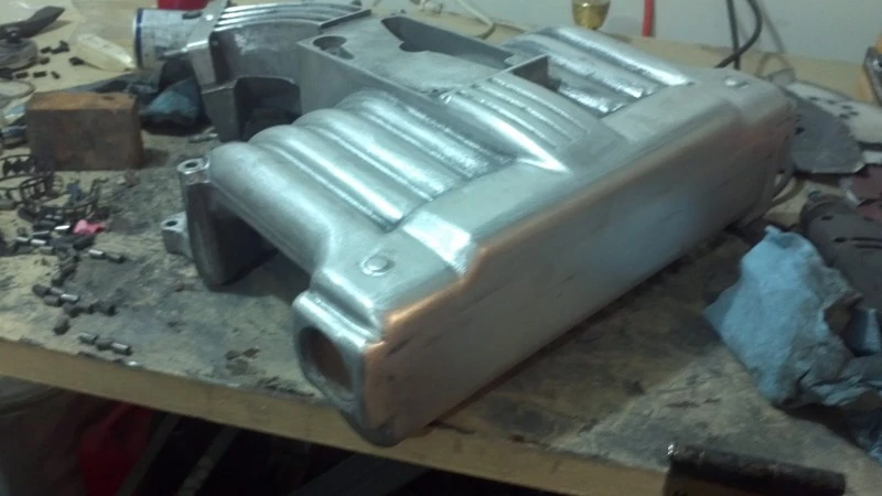

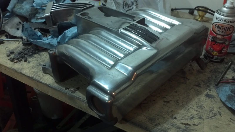

I think I have the wiring done and I finished the exhaust last night. I'm working on polishing the upper intake and once that's done and installed it should be ready to start.

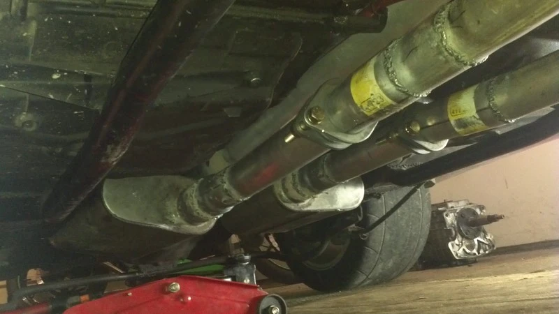

When I first got my car, the stock exhaust rusted out and broke where the h-pipe and mufflers meet. I took it to a local exhaust shop and he made a custom h-pipe and welded it direct to the mufflers. Obviously it's impossible to remove without cutting, so that's what I did. To save a little money I reused that h-pipe and welded ball socket connectors to it. I also bought some flow tubes and installed them since my cat back was pieced together. I now have a proper exhaust system under the car.
I remember how much polishing sucks now.
Just about finished

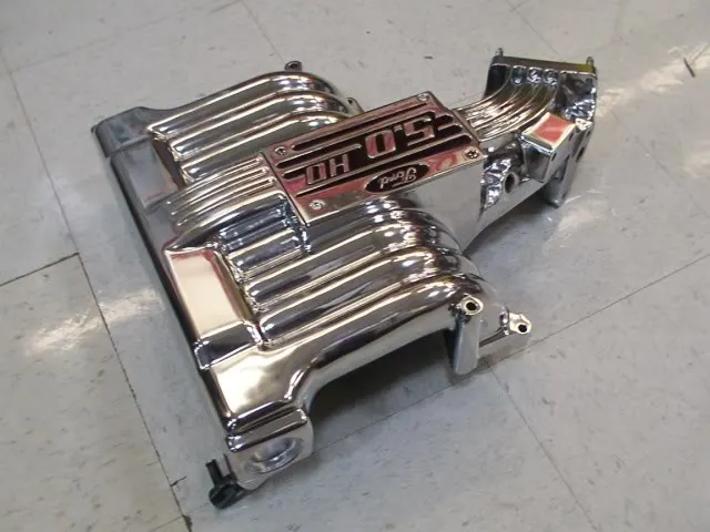

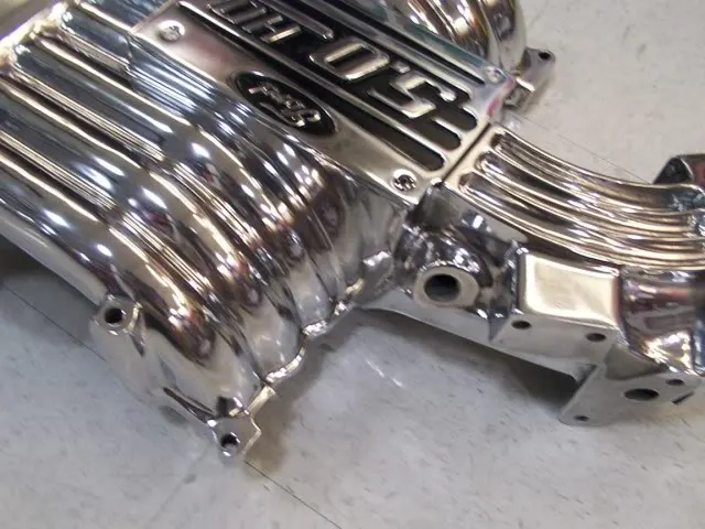

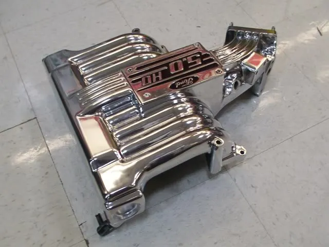

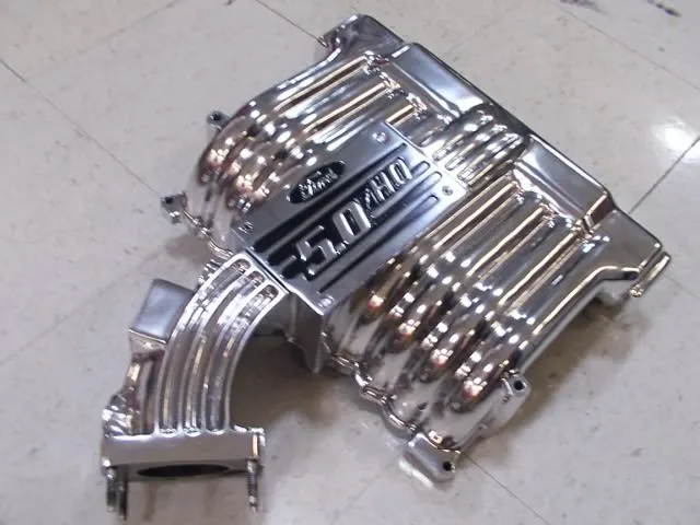

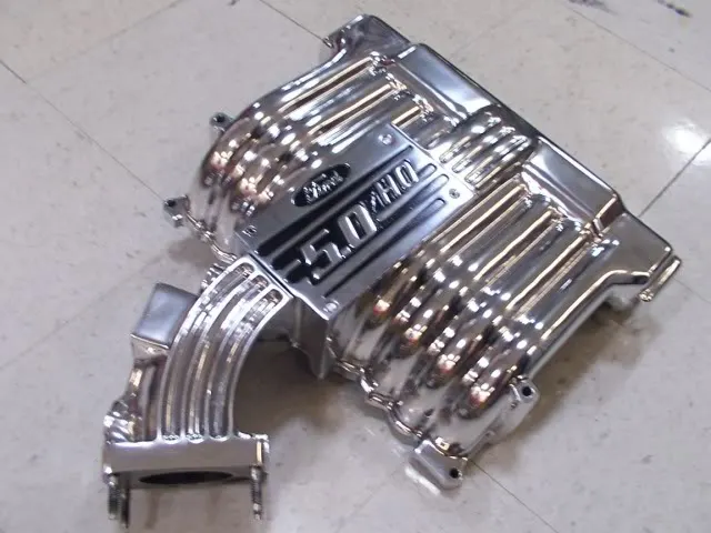

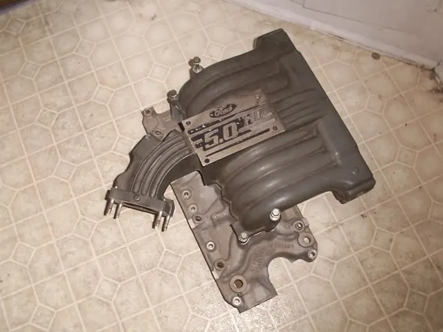

I hear ya man, I do it for a living every day. Just for inspiration, here's one I did years ago, unfortunately it only sold for a little over 100 bucks on Ebay which was a let down since it took 2 full days to complete!
Before:
After:

It's not nearly as smooth as that one, but I'm tired of sanding! I'm going to sand off the black paint and re-polish that area tomorrow, then I'm done with it. The lighting sucks in the pics, but you can see some reflections in the intake.

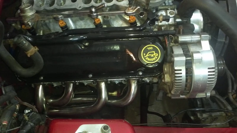

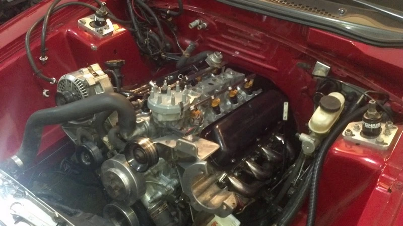

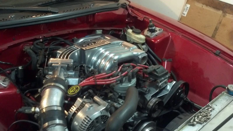

And here's a pic. I'll get some better pics once it's cleaned up.
