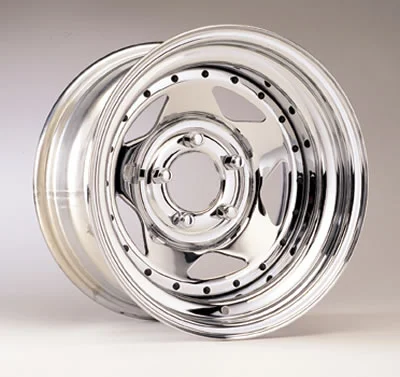

Im buying wheels that come with either a 3.25" backspace or a 4.5" backspace. there is a backorder on the 4.5". will either work? also. i have 15x7 10spokes right now, and i do not have the stock tires, i cant remember the #, whats the widest wheel i can run on them? they have about 8.5" of tread on the road. 8"?
thanks
-Mike

a 4.5" backspacing is too shallow for anything other than maybe a 7" wide wheel. Most 8" wide Mustang wheels use a 5.72" backspacing on an 8" wheel. The wheel in that picture looks like it's got way too much negative offset to fit a fox body properly.
