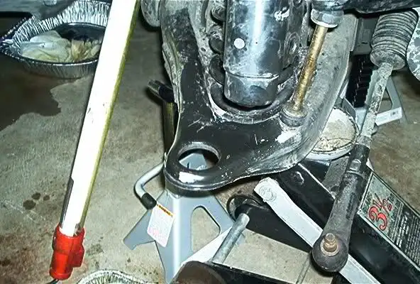

No, just rent yourself a balljoint press from autozone and remove them and press in the new ones. Be sure to put a good amount of grease on the new ones to allow for an easier fit. When you replace them, get some with zerk fittings. I believe I used Moog w/ zerks.

The tool I have pictured removes the balljoint and also presses them into the control arm. All you do is flip it over so the threaded portion is above the control arm and it presses the old ball joints out of the a-arm. What tool are you refering to?
