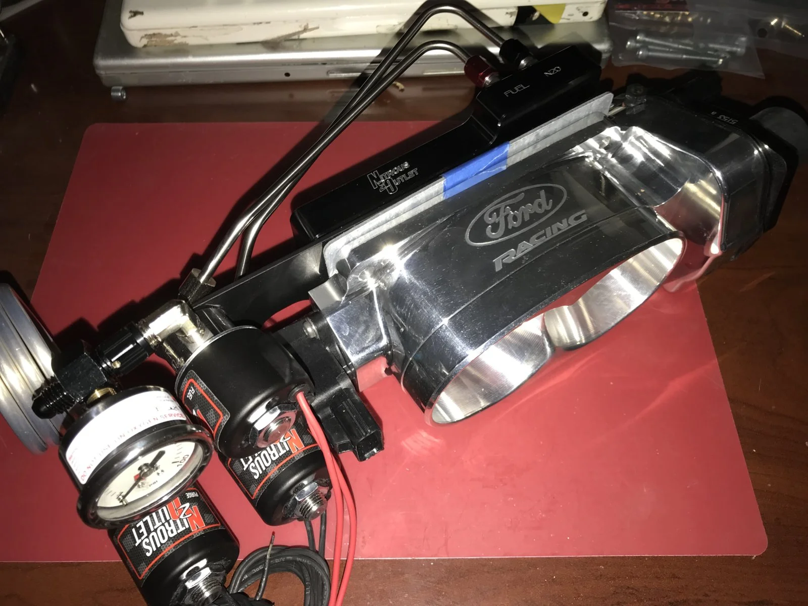

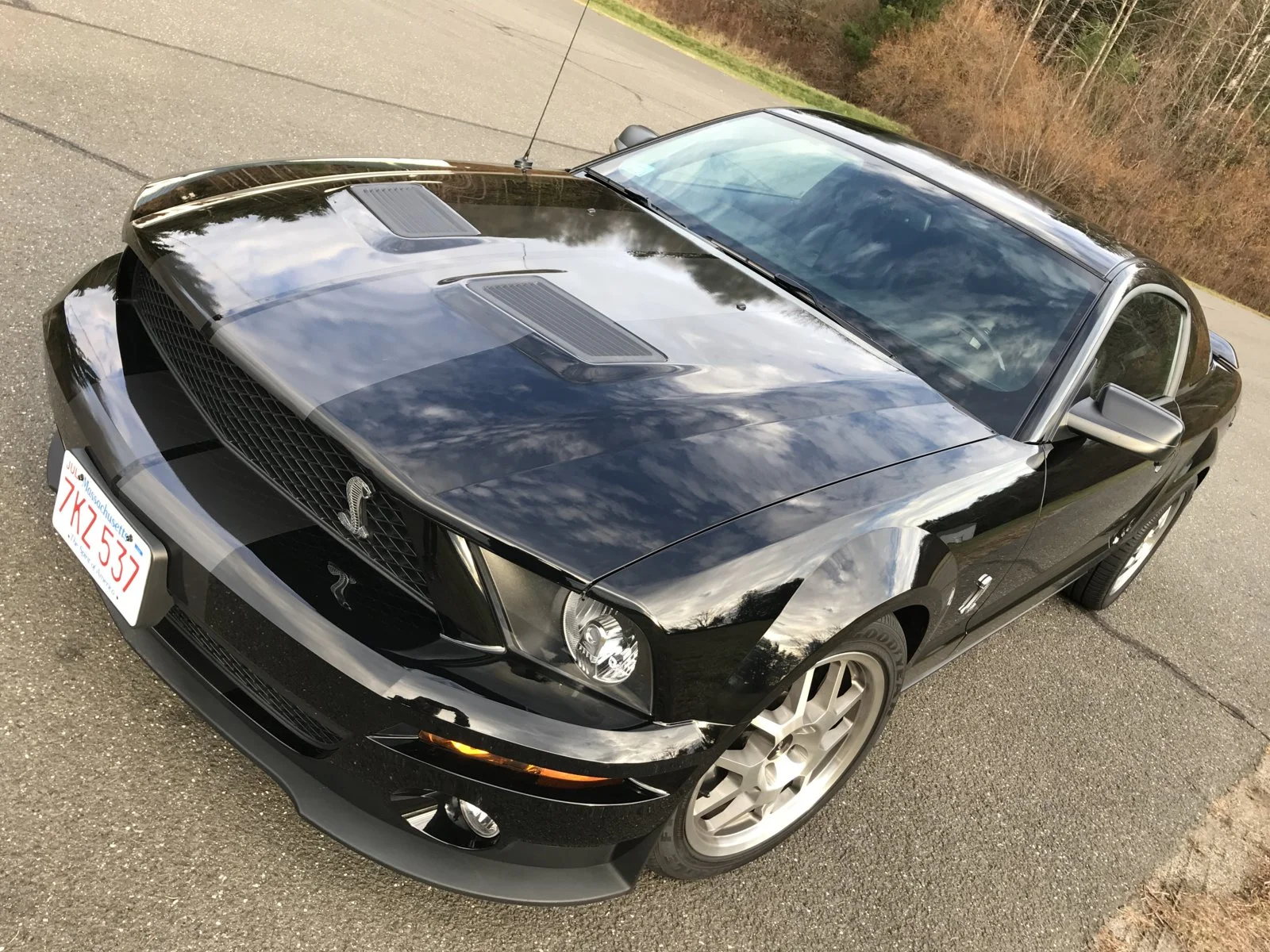

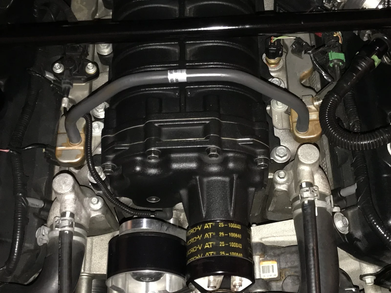

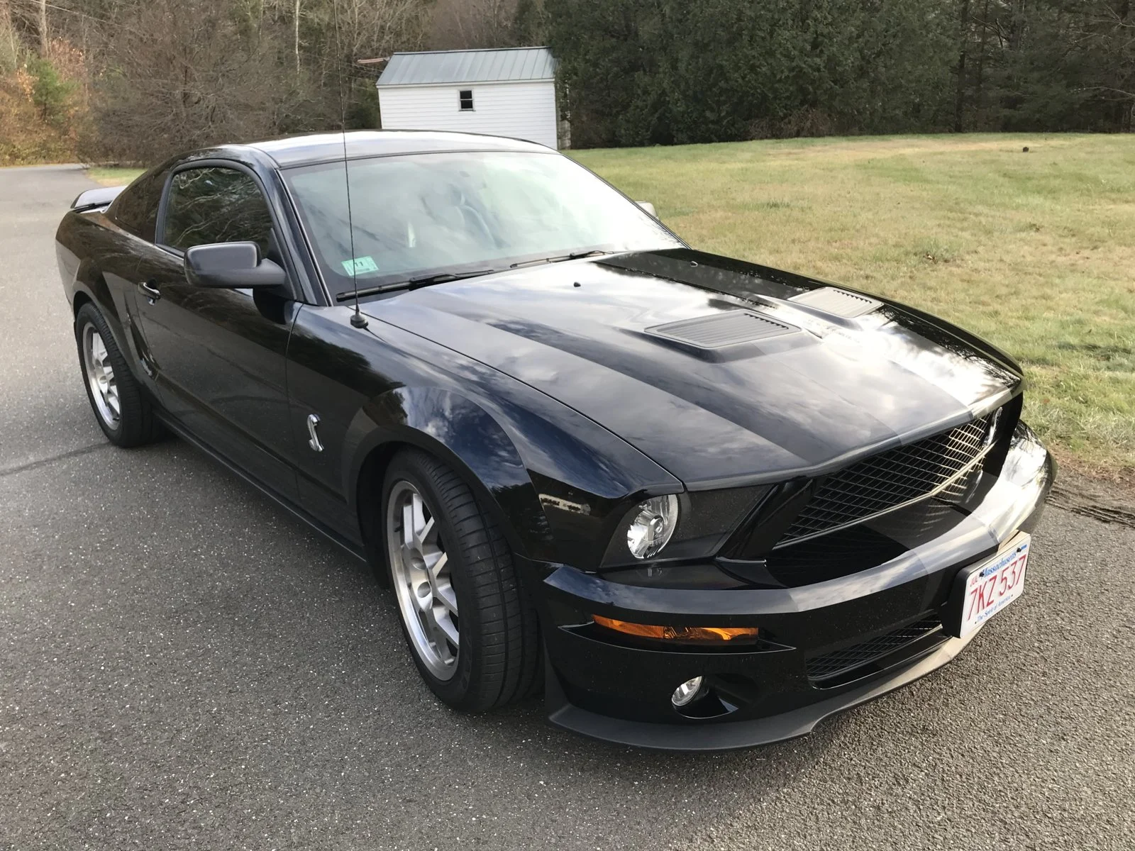

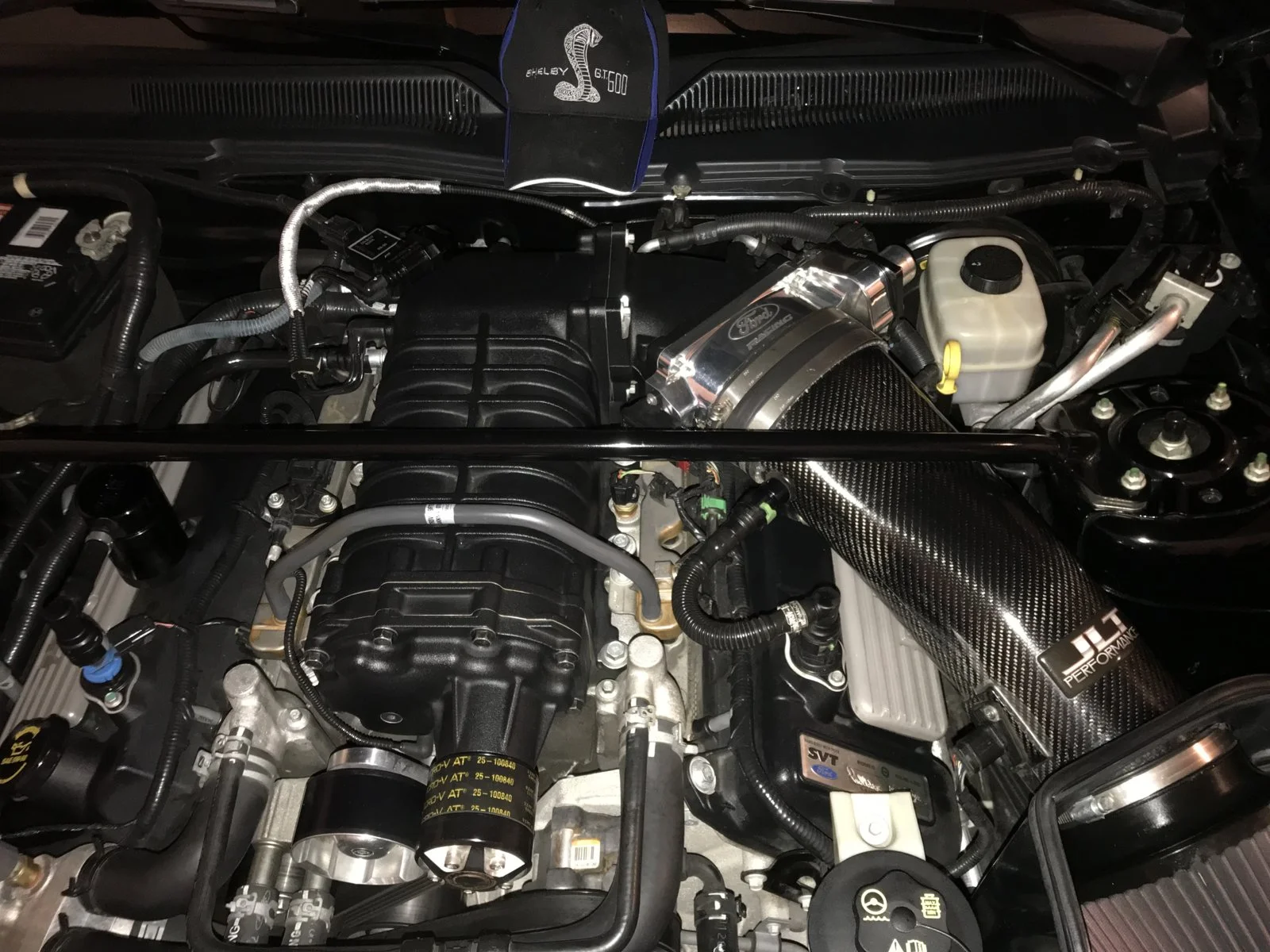

(5) Pics of one Pony- Grocery Getter GT500, the Mill, and the Nitrous Express 50-250HP (Supports 400 HP) Hardline NOS System; pre-Install. Dropped 3” Rear, 2” Front. Stiffer w/Better Wt. Xfer. Nose heaviness bias much improved as well. Best! John
