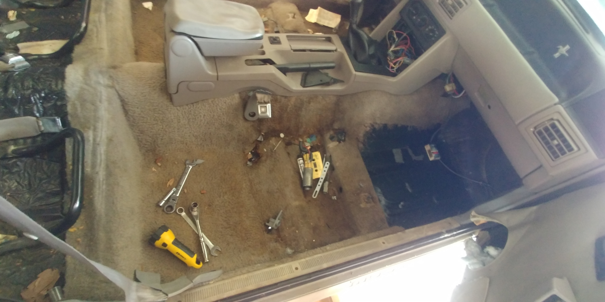

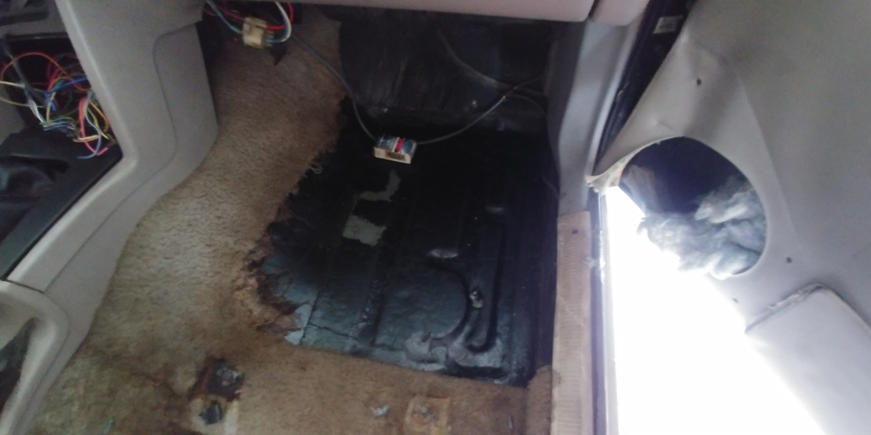

I spent a good part of the afternoon in the garage but damn this FL heat can wipe you out. I did get the hatch support struts installed so no more custom broomstick support now. I also started disassembling the interior. My plan is to take everything out and either repair, repaint or replace the pieces. I'm ordering the duel cup holder center console and arm rest from LMR to replace mine with the broken ashtray. I got the seats out and will spend some time cleaning them tomorrow. I had hope that I could get away with a good cleaning of the carpet but so much for that, a previous owner cut out the carpet in the passenger foot well for some reason. No worries thought, I had budgeted for new carpet anyway.
Seats are out. Got to love the things you find when you start pulling stuff out like this. I found 2 cassette tapes (Spanish music), a couple of screwdrivers, channel locks, kid toy parts in the back, and an assortment of loose change. :D
So much for cleaning and re-using the carpet. :p

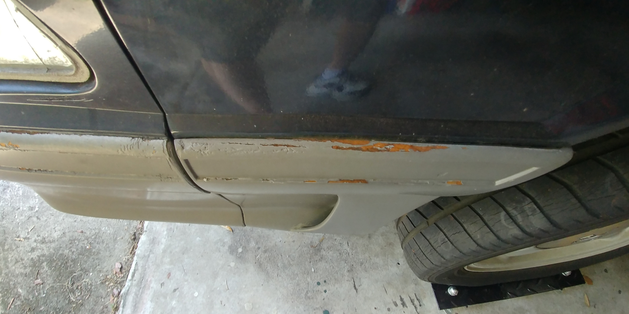

Now out to a few questions, First there is pitting on the trim pieces all around the exterior. Can this be sanded down and smoothed out or am I better off looking for new trim/ground effects.

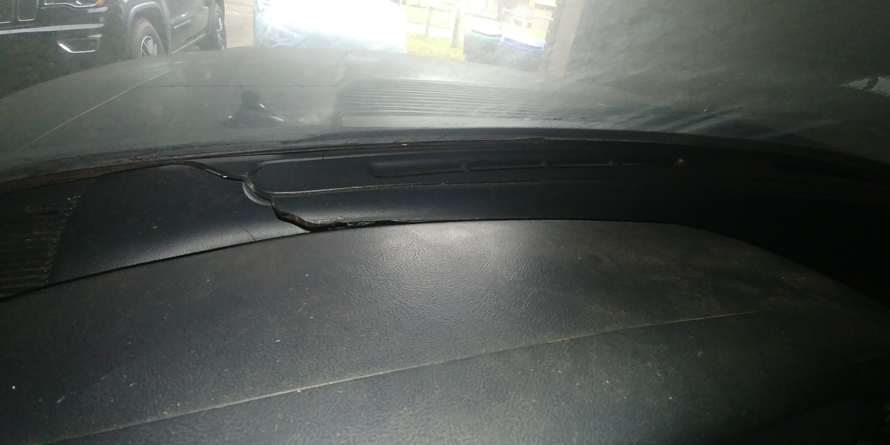

Second question, Does anyone know of an online source for a new dash.? Mine is cracked in several places. I will be heading to a few salvage yards later next week but figured it was worth asking if anyone knew of a reproduction one.

My 89 has the same pitting trim where the paint has flaked off. I am going to try and refinish the original pieces on my car. Some are in better shape than others. I picked up some Evercoat polyester flexible glazing putty to fill in the rough spots but I have not tried it yet.

Thanks @LX1993 and @TIGGER for the replies. As far as the dashboard goes, it's off to the salvage yard for starters (unless karthief has one hidden in his pile-o-parts LOL ). I may try to play with the trim pieces and see if I can clean them up but if not, I'll get new ones. Paint./Body work is a long way off for now. Right now the plan is to to get it running first so I can move it in and out the garage under its own power.

You can get parts for the dash, but not the entire thing just yet. You still need the core frame material of the dash used. You can clean it up, scuff it up and paint it.
From there you can track down the HVAC registers, the speaker grills and the dash pad.
I've found SEM Landeau black to be a very good color for restoring the black trim pieces in the interior
No one repop's the dash yet. Ebay, face book or salvage yard. Easier to just replace the exterior trim. It's all available & reasonable.
This is going to depend a little bit. I don't know what the quality of the reproduction pieces are, but used it's a bit of a crap shoot on whether or not you will get something in decent shape. Those bumper extensions and the GT ground effects in general have often been ravaged by weather and time as far as used pieces are concerned.
Looking further at the pictures, the damage is also on the bumper cover itself, so that part would need to be repaired or the bumper cover replaced. The last time I bought a YCC reproduction for my Mustang project was 10 years ago, so I don't know what the cost (or availability) of those are anymore. The ones from LMR were pricey and again availability of a lot of these things are questionable as well as the quality.
To the OP - I think those are absolutely repairable. I probably would put some plastic filler in and THEN sand it down or you may take off too much material and change the shape too much.
