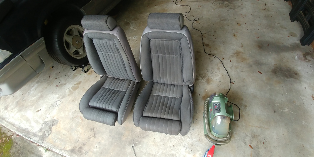

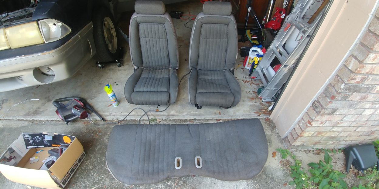

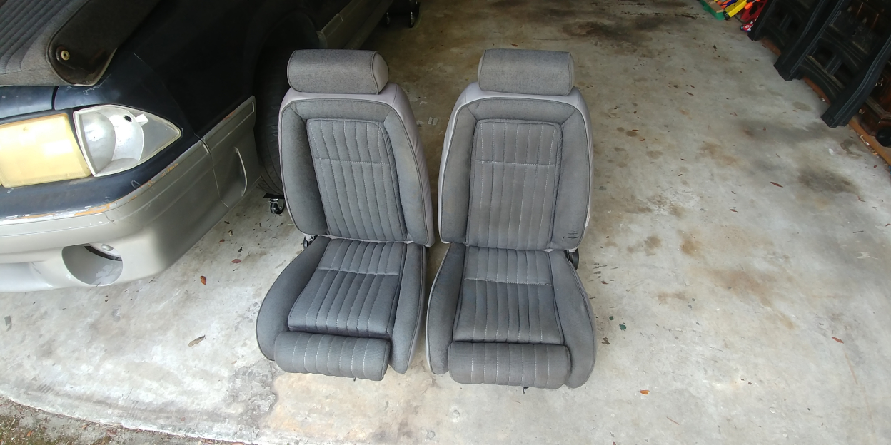

I was able to get some cleaning done on the upholstery though. I know it will have to be replaced eventually but at least I can make it look better in the mean time.
Seats prior to cleaning (by hand)
Prior to the first past with the Bissell
After 2 passes with the cleaner

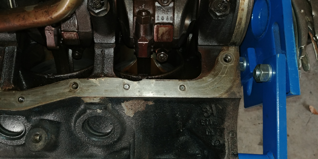

It's been a while since I've had time to do anything to this project. I figured since the weather was nice, I'd replace the oil pump and install a new oil pan gasket. Well Mr. Murphy decided to pay me a visit and remind me that his law will always triumph over my good intentions. I snapped two oil pan bolts into the block and of course they are damn near flush with the block so I can't get a pair of vise-grips on them :mad:. Time to go visit the tool store and get a set of extractors. Hopefully I'll be able to get these out. Here's a picture to enjoy with your morning beverage of choice:

Well no joy trying to get them out with the extractors. At this point I decided to just button it up with the new Fel-Pro gasket in place and tighten everything down. I did pick up a set of the oil pan reinforcement rails a while back so I'm hoping that that will distribute the torque evenly enough to prevent any leaks. I may revisit this issue before it goes back into the car if I can come up with any other ideas. This did prompt the wife to mention that maybe I should start looking into possibly of picking up a new block and building it out to be a permanent replacement for this one ;) . I said I would start looking but I'm still trying maintain a budget for this build but the kid in me is like "Oh hell yeah!!!".

Oh I over-tightened the crap out of them on the first try, so this one is all on me. It was "crank, crank, crank, PING, OH CRAP!!!". The bad thing is I didn't notice the second one had broke till I started taking it apart again. Not sure what I was thinking (or not thinking in this case). Rookie mistake, albeit a big one.
Try a reverse drill bit, use the blue one piece gasket I think they have the metal insert (?), I use a thin smear of blue rtv on the block and pan surfaces then snug em down, leave overnight and it is good to go, I think they only get about 6-9 pound foot of torque.
Or have someone weld a nut to the studs....
I tried using a reverse drill bit but didn't have any luck with the set I bought from Harbor Freight. I had installed the molded perma-dry Fel-Pro gasket so I hadn't thought about using RTV since the instructions said it could be applied dry.
I had thought about the welding trick but 1.) I don't have a welding setup yet and 2.) The one that broke off at the back of the block is damn near flush with the block so I'm not sure it I'd be able to have a nut tacked on to that one (at least not with my lack of experience in welding). The other one is sticking up about 1/8 of an inch (if that).
But a really good( not H.F.) Drill bit set smaller then the Oil pan bolts.
Use a center punch, and Carefully drill into the bolts.step up in size till you can get a small screwdriver in there and turn what's left out.
