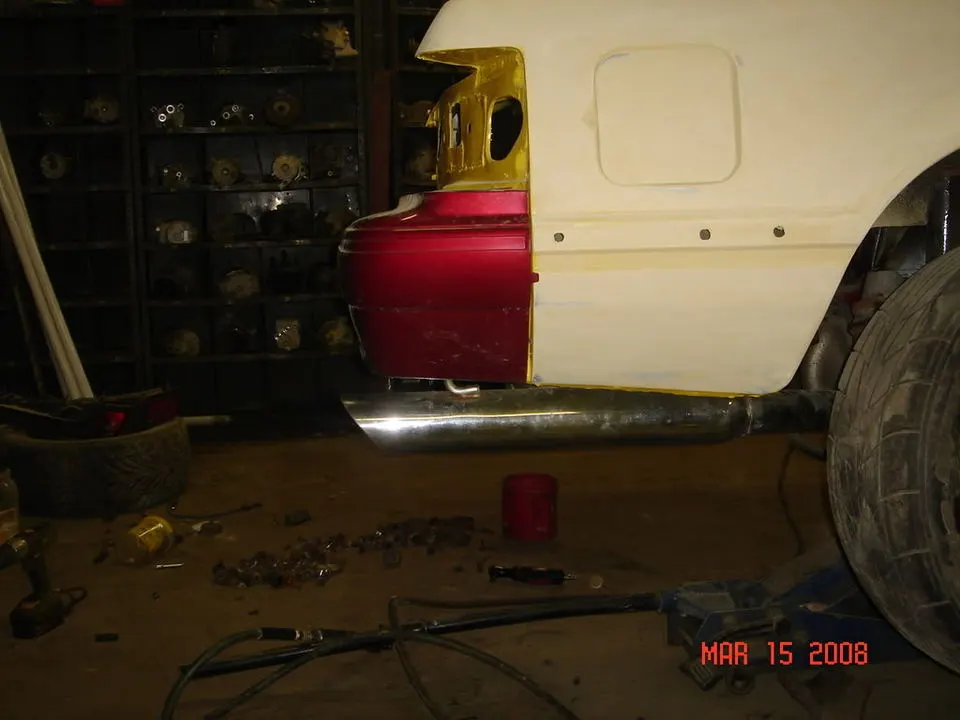

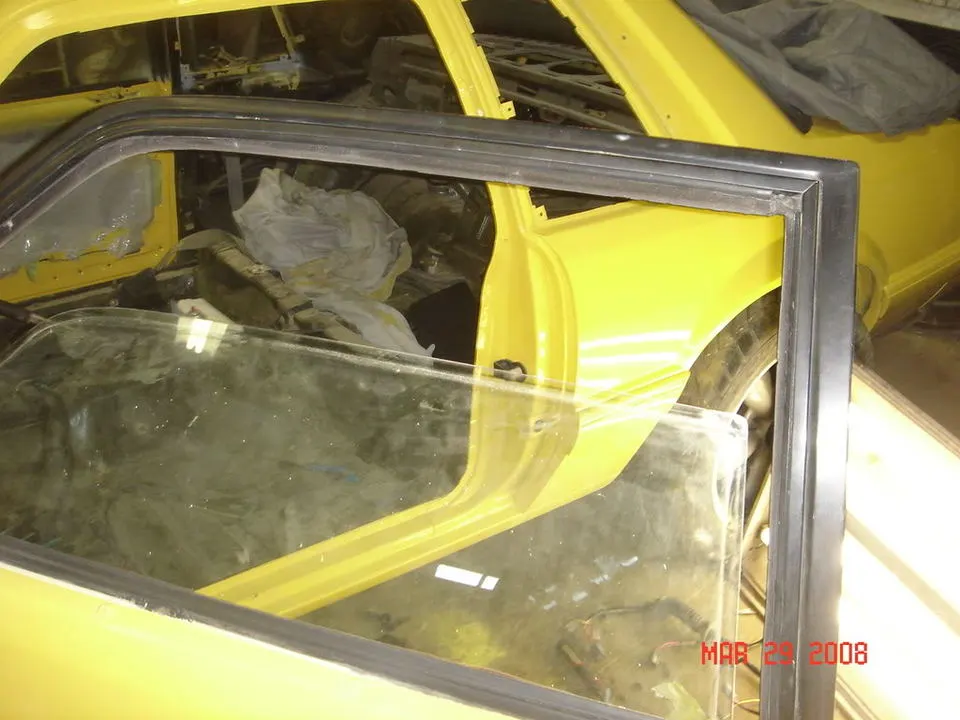

Here is the underside of my car. I have a bad inside pic too. I also have a pic of the rear quarter areas outside....look in the trunk in this areas section.
