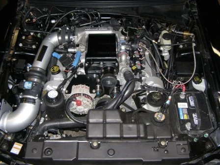

i have a 1.7. and the jlt, its tight but it does fit

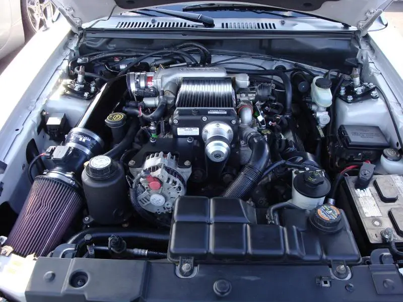

Is there a specific demolet you ordered? I haven't been to their site in a long time...Do you have a pic of your setup that I could see?

It is the tunable induction fenderwell cai for a KB. picture not great but what I have now
gets a little bigger if you click on it, KB is very clear on the fact that they do not recomend the underhood intakes
Have you had any issues with your Demolet? That pic looks sweet. I am leaning towards your setup actually (the Demolet, 75mm TB, and the 90MM)
What kind of power are you putting down to the wheels?
I have no issues with the demolet,I see no quality issues. the jlt is 4" all the to tb,which I see no benefit with the 75mm tb and it creates a fitment issue with the shock tower and oil fill(on mine anyway)
