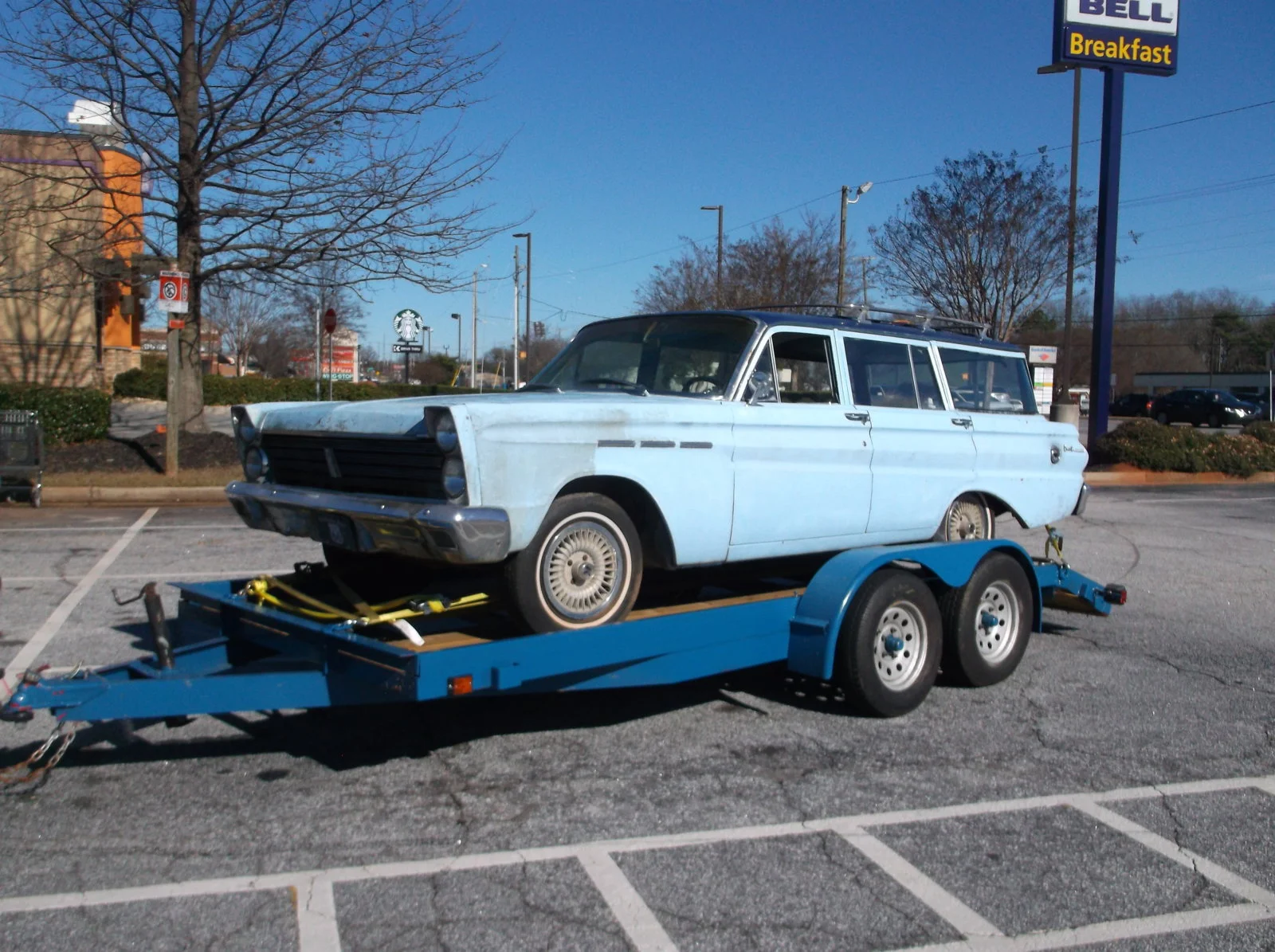

Would like to see a pic of proffered Comet, I got a soft part in my heart for them.

I am gathering parts for the Comet. I have my engine parts back from getting balanced. I have located a 57 Ford wagon rear end housing.
My input shaft for my top loader is at Liberty getting upgraded. I found some 5 lug hubs and spindles.

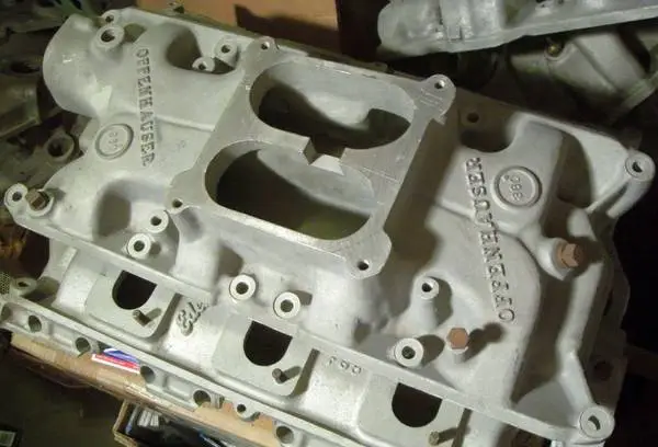

Out of curiosity, will the class allow an Offy 360? It's a split single plane. I had one on my 302 to begin with before swapping to the Air Gap knock off that I have on the car now. I can attest to it pulling to 7k rpms as I bounced the rev limiter with it once before dialing it down to 6000 - 6500 rpms. I still have it if you can use it, definitely cheaper than Summit, they're asking $400+.

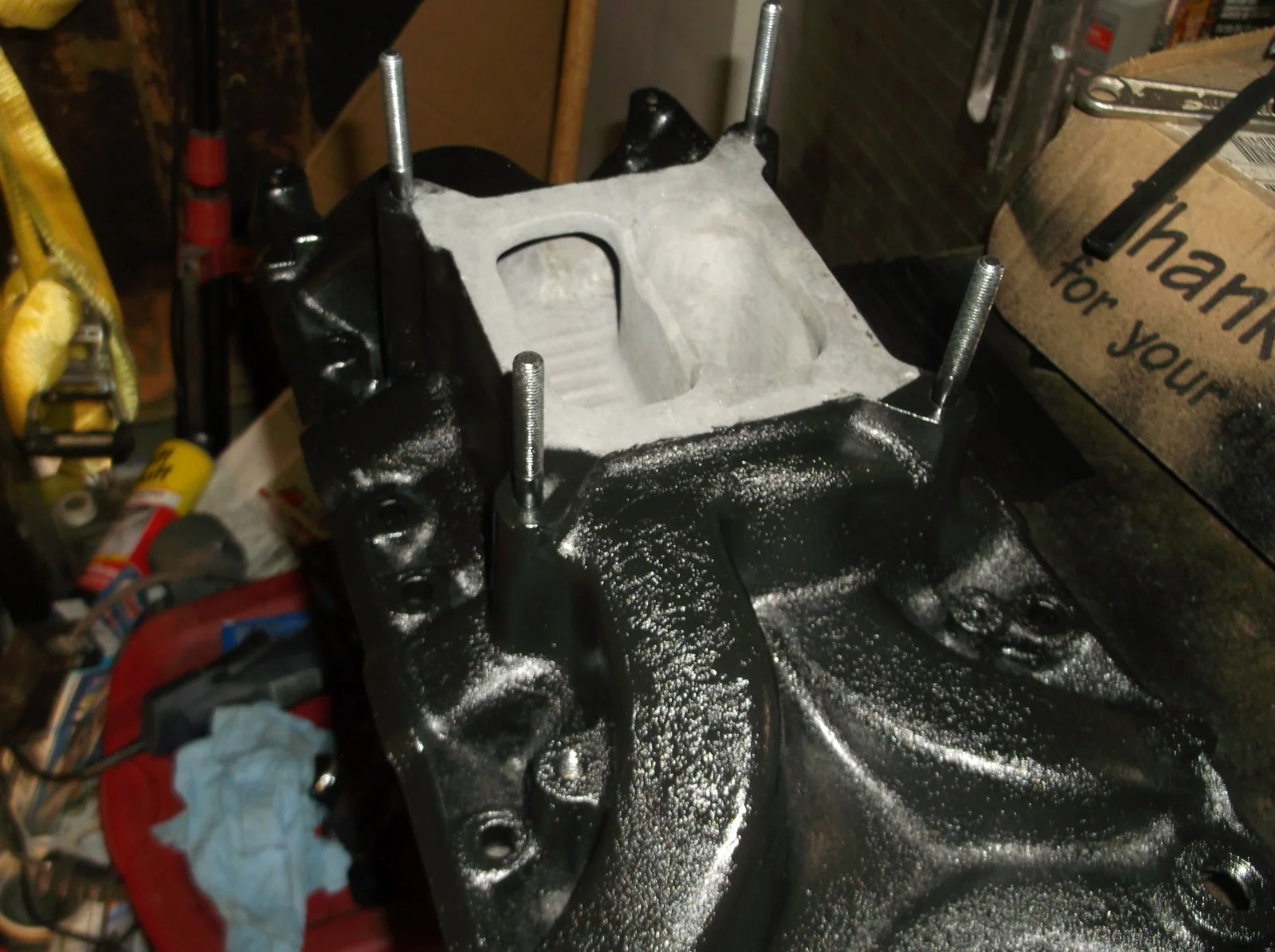

I have traded for a Performer RPM intake and in the middle of porting it to match the ProMaxx heads. I am trying to get up in as far as possible to reach the lumps and bumps in the ports.
I am up in the air about cutting the center divider out. I am allowed to run a 1 inch spacer. I have read articles about cutting out part of the divider. I have even read and article about cutting the whole plenum out and trying to make it as close to a single plane as possible .
The rules read porting is allowed as long as there is nothing showing from the outside. So I can cut holes in the bottom of the intake and port it out and weld the holes back up. Basically everything but cut it in half and weld it back together.
Reactions: 2Blue2
Acid porting is a procedure that has been used for years to hide grinding marks after porting cast iron heads or exhaust and intake manifolds on round track race cars.
It's called undercover porting in that type of racing. In my case their is no rule against it and on aluminum it's a very effective way to open up the ports on a dual plane intake as muriatic acid is applied to the areas you can't get to with a grinding bur.
Just be careful as it will eat the manifold. After reaching the desired size of the ports then spray water to neutralize the acid. If you do any grinding on aluminum and don't lubricate the grinding bur it clogs up with aluminum. then to clean the bur you let it soak in some acid and the aluminum will start foaming up and the bur will be clean. The aluminum will be gone.
you can buy the muriatic acid in gallons at most any hardware store. Just be careful and use it in a well vented area and wear rubber gloves and a face shield.
