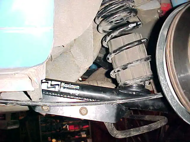

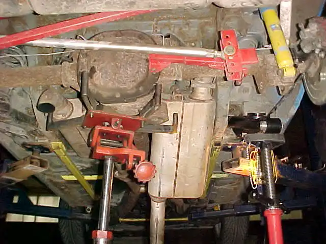

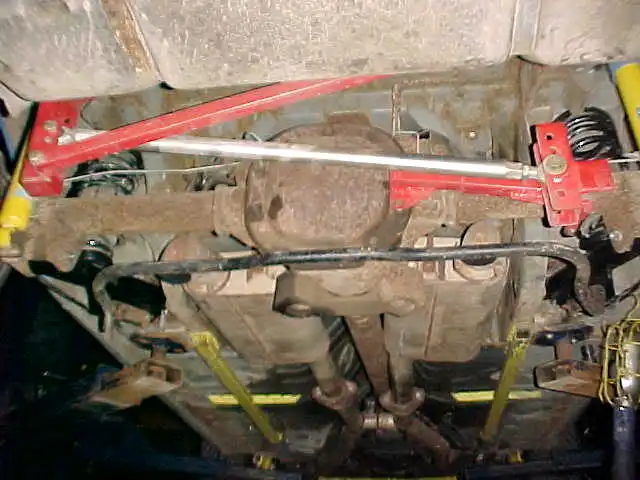

Forgive me, my digital camera sucks balls, but this is what I have. MM lower control arms (the best IMO), Griggs Panhard bar, Bilsteins, Eibach springs, boxed front control arms with poly bushings. My car handles like not a mustang, it that makes sense.
