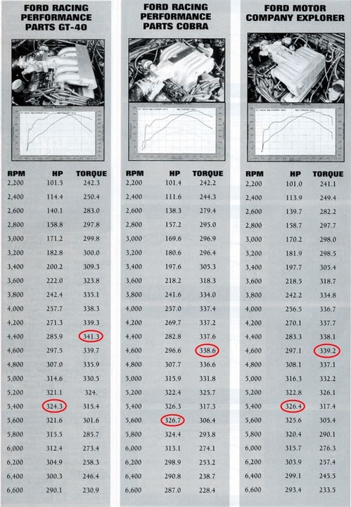

Hey Brian is it true that the GT40 intake on the 96 and early 97 5.0 explorer is the same as the Tubular GT40 you can buy from ford in just a cast version? if thats the case i actually grabbed one off an explorer at a u pullit last week im cleaning it up and getting ready to powder coat it now
They're virtually the same. The lower intakes between the GT40/Cobra and Explorer are identical. The smooth tubular runners of the GT40 upper intake may prove a slight advantage, but they're all within a handful of horsepower of one and other on back to back dyno comparisons.
If I had the choice between a $400 GT40 and a $100 Explorer intake, it would be a no brainer for me...
