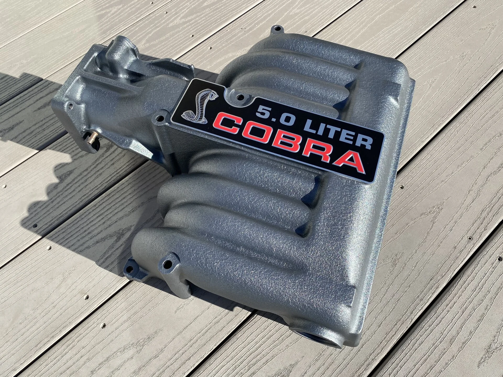

So how in the world do I make my intake look like that? Mine is like dirty tan with greasy finger prints all over it. lol I want mine to look exactly like that!! IMO that's cooler than the tubular one.
7991LXnSHO
wanna catch the space herp
Sep 1, 2010
7,387
2,745
194
Kearney, NE
Aug 7, 2022
#55
  • Aug 7, 2022
  • #55
Zach,
1. Degrease it, 2. carb cleaner it, 3. lacquer thinner until the bounty paper comes off clean, then use the VHT paint of your choice.
Or, take it to the powder coater
Stripped the original paint off, and sent it to a guy to blast and powdercoat it. Cost me $100 for that, plus the new Cobra intake plate. I have the code for the color saves as well
Lower was Tmoss ported. I don't have dyno numbers on my combo (TFS170's, FTI cam) yet.
