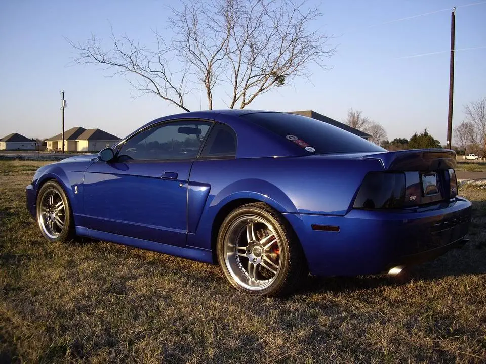

heres mine with 285/35/18 and 265/35/18

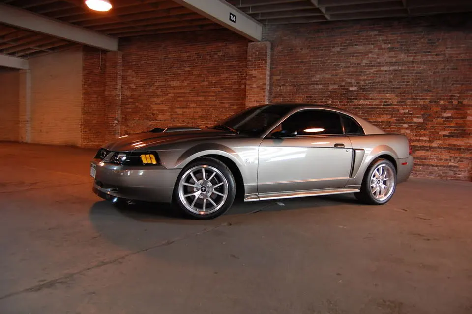

I went the cheaper route in the front and the 295's in the rear. 255/40/18 and 295/35/18. I don't think it looks odd at all and the 255 fit the 9" rim just fine in the front. I've auto-xd it with no problems in the front. 25.7 is the stock tire diameter (245/45/17) and the 255's are 26 overall diameter and 265's are 25.3. Either will work, but the 295's in the rear are 26.1, so I just wanted to try and match them as close as possible in diameter. Here it is:
