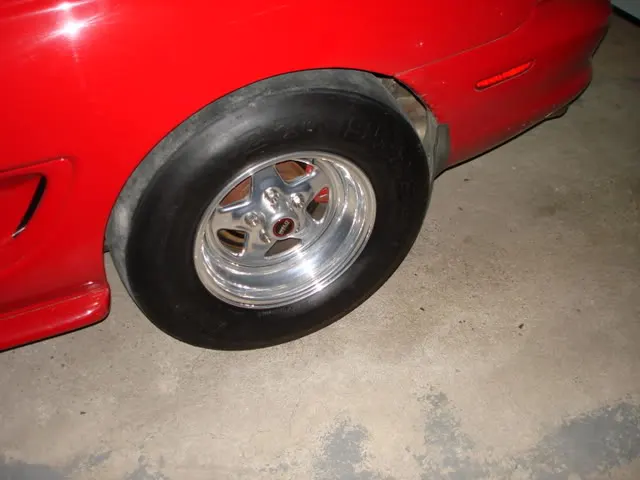

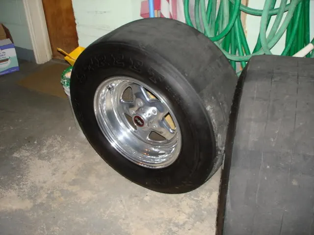

I'm running 28 x 12.5 x 15 on 15 x 10 rims w/ 6.5 b.s. and they fit on my 94 Cobra w/ no issues. I'll be switching to a 28 x 13.5 x 15 over the offseason. Let's hope she fits!:D
Which M/T tire? The M/T ET Street measures different than an M/T ET Drag tire. 28x12.5 ET Street = 28x10.5 ET Drag.
For the record I run 28x10.5 ET Drag no problem, 10" rim with 6.5" bs and 1/4" spacer.

Of course you have to ditch the quad shocks, other than that that bolt right up, and I use no spacer or anything.:shrug:

I would lower it a bit more but due to my suspension setup having it right at that particular ride height has my Instant Center and Pinion Angle exactly where they need to be so thats where I leave it. Those are 28 x 12.5 x 15 ET Streets mounted on 15 x 10's w/ 6.5 b.s.
I'm not sure if the 28 x 13.5's will work or not, i'm going to try them this winter or early next spring. There actually going to be the 325-50-15 MT Drag radials, which is equilivant to a 28 x 13.5.
I also don't reccomend driving w/ ET Streets on a daily driver unless your commute consists of a 2 mile round trip each day and it never rains where your at.
On a 10" Rim with 6.5 bs and no spacer I have ran the 325/50/15 and now the 275/60/15 ET Street Radial with no issues. My fenders were "clearanced" with a BFH years ago though.
