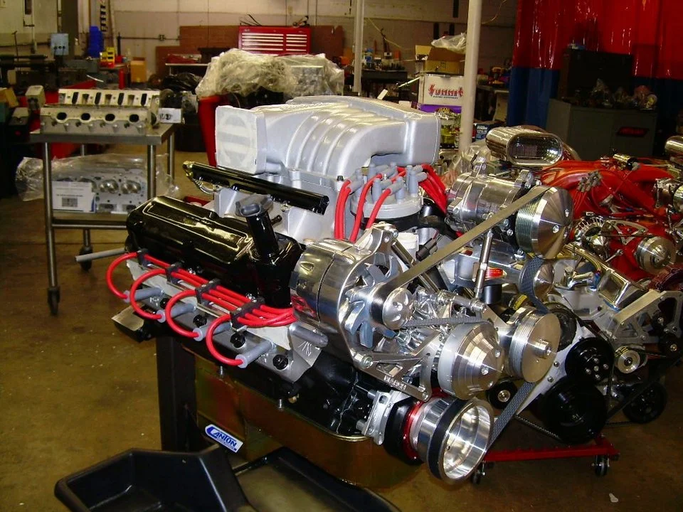

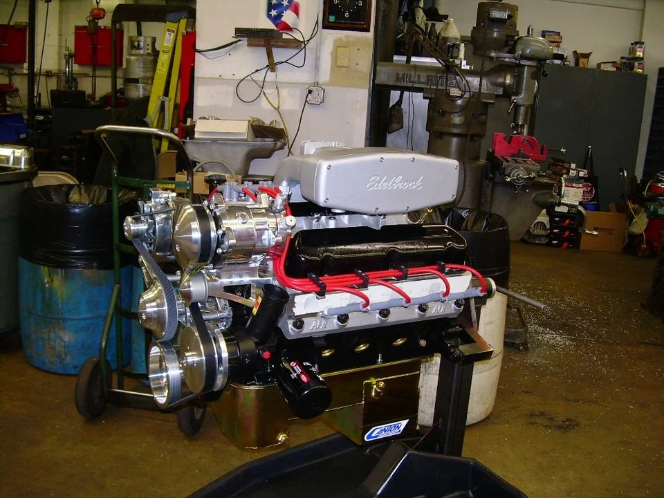

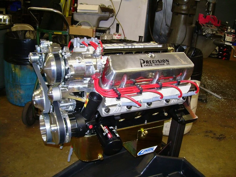

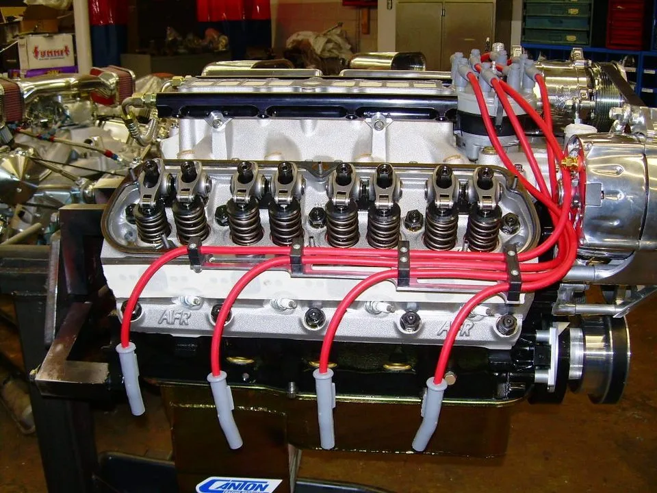

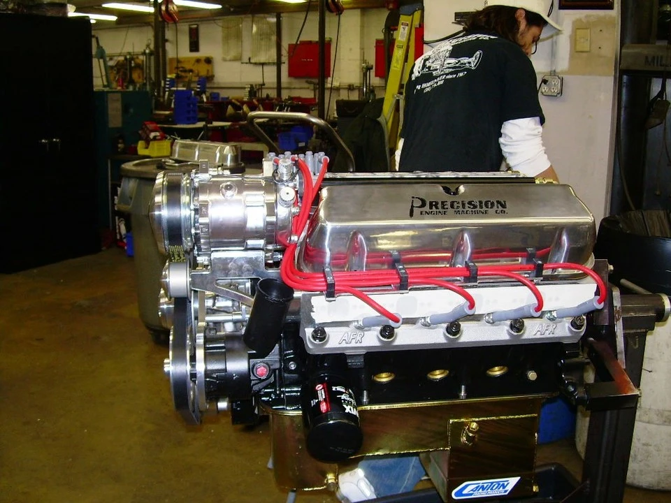

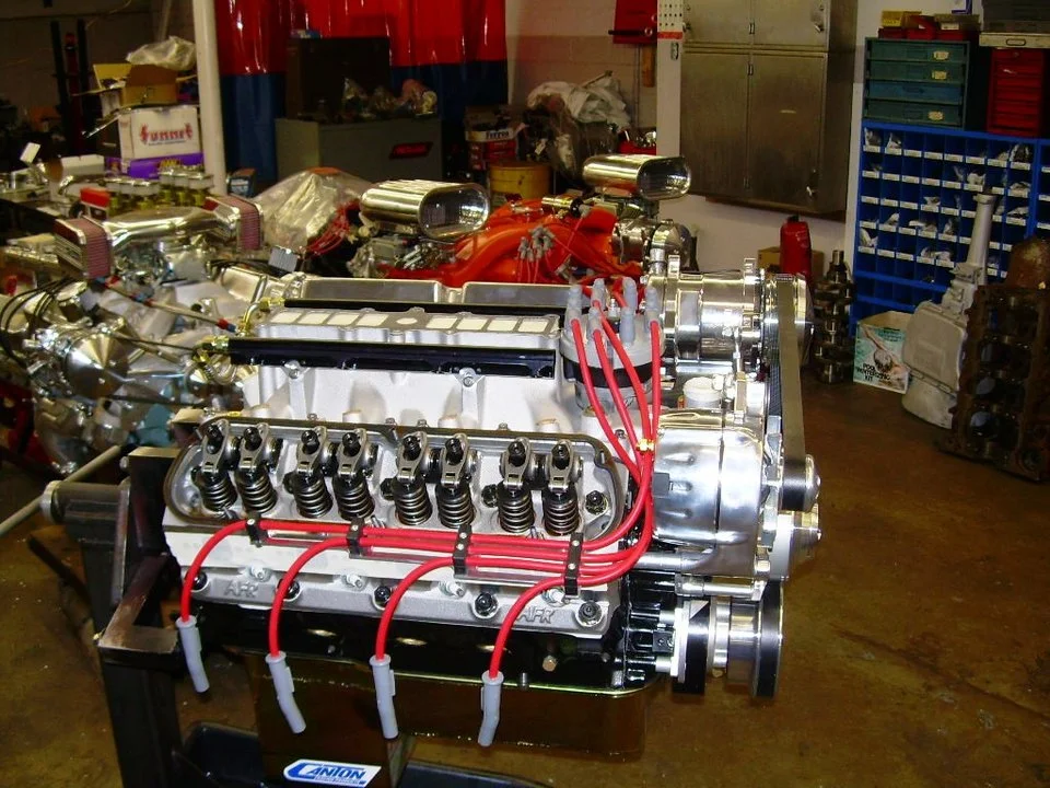

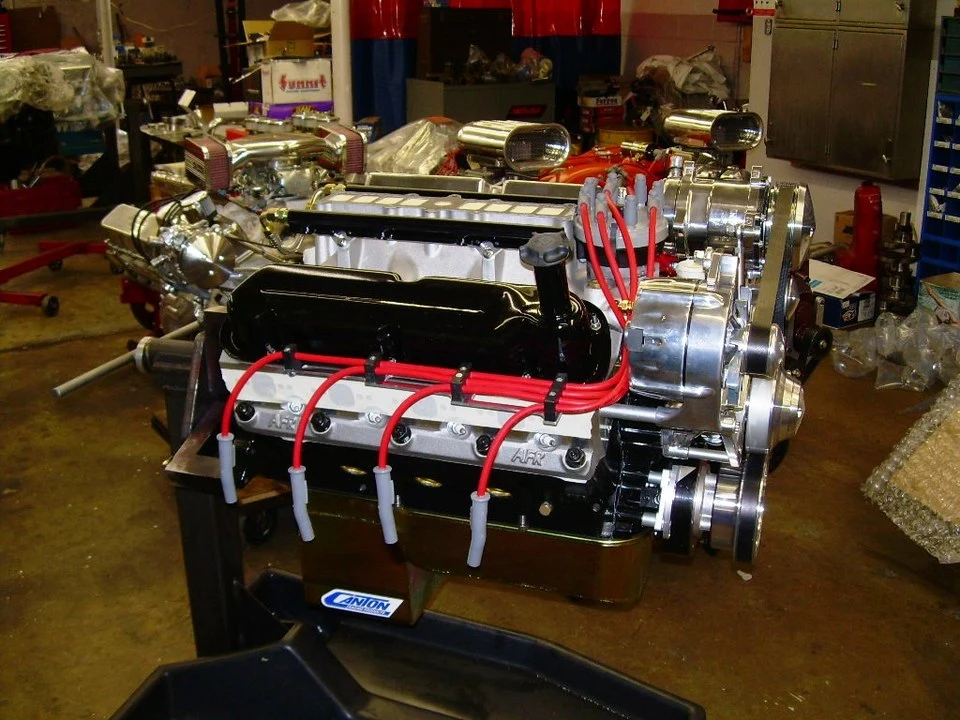

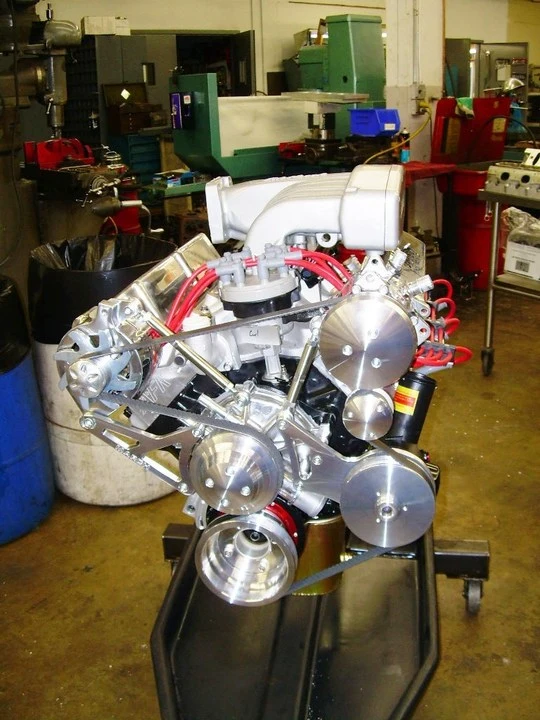

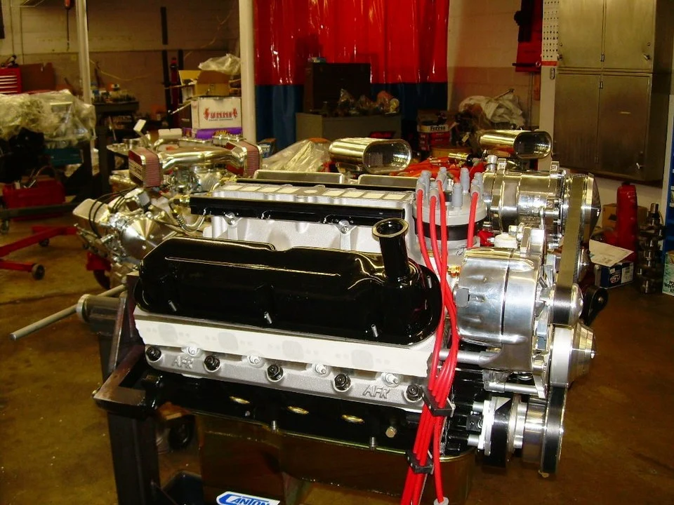

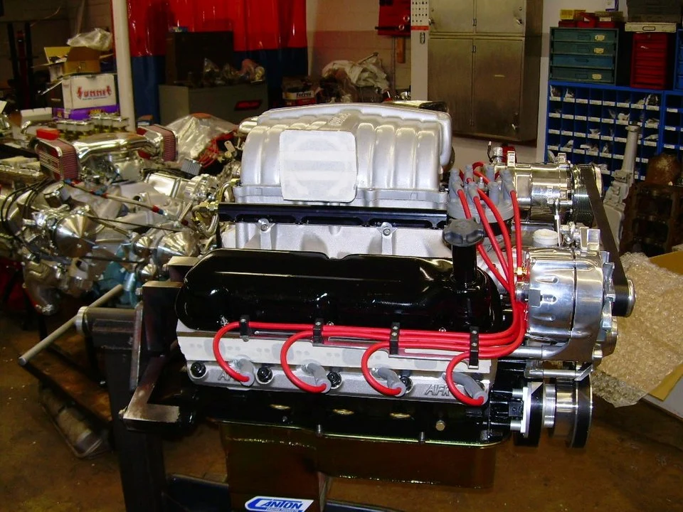

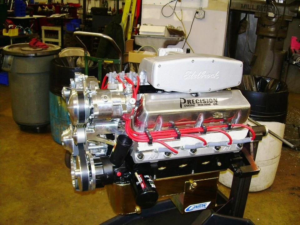

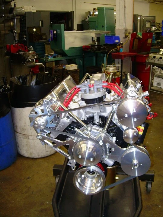

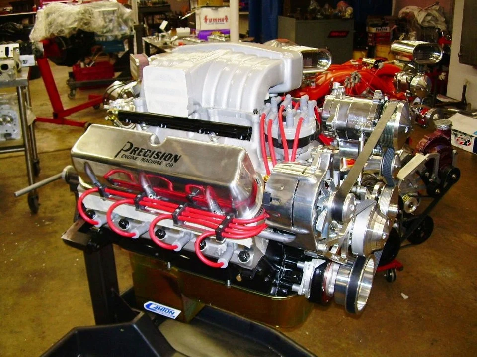

the long block is done!
Therian
The Highlander
Apr 21, 2002
Waterloo, Ontario
Dec 6, 2006
#67
  • Dec 6, 2006
  • #67
that's amazing.
Pokageek
Jun 10, 2005
2,767
46
MA, USA
Dec 6, 2006
#68
  • Dec 6, 2006
  • #68
WOOOOOOOOOOOOOOOOOOOOOOOOW! Keep the precision vc's though.
BlackVert
Oct 3, 2003
5,589
9
98
Bethesda, MD
Dec 6, 2006
#69
  • Dec 6, 2006
  • #69
thanks! they are too tall, but they are getting stock height ones that should fit over the rockers.

lol, you know i'll definately keep you all posted.
i am afraid to add up the total ... it's amazing how fast it adds up ... it was $1300 for the block and rotating assy, at least another $4000 for the rest of the motor hardware (heads, cam, intake, headers, march crap, polished accessories, ... basically the whole engine is brand new except the block), and i just got the engine builder's bill ... $4000.
then there will be the installation, paint, new leather for the seats, carpet, stereo, ...
but it will still be a h3ll of a lot cheaper than buying a new mustang gt convertible (which was my other option), and i think it will maybe be a little faster than one.

I thought you were going to run a performer RPM intake?
It looks bad ass BTW. I LOVE those brackets. I so want those, but I just can't spend what they want for them.
yeah, it is a performer intake, not a performer rpm ii intake. i'm not sure which intake will be better with this combo, so i am planning to get a rpm ii upper for when i take it to the dyno. i'll stick with whichever one gives me a better torque curve.
yeah, i love the march stuff too, but they don't make brackets for people in my situation, 94/95 accessories on a 351w engine, so i had to go with fox accessories. it is beautiful stuff, but expensive as all get out. just the brackets, alt and a/c compressor put me back like $1500. but the rest of the motor is so beautiful that it seemed like a shame to not go all the way with it.
so now i am thinking i am going to have to shell out the $$$ to have onebad95 polish my upper. then i'll need to get the elbow and throttle body polished too ...

JFYI- the RPM II will not fit on the lower you have. You will have to run an old style RPM or a typhoon upper. I'd reall surprised if either isn't a pretty big restriciton for 410 cubes.
Charlie does increadible work. Are you going ton have it dyno'd before you polish it?
