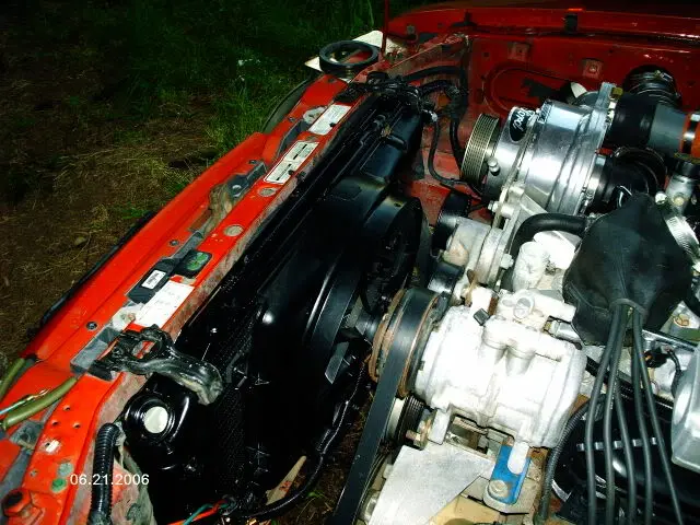

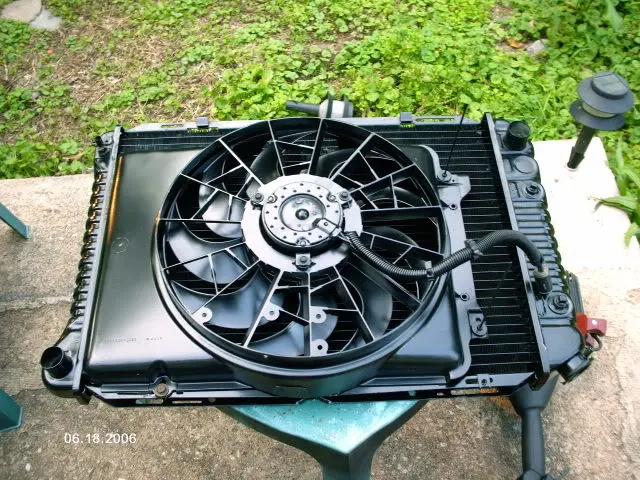

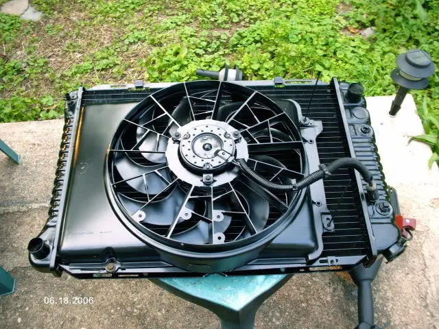

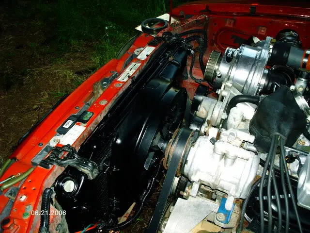

It doesnt matter with the headgasket recall... Had a taurus with a bad head gasket and after replacing it twice this is the only thing it was good for...
