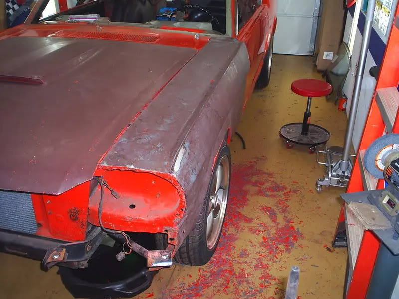

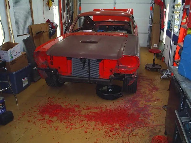

While screwing around in the garage last night I decided to try the razor blade all the while talking trash on the idea. 3 hours later my drivers fender and hood were stripped to factory primer (w/ 2 people working).
Basically, it takes a little effort to find a place that you can get the razor under, but once you do its not terrible (by that I mean not as bad as running a DA for 3 hrs straight). I held the razor at about a 45 degree angle or less and worked it until I got a technique down. I found that if you take the crimped back piece off (paint buildup actually pried it off) that blade is flexible enough to do the contours pretty well too. I'll upload some photos tomorrow.
I didn't find it to be as fast or easy as some claim (not saying they can't do it) but it is a good alternative. Based on how long it took thus far, I figure it will take myself and another person 12 hours to finish the majority of the car this way.
Also, it didn't work on areas w/ filler or rusty spots.
Edit: Photo update...
