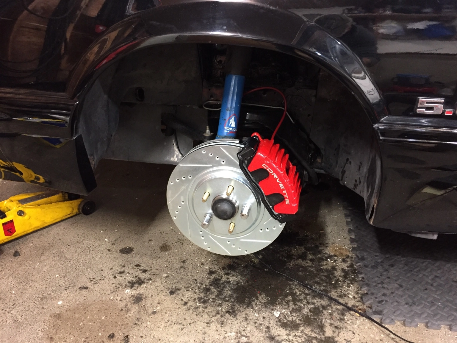

Not seeing any motorcraft options for a 1999 Corvette though
If the calipers are the same as Cobras, why don't they sell pads?
