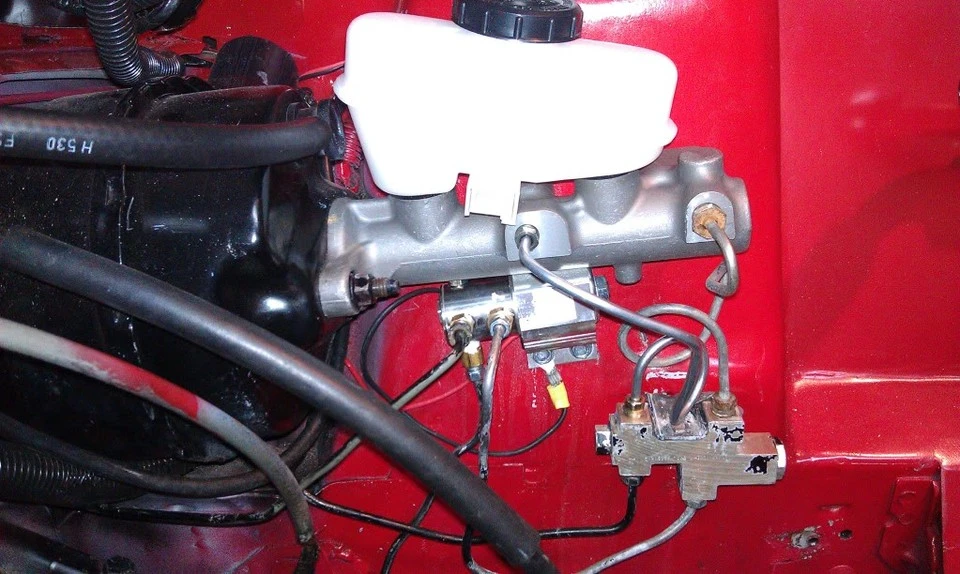

I installed my 93 cobra MC and line locks and adjutable proportioning valve on my 89.I already had 4 wheel disc.Now the pedal is hard topush and it barly stops!Even after i fooled with the proportioning valve. Any ideas?peace

I have been doing a little research since i posted this,and i was thinking it could be the adjustment rod in the booster?I did or thought iadjuted it correctly per mm's instructions.But i could be off?I will try to adjust it in some and try that?I do have the stock 89 booster tho.peace

Ok i will watch that.I have OEM 03 cobras front and OEM 94+ cobra rears,93 cobra M/C and a summit proprtioning valve.Before i did the mc and valve the brakes were soft but stopped good.....peace

What do you mean?I order the 3-2 conversion from MM and they say to keep the stock valve.

Honestly...I think you'll have to change the booster.
If you don't want to, you'll need a smaller mc to compensate.....like 94-95 cobra mc (15/16")

5L5... this makes no sense to me. A LARGER MC would increase the mechanical advantage and make things easier on the brake booster. How does this compute?
Because it's highly dependant on the ratio of the piston area of the master cylinder vs the slave cylinders (calipers)
A larger MC pushes more fluid. Drum brakes require very little fluid to operate so when adding rear disks brakes, a larger bore MC must be used.
But too large of a bore will push a lot of fluid so the pedal distance will be shorter since more fluid moves. As a result, pedal will also be harder. A smaller bore pushes less fluid, but as a result the pedal stroke needs to be longer to operate the pistons properly.
Given the same calipers, downsizing the MC bore will make pedal effort easier, but require a longer stroke. upsizing the MC will make pedal effort firmer, but require less distance overal of pedal travel.
So choosing an MC requires a little bit of thought. Just putting a larger bore MC on won't give you a good pedal. There are 4 disk brake MC's, all 1/16" bore differences. There is no "universal" MC that will work with all disk setups

To massage the tower I use a hammer and a block of wood. It only needs a little clearancing in order to get the boster in place. Once it's up tight to the firewall there is room for the booster, but getting in place is where the clearence is tight. I realy don't think it changed any geometry at all.
I originaly didn't change the booster and used the stock one, and you had to stand on the pedal to get it to stop. I hadn't changed the booster cause I was hoping that I could get away without it. As far as an emergency stop with the foxbody booster and sn95 MC all I can say is GOOD LUCK. I drove around the block twice and pulled it back in the garage to change the booster.
Kinda what I did. Tried to go without the booster..one trip around the block and i went home and changed it.
I didn't do any massaging. I slotted the firewall holes, cut the studs down about 1/2" and it slid in without hitting the strut tower at all. Difference in stopping was night and day
