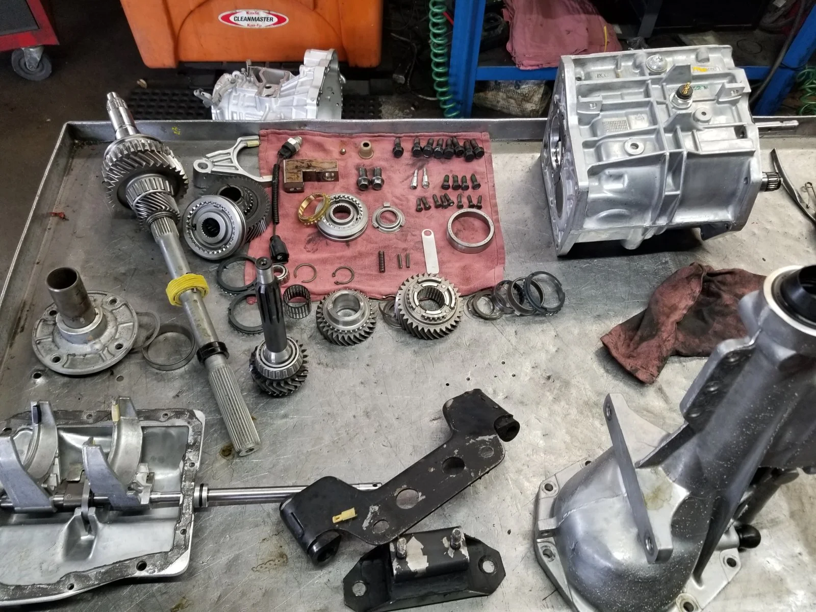

Ok so today at the gas station, I was on a hill trying to back up when tires spun something broke I’m sure because there was a bang and sounded as if something fell out. Shifts into all gears perfectly fine but when put into reverse it clunks and bangs and stalls. Sometimes, the shifter gets stuck in reverse and I have to try to go a bit to get it unstuck. What could I have broken and how hard do you think it’s to fix?
Unfortunately no way to tell without pulling the trans, opening it up and taking a peek.
Reverse in the t5 isn’t that strong and a few parts could have snapped internally and are now jamming up the gears.
If you don’t know your way around the inside of a t5, probably best to start looking for a replacement trans and swap it out.
Yeah I’ll pull it and look pretty sure I’m gonna need to replace it

I've done both the 3550 and the T5 multiple times. The 3550 is slightly easier, but neither is that bad. I wouldn't go buy a rebuild kit first. The kit usually doesn't include what is broken, especially in this case. If you get in there and find a bunch of stuff in included in the kit that is in lack luster shape in addition to what is broken, then buy the kit. The best place to buy T5 parts is EBAY, hands down. There are guys that make a living pulling them out of scrap yards and parting them out on EBAY. I don't remember what I bought for the last T5 I did, but it was a bunch of stuff, including the 5th gear set which costs a fortune new. Got it all done for $168 on EBAY.

Wow thanks a lot!! I am one of those guys that will try anything and tearing into this thing will be a whole lot easier with this info. Thank you
