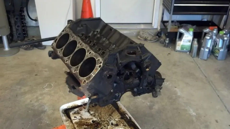

Brought an engine home, round 2.

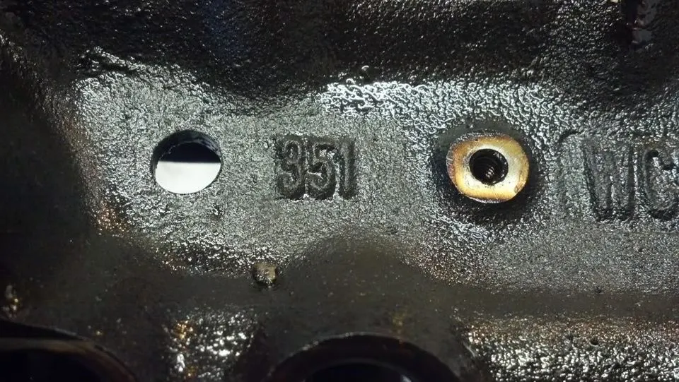

Yeah, I also find it funny that 5.0 blocks split in half regularly compared to the 5.8 block which failure is almost unheard of, yet 1/4 to 1/3 of the blocks carry this fracture. It was just a heads up.
For me, I am not even going to look for the crack when I get my block. I am just going with the ignorance is bliss strategy... Mainly because I only want a relatively mild build.
Well, I'm gonna hope my machine shop took the time to do the same before borking mine for my stoker? They did put new cam bearings in the block, so I can only assume everything checked out. Good thing I'm planning to keep power levels within the 350-370hp range.
According to Woody, it's something he only sees in roller 351s. Not 302 blocks.
Well that's a relief. Anytime I've seen a roller 302 cracked, it's been right down the lifter galley....but it's also usually after someone has tried to push 500hp+ through it.
....I don't imagine the stock 210hp/285tq this Explorer I got the engine out of was putting out put too much stress on my block. :D

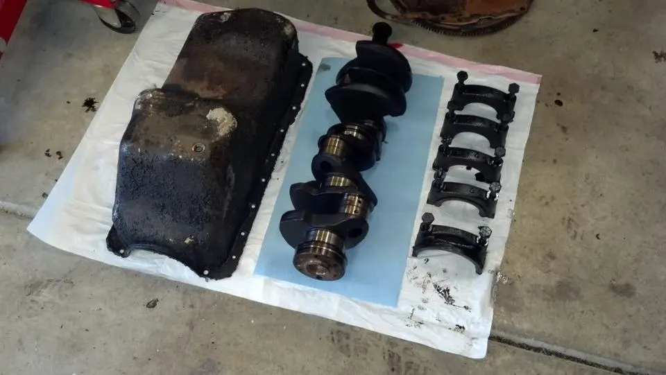

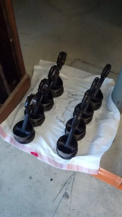

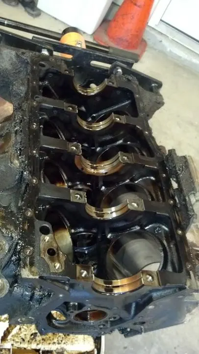

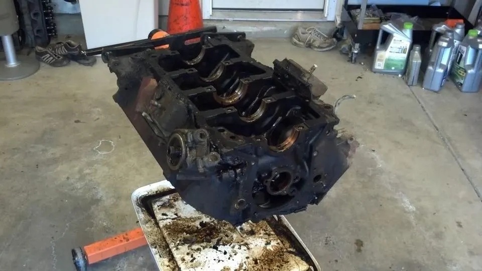

Well, I have all the guts out of it. Bearings were very very worn, but again, no catastrophic damage. Pics!
Too many parts!

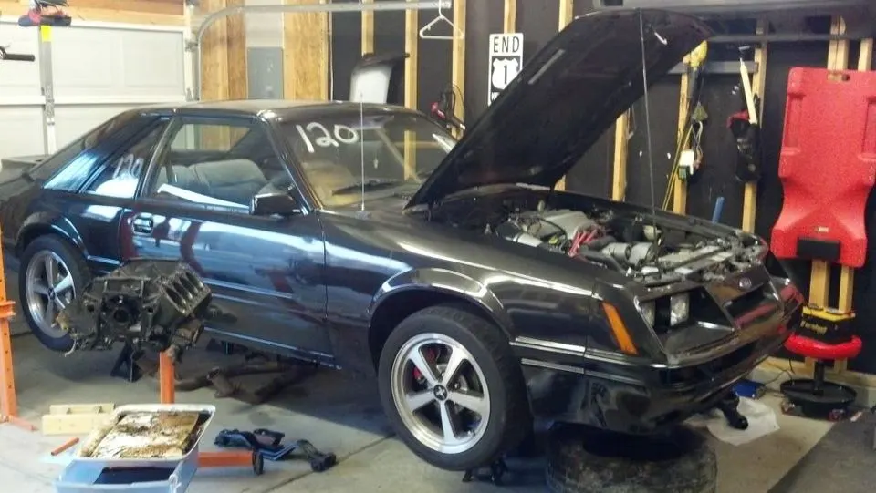

Buddy of mine said I had to take a pic of it in front of my car, since it's always in the background anyway haha.
This might have to be my avatar eventually...

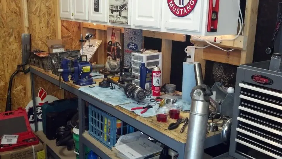

And my other ongoing project, rebuilding the T5:

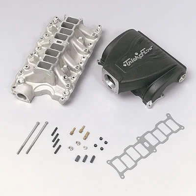

It's not so much the size of the ports (cross section) as it is the length. I don't plan on taking this engine past 6500 rpm, and some part of me still believes in port length tuning, whatever that means. I've always been a fan of the TFS Box-R intake, which is maybe more in-line with my RPM goals. I wish I could have a more intelligent conversation about port length tuning, but everything I've ever read and researched on just kind of waves its hand at it, acknowledging it's there, but not really going into the gruesome details.
I dunno, in the end I may just say to hell with it, and run a Super Victor with an elbow, and try not to think about port length tuning. And maybe I'll run one of those new quad pattern cams. :D

A box intake isn't going to have much more runner than a Victor...
With some decent cubes, it's not like you'll need extra runner length.
Yea I was thinking about cleaning up that oil cooler and doing something with it. It certainly couldn't hurt once I put bewst to this thing. :)
The TFS Box R actually has quite a bit of runner length to it (compared to a single plane style intake). Trick Flow's website claims 11 inches. (Insert "that's what she said" joke here.)
I vote the standard Trick Flow "R" series. Simply because it's the coolest looking. :nice:
Haha yea I agree, I have always liked the looks of the long-runner R. That's the manifold that's on the car now. If it aint broke don't fix it, maybe? I could always just swap over the lowers.

That is the one that has 11" of runner.
There is no way the "box" has 11" of runner.
When you say "box", the one in the pic is not the one I think of.
I have a Trick Flow R lower for a 351 for sale.............let me know if your interested.
The TFS Box R has 11 inch runners, the "long runner" R has 13.3" runners. I ain't chittin ya, man.
Box:
* Large cross-section 11.000 in. runners
* 2,500-7,500 rpm range
* 90mm throttle body inlet
* 2.000 in. x 1.200 in. port size at cylinder head
* 12.750 in. overall height to the flange
http://www.summitracing.com/parts/tfs-51511009
Long runner:
* Large cross-section 13.300 in. runners
* 1,500-5,500 rpm range with 75mm upper
* 2,000-7,000 rpm range with 90mm upper
* 75mm or 90mm throttle body inlet
* 11.500 in. overall height to the flange
http://www.summitracing.com/parts/tfs-51511004
