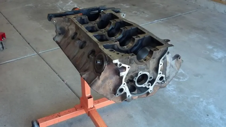

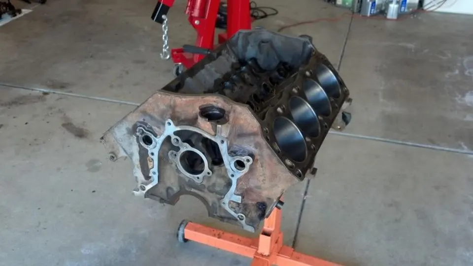

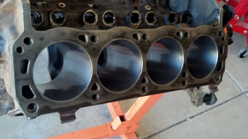

The engine is home from the machine shop after being magged- no cracks! It's actually in such good shape, there was some miscommunication at the shop and they ball honed the cylinders, thinking I was just going to throw pistons in it and run it, lol. It does have some slight ridging, and I want to do this build right, so I am still going to have it bored. Also going to stud the bottom end and line-hone it.
By the way, they only washed the block, thus why it still looks rusty. It will obviously get a true cleaning and paint eventually.
