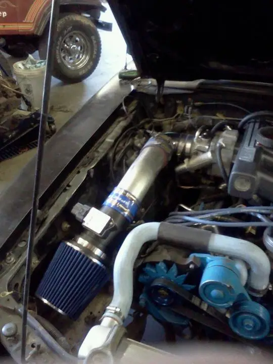

Swapped back to the MSD and it fired right up lol. Probably plug gap or possibly a bad replacement coil. I'm actually starting to think it's MAF related. It has a filter on the MAF but today I'm swapping to a thru the fender CAI. I'd like to put a air straitener in too but I don't have one laying around.
Sent from my iPhone using Tapatalk
From the Surging Idle Checklist.
MAF meter on CAI system that needs clocking or protection from engine compartment air turbulence. A cone type filter located inside the engine compartment is almost sure to have surge problems due to the hot, turbulent airflow around it.
Don't do this: it is a big NO NO.
Try cleaning the MAF element & then "clock" the MAF by rotating the entire MAF housing to see if changing its position helps any.
