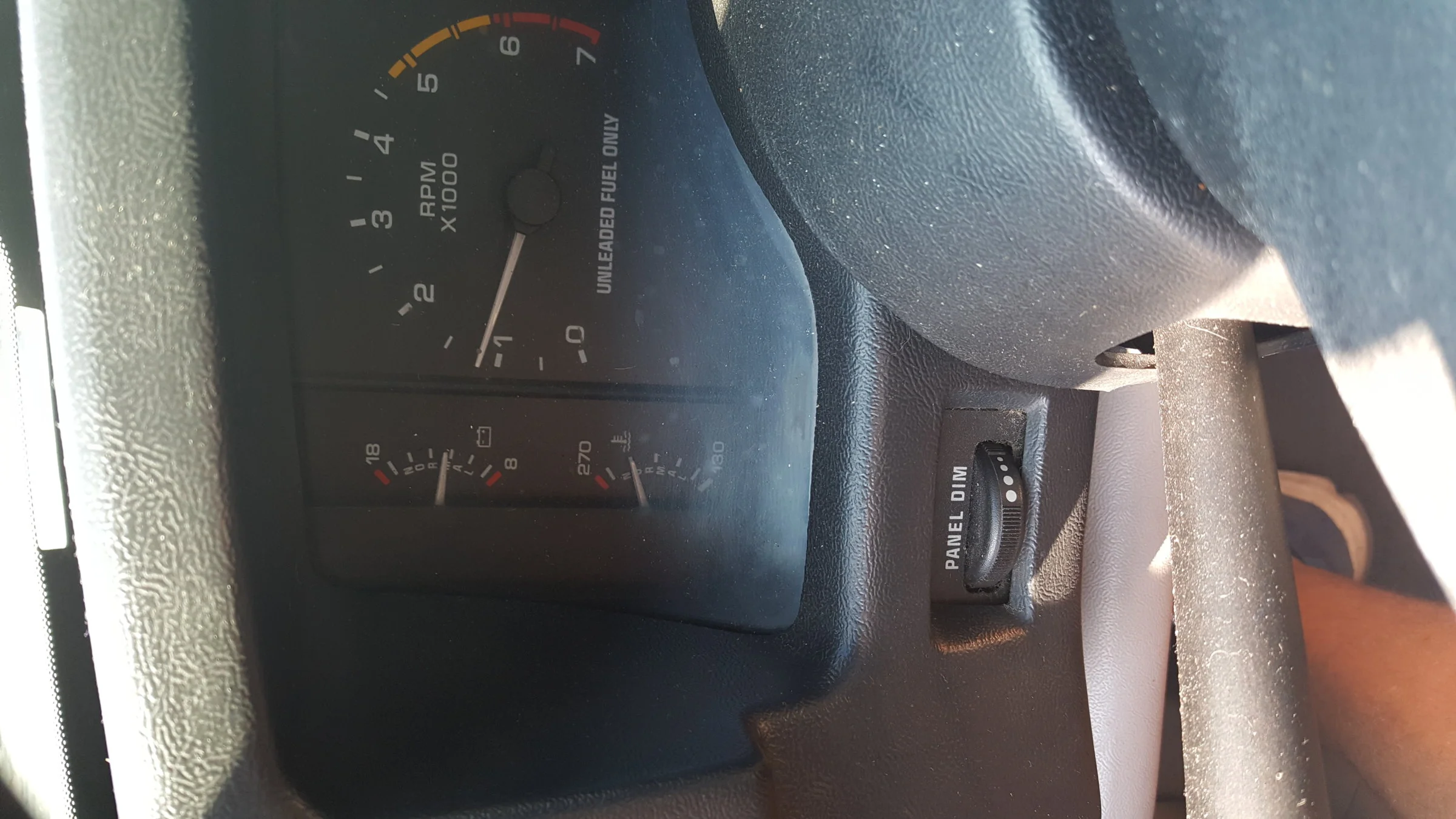

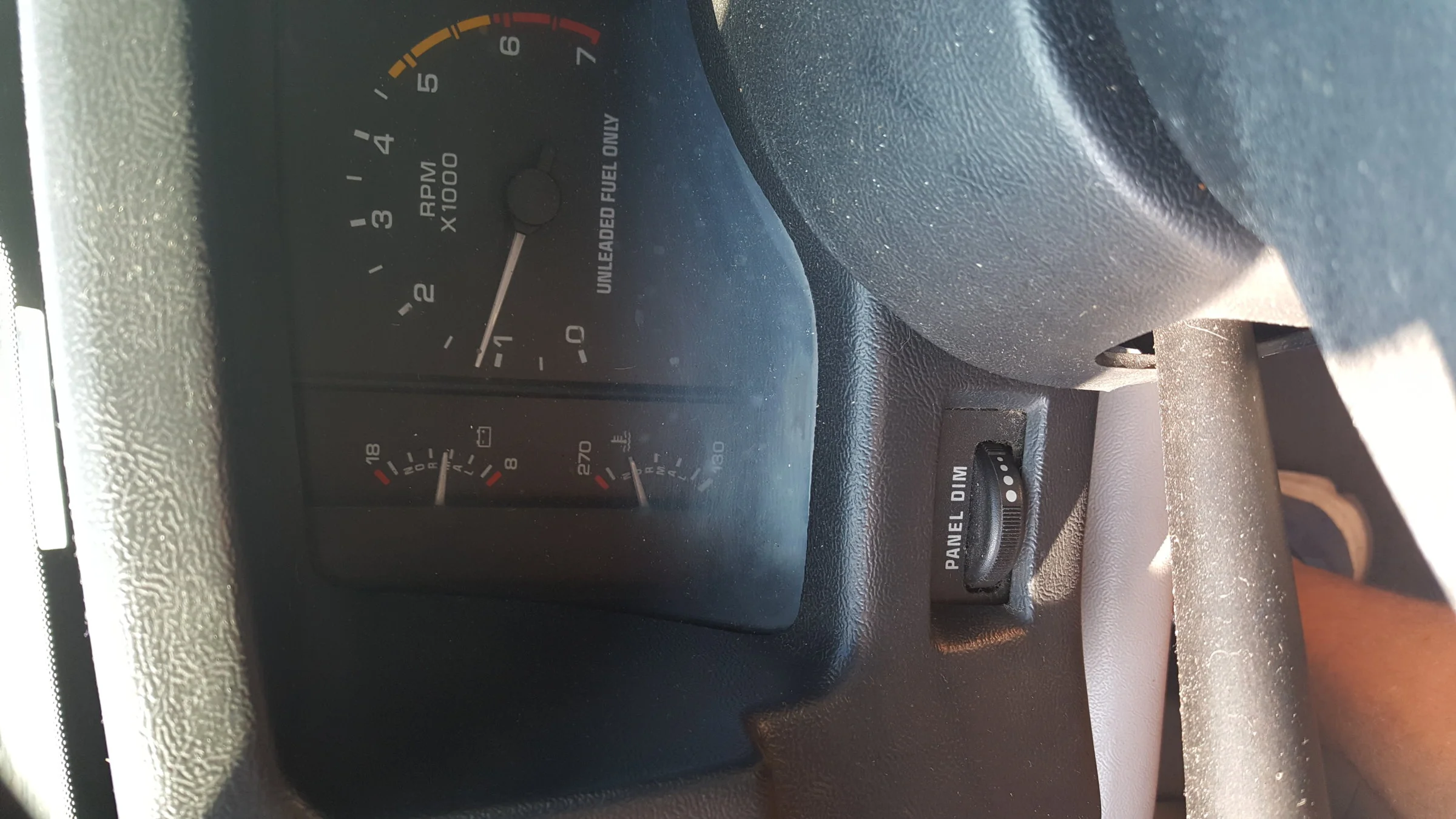

Hello everyone...i have simular but slightly different issue have a 92 5.0 lx just purchased replaced all 8 plugs dizzy wires oil change oil filter and cleaned throttle body and upper intake distributor was the last thing done but first put new cap and rotor it bucked and jumped with load at 3000k rpm so we replace the dizzy because thought was the module on there no longer bucks but seems under powered and run on the hot side temp wise sitting 3/4 and stablizing there.....any suggestions?
Check the the distributor was stabbed correctly and verify your timing. Contrary to popular belief, you can stab the distributor one or two teeth off. Down on power and hot sounds like it may be too far retarded. With the distributor fully seated, ensure that the rotor is pointing somewhere between `11-`12-o'clock position at TDC of the compression stroke. Once you know the distributor is in right, unplug the spout connector and verify (with a timing light) your ignition timing is at least 10* BTDC. You can usually run a little additional advance in the 11-12 degree range without any adverse effects.....more if you're running premium fuel, though I haven't seen much benefit in running it that high.
