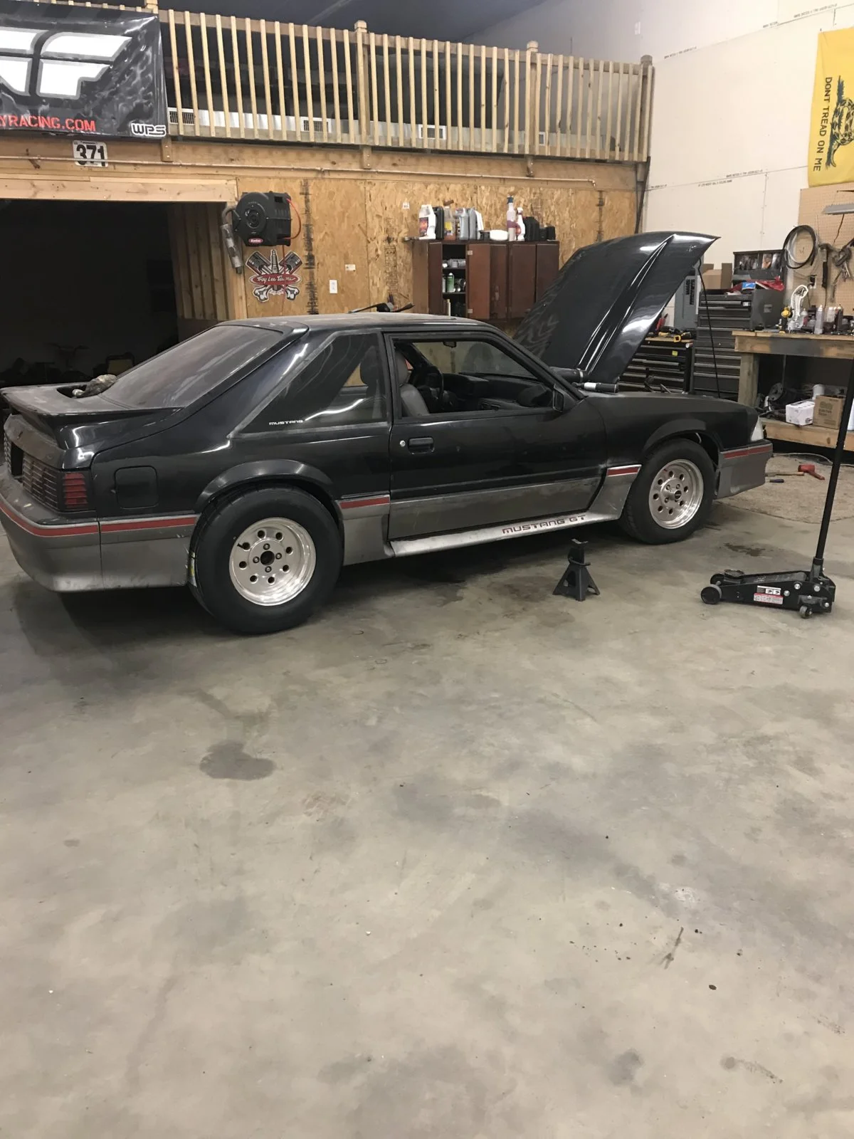

well... i got my fuel system back going. checked for leaks last night and didnt have any. it was my first time making AN lines but wasn't to bad.
if i had my upper intake gasket i would be good to go i could fire this thing but i think its lost in the mail. was supposed to be here on the 2nd and hasn't changed anything in the shipping info since the first.
really sucks :-( oh well.

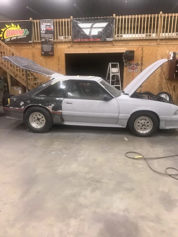

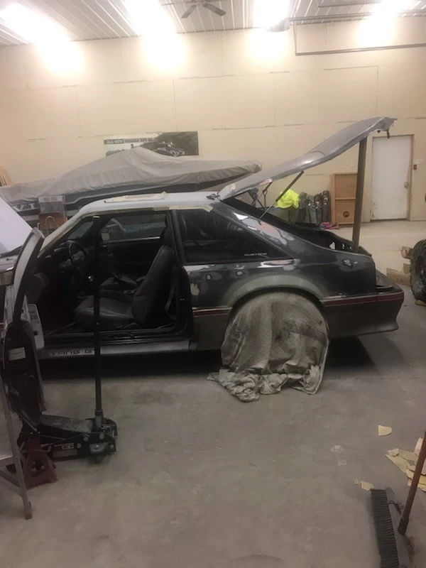

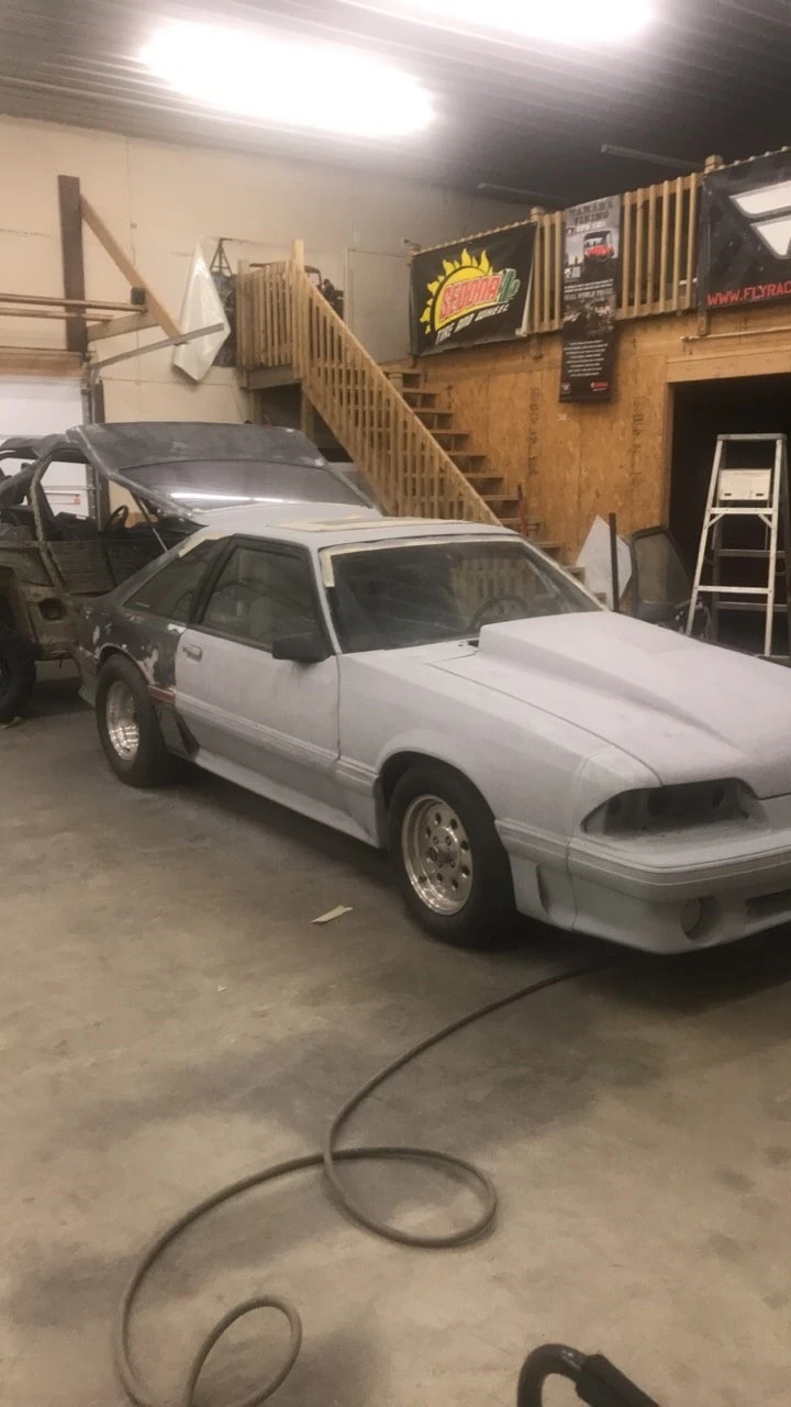

Well.... im still around. just been doing some body work to the car. i think i may have it painted before spring.... ill get some picture tonight. if it wasnt for these patches of surface rust down the doors and quarters this car would have just been scuff and shoot.
i ordered new door seal and window seals as well i need to put in.

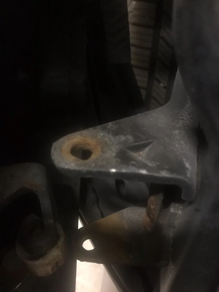

last night i went to replace the door pins in the drivers door and the bottom hinge is to far gone for a regular bushing so i ordered the over sized one hopefully it will work.....
these were spots like poka dots ranging from the size of a dime to a little bigger than a half dollar so you have to gring the out the spot putty them and then block them out.... at least i think thats the best way to do it . im no body guy tho.
