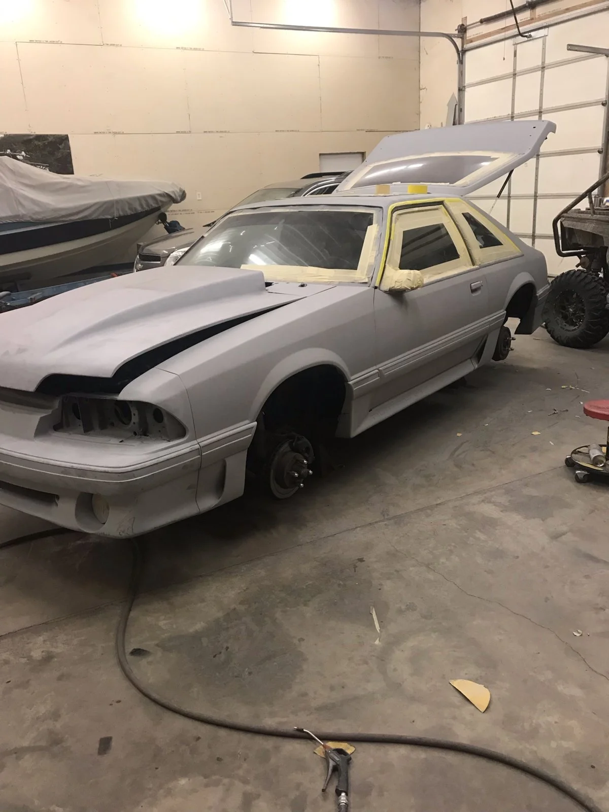

the 16th i will be painting this thing....
that's the boat I'm in too :-( but I have a asphalt driveway and a car port covering the car. hopefully I will be able to get back at it in a couple weeks if the weather finally gets and stays warm here in NJ. And I was thinking of getting one of those temp garages/shed tent thing for like 150.00 for HF to paint it in... ;-) same thing, don't need/want a show car...

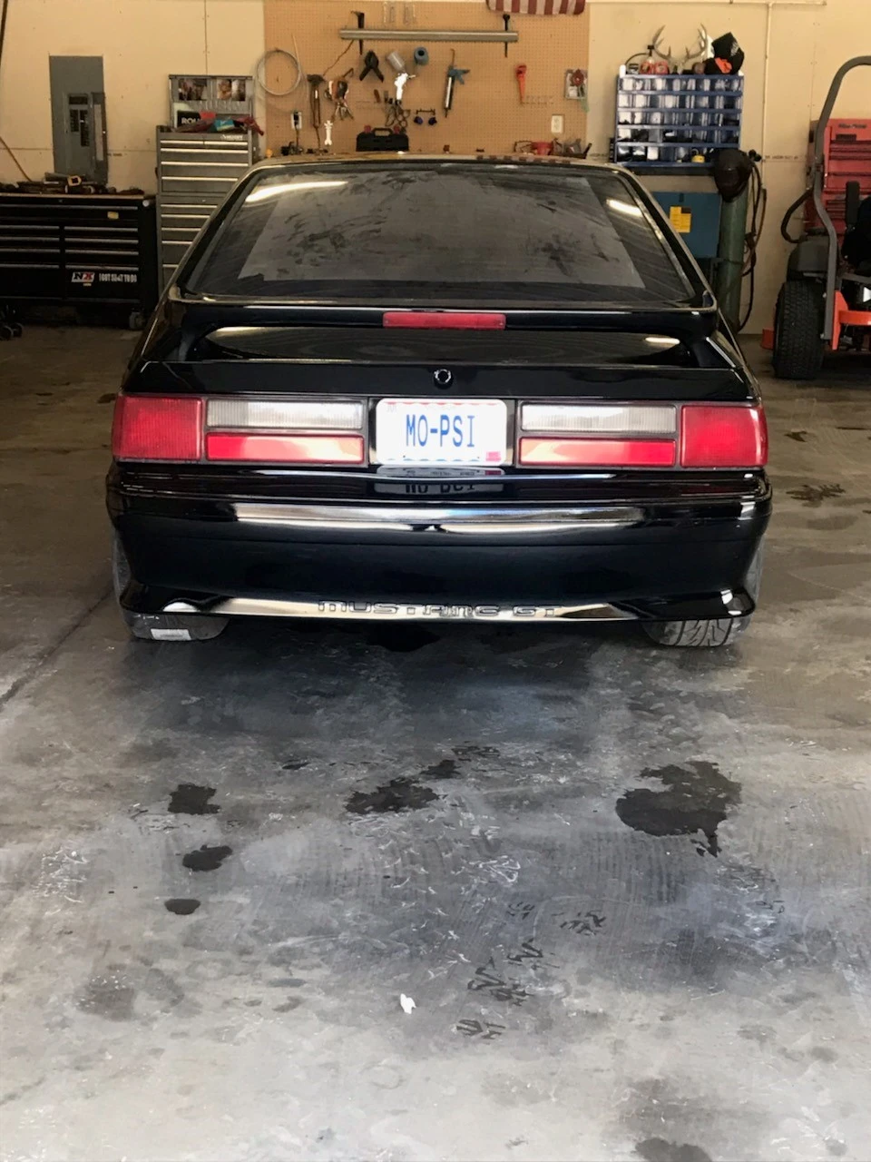

Well.. yesterday i took the car out of the garage. hooked the lap top up to it and let it go through the warm up cycle. it starts up and everything pretty good. idles good.
had a few little leaks here and there i had to fix BUT i did get to take her on her maiden voyage yesterday. i drove it for about 5 mins and let it auto tune the whole time and it really didnt drive to bad, i didnt get into any boost yet but i want to get the lower driving tables pretty well ironed out before i go puting this thing into boost.
