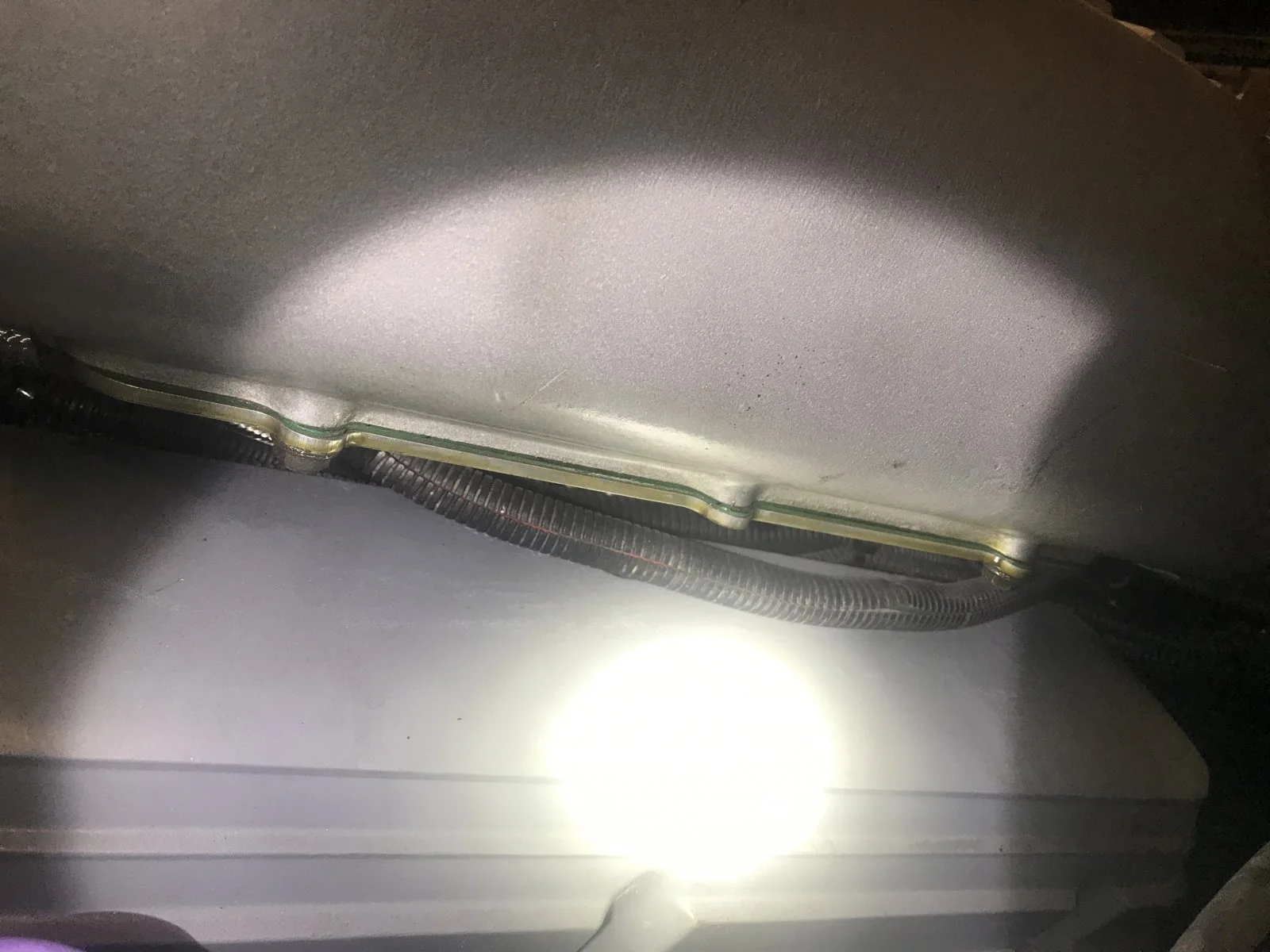

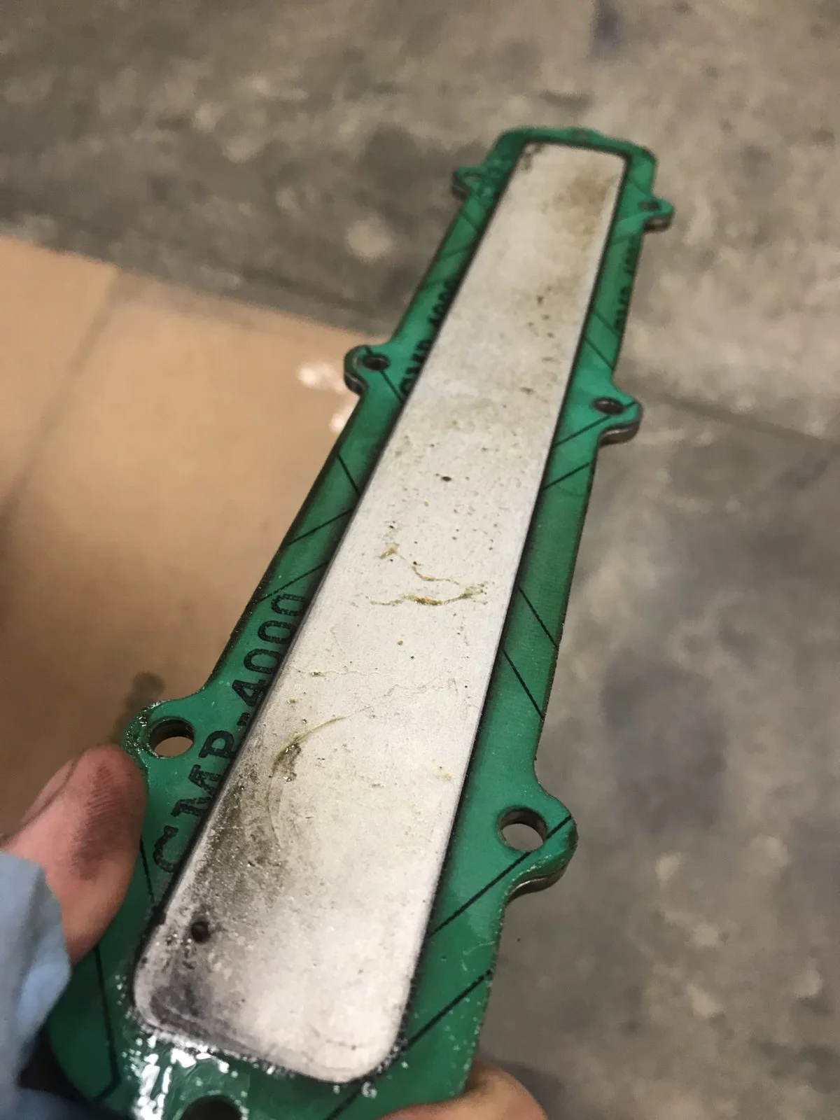

Could be residual oil in the intake manifold. Remove the upper and clean it thoroughly, check the lower and retorque the lower manifold bolts for good measure. If you can look down the lower runners to look for oil buildup. Was this intake used? The leaking plenum gasket could be allowing the oil to be pulled up into the runners.
