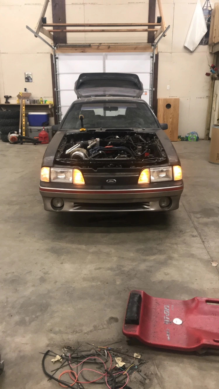

Alright guys I need suggestions. After I started the car up and let it warm up I have collating running out of one of my head studs. Anyone have any easy fixes. This really sucks. I didn’t put and sealant on the bolts as they only want you to put the arp grease on them. It’s the 2nd or 3rd from the front on the passenger side

lol... i got it all back together. got my fans wired in and backed it outside last night and let it warm up to make sure the fans would kick on and they did. i set the fenders back on it and am gonna try and get some of the front back together now so it actually looks like a car. its still hunting pretty good at idle but i havent played with it much since i found the head bolt problem. its coming together now tho.
once the fronts back together ill have to swap the pump out.
