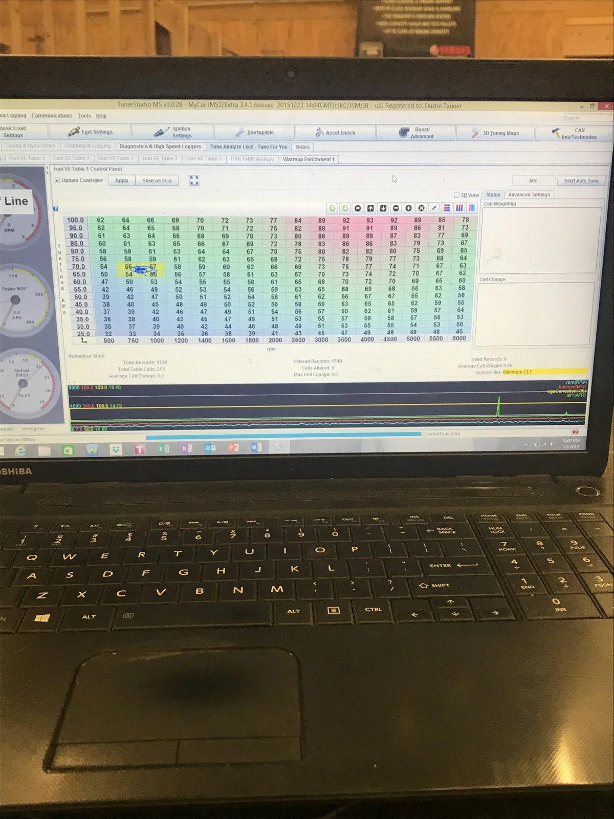

car moved out of the garage tonight under its own power.
still running rich. I have confirmed the timing using the trigger wizard, and tried my best to get the wideband calibrated but It seems like its so rich its up in the 18s. going to do some research on how to bring it down.
a91what
SendMeUrDataLog
Mod Dude
Apr 6, 2011
7,653
4,386
204
30
Hillsborough county
You are using a base tune that is setup for an NA car, you have to build the table for it to go above 100kpa.
Sounds like your really new to tuning... the higher the AFR number the LEANER the engine is running. Your lean not rich, you want to shoot for 14.7ish at idle.
I do supply base tunes PM me for details.
Now to bring the afr down you will need to open the ve table and in the blocks around where the blue dot is raise the numbers. Higher the number more fuel added.
Anti_Hero0932
Jan 29, 2012
196
103
53
28
LaGrange, MO
sorry, I ment while I keep it idling with my foot its at like 18.00 or better if its idling its at 11.8 or so. I sent you a PM
