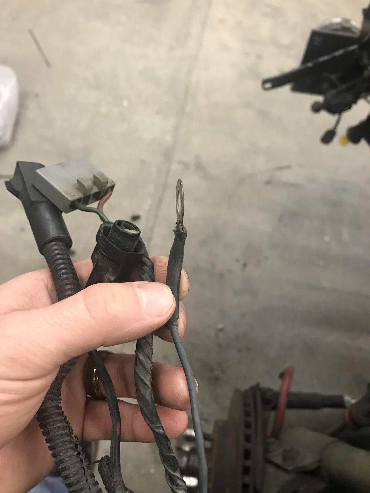

Ok fox gurus. The part of the harness that goes to the coil. It has four plugs. One is to the coil. The blue wire with the ilet ... is this supposed to go to the solenoid? The single prong plug is just a ground if I’m not mistaken. And the two prong plugs into another part of the harness.
So I guess I just need to know what the blue wire is for with the ilet
