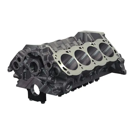

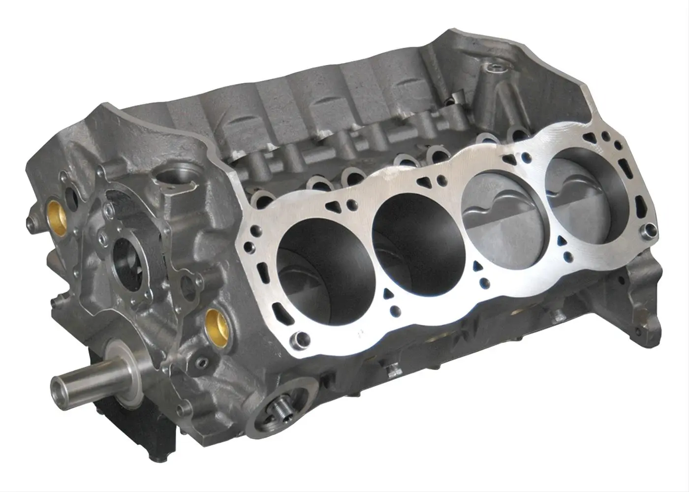

All time easiest way to tell if it’s a 9.5 deck is to look at where the distributor goes into the block. If it’s damn near flush with the China wall, it’s an 8.2. If it’s a good bit lower, it’s a 9.5 deck.
Top is 8.2, bottom 9.5. It it’s not a 5.8 deck then you can pretty much discount the entire description as bs.

Sorry I'm not familiar with what an 8.2 deck or 9.5 deck are. Can you please explain what this is
