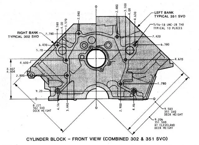

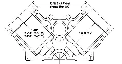

Thanks never heard those numbers before. Out of curiosity what do they represent?
8.2 and 9.5 are the deck height measurements. Measured from centerline of crank to head mating surface (where the heads bolt to)
