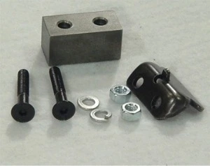

You can use that T5 bellhousing with the stock clutch linkage, no problem. Just get the fulcrum adapter and bolt it in. And automatic cars were identical to manual cars, except for the pushrod hole, and there's a dimple marking where that goes.

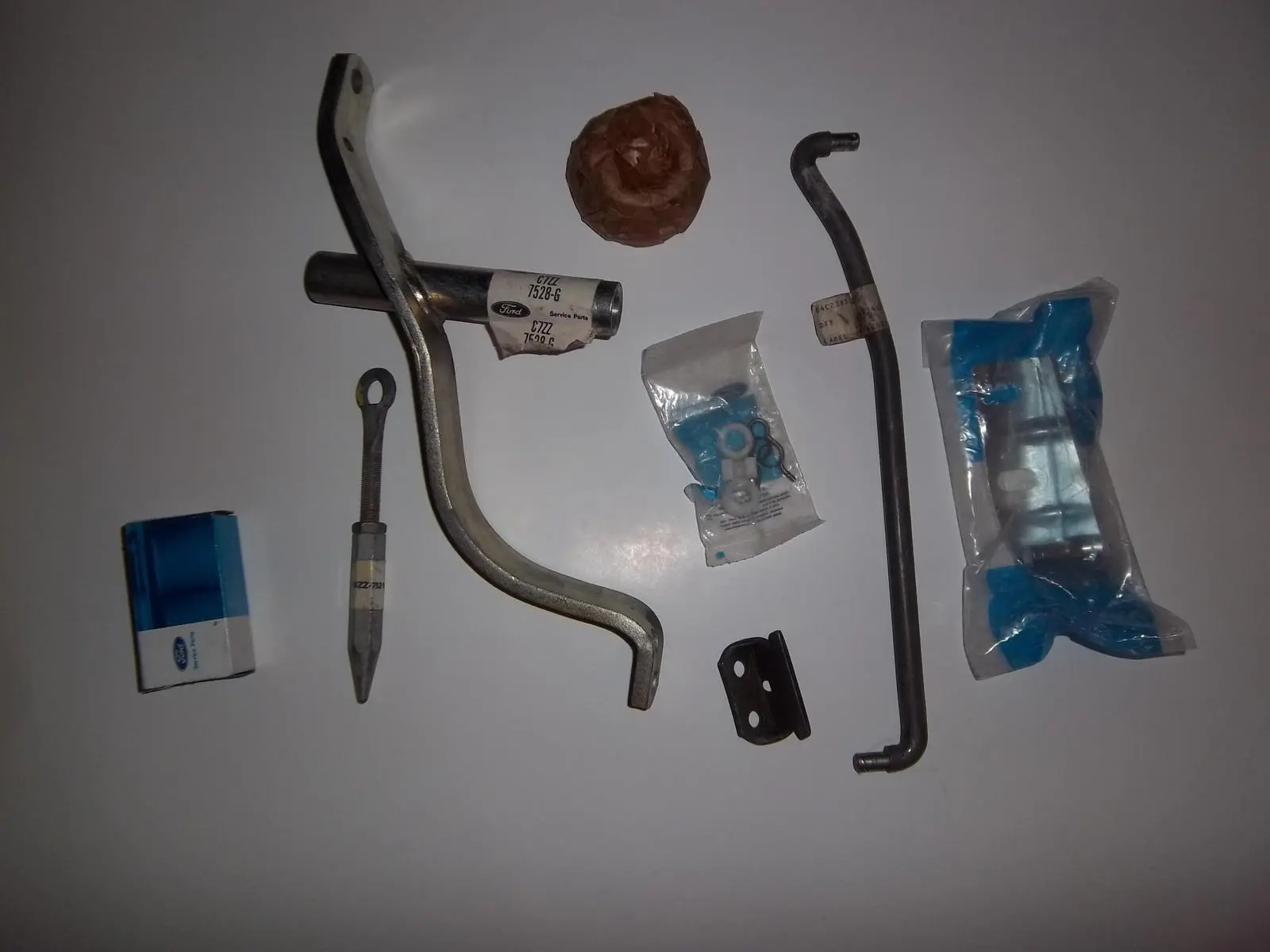

I was lucky enough today to find some NOS clutch linkage parts at my loc parts dealer. So that made this decision alot easier! Thank you all for you input. I'm sure I will be bothering you some more with tech questions.
