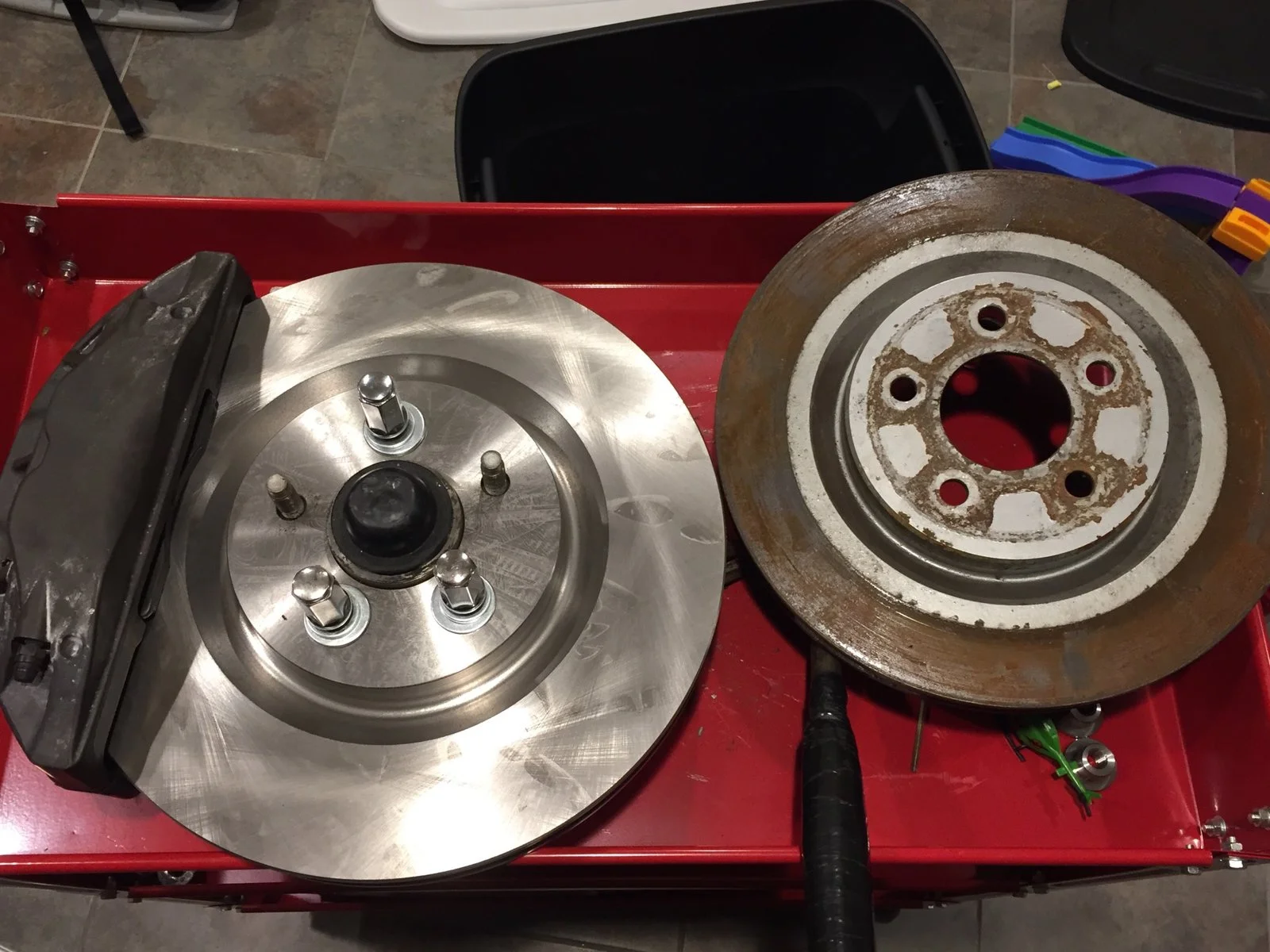

Just messing around with this setup, no intention of running it, but pretty impressed how it fits together. Not strictly 100% bolt on though..but can be.
Cobra 13" rotor on the right.
They are Junkyard Caddy XTS Brembos, and GT500 14" rotors. I paid $90 for the paid of brembos from a recycler, and $70 a rotor. Grand total $230.
However, they need some modification, Approx 0.075" needs to be machined off the mounting flange of the caliper, and the caliper mount inserts need to be removed and replaced with modified machined inserts with a 1mm offset. Basically...you need some machining skills and equipment to do this swap. After that....100% bolt on
But...I don't have wheels big enough to clear these, so this is the end of the road. just a fun experiement.

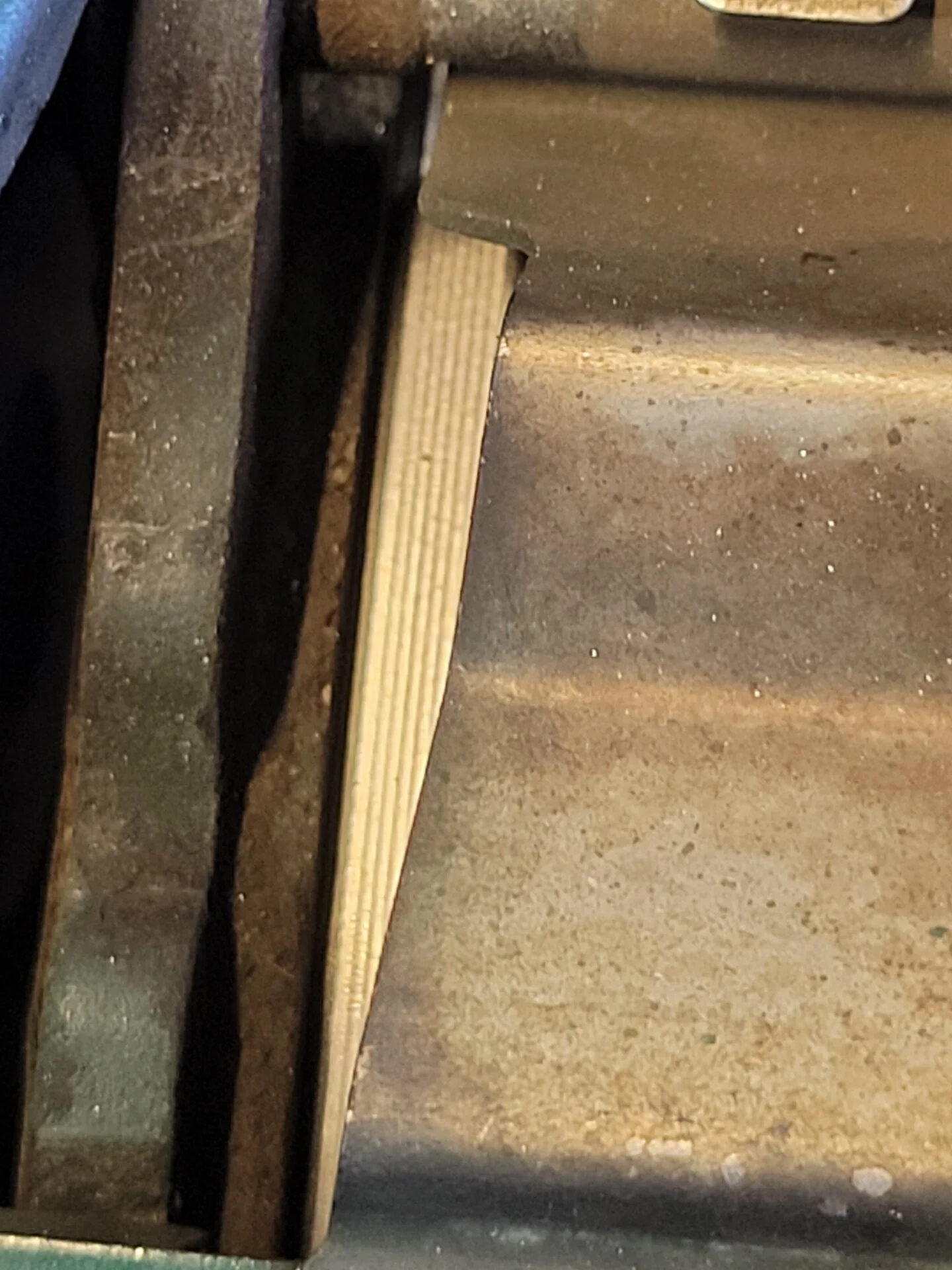

18x9 Saleen Reps, 14" x 1.26" Shelby rotors, XTS calipers. Needed to shave about 0.075 off the caliper mount flanges (as Mustang5L5 said), made a set of inserts with 1mm/3mm offset hole like he has made. I get 0.030/0.036 side to side clearance between rotor and caliper. Everything spins smooth with no contact.
I also cut a little more material to allow calipers lower on rotor.
I clearanced into the caliper to the blue marks...

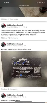

There’s a guy who sells them already done. Same dimensions as what I modeled up. Even comes with a rotor spacer if you don’t want to mill the caliper. It’s meant for the ATS brake setup, but the inserts will work on the XTS setup too. Unsure the dimensions on the rotor spacer though
S&S engineering on FB
