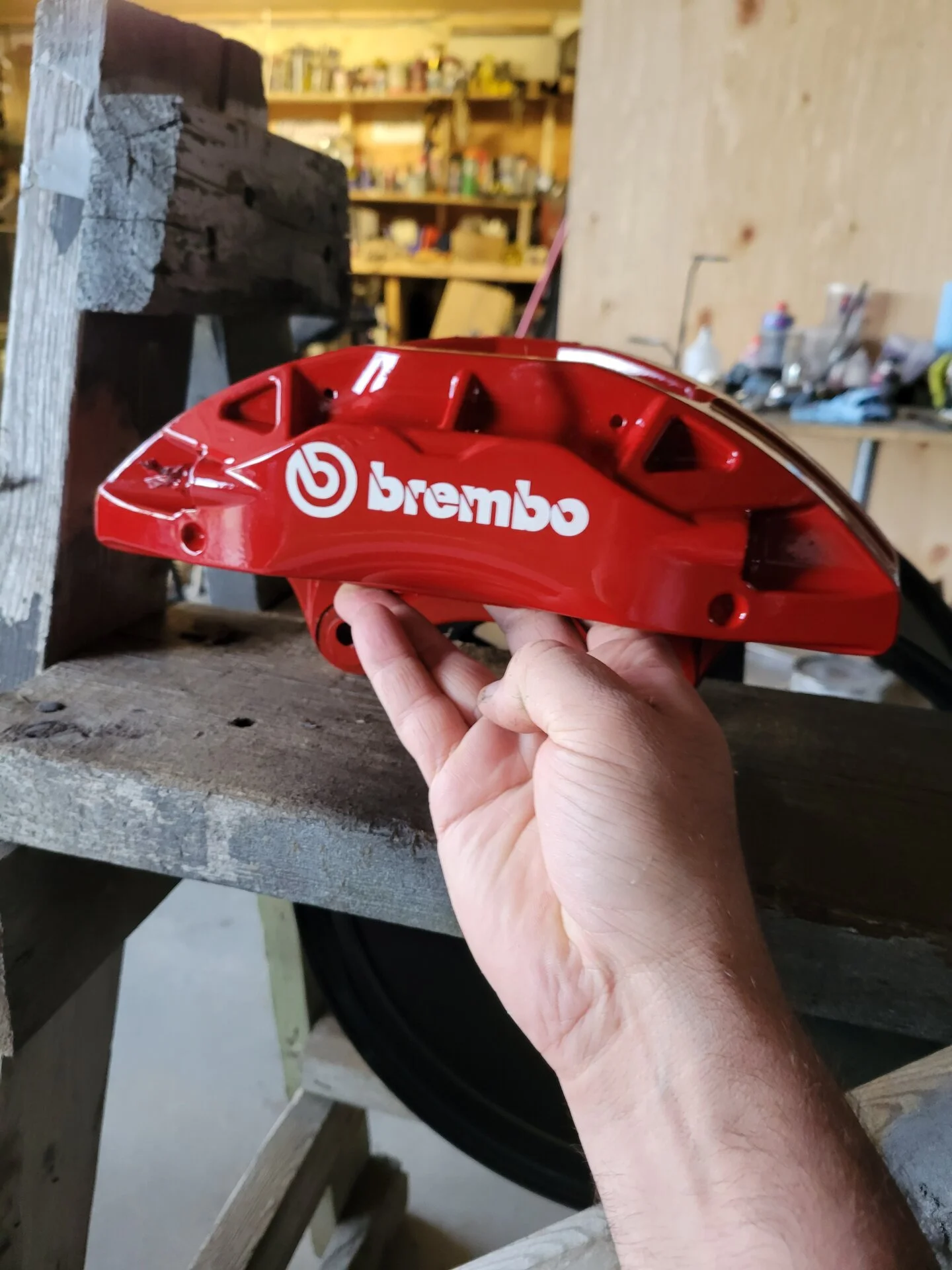

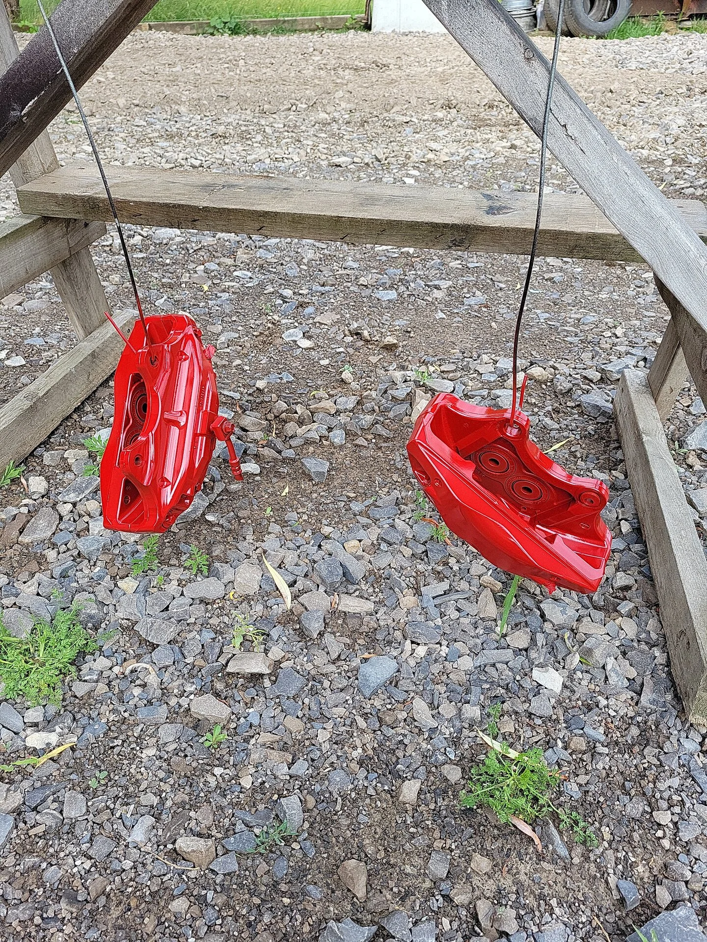

Caddilac XTS 14" Brembo brakes on a Mustang.

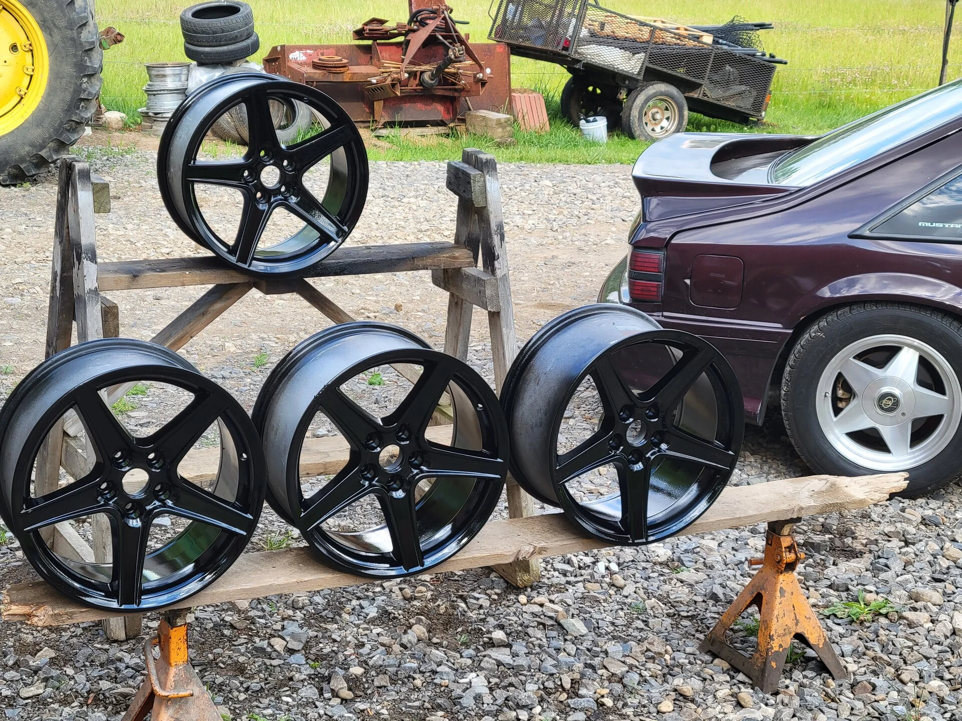

Got wheels painted today...

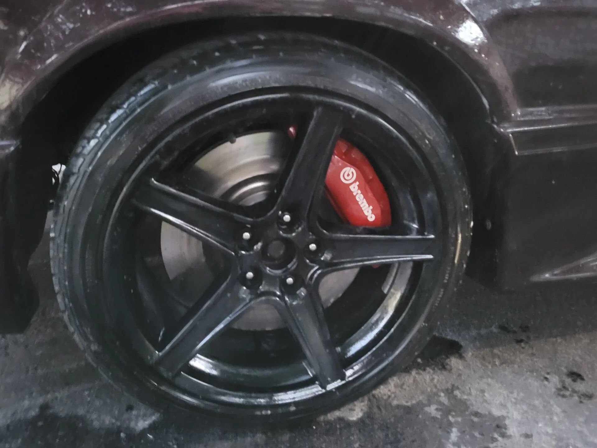

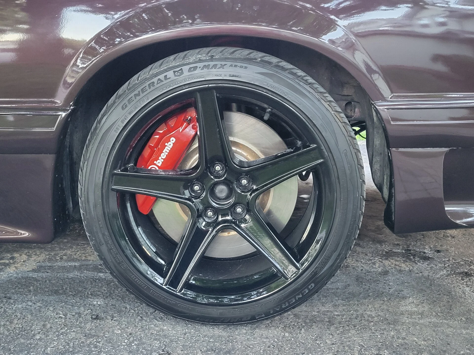

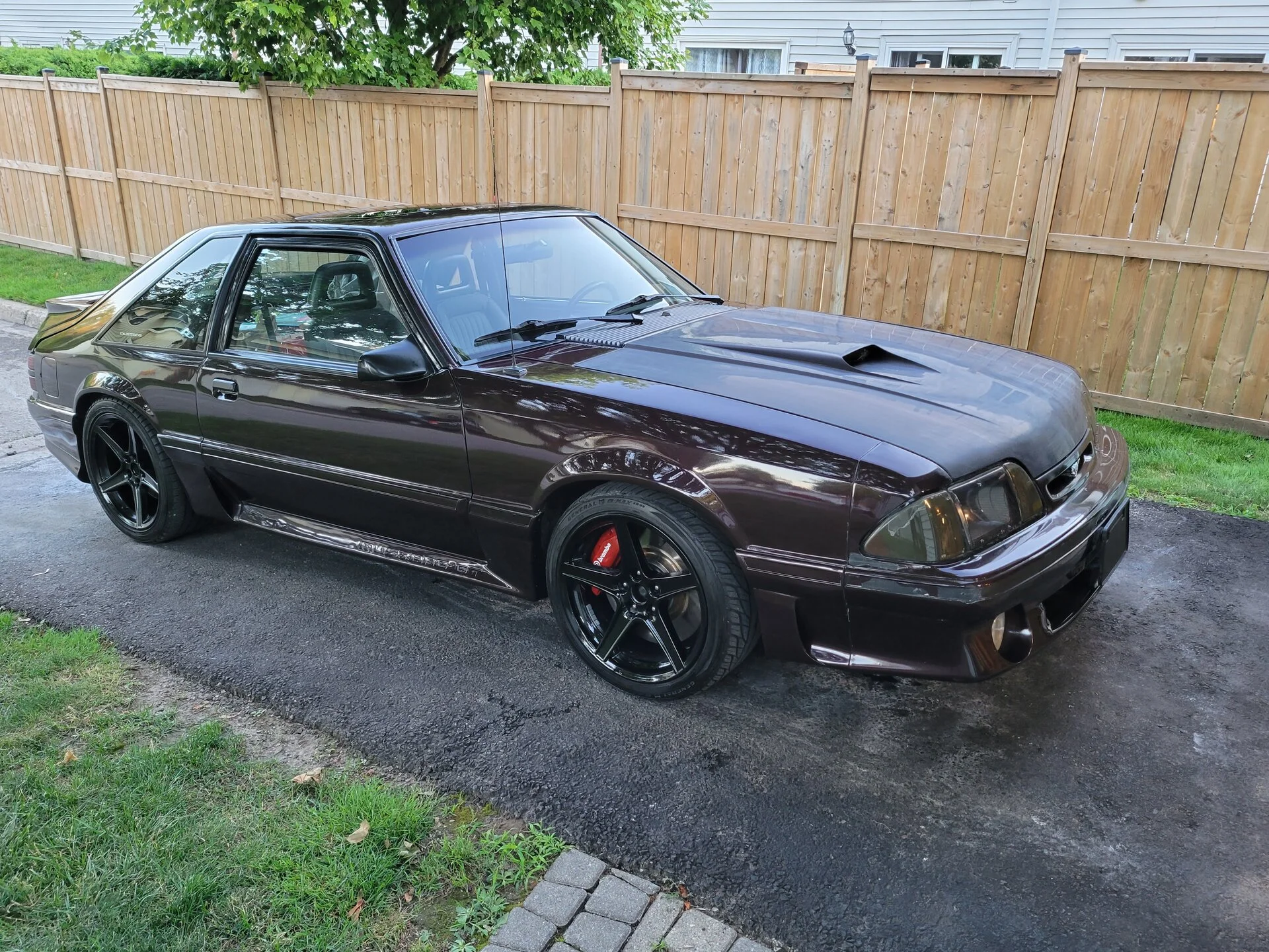

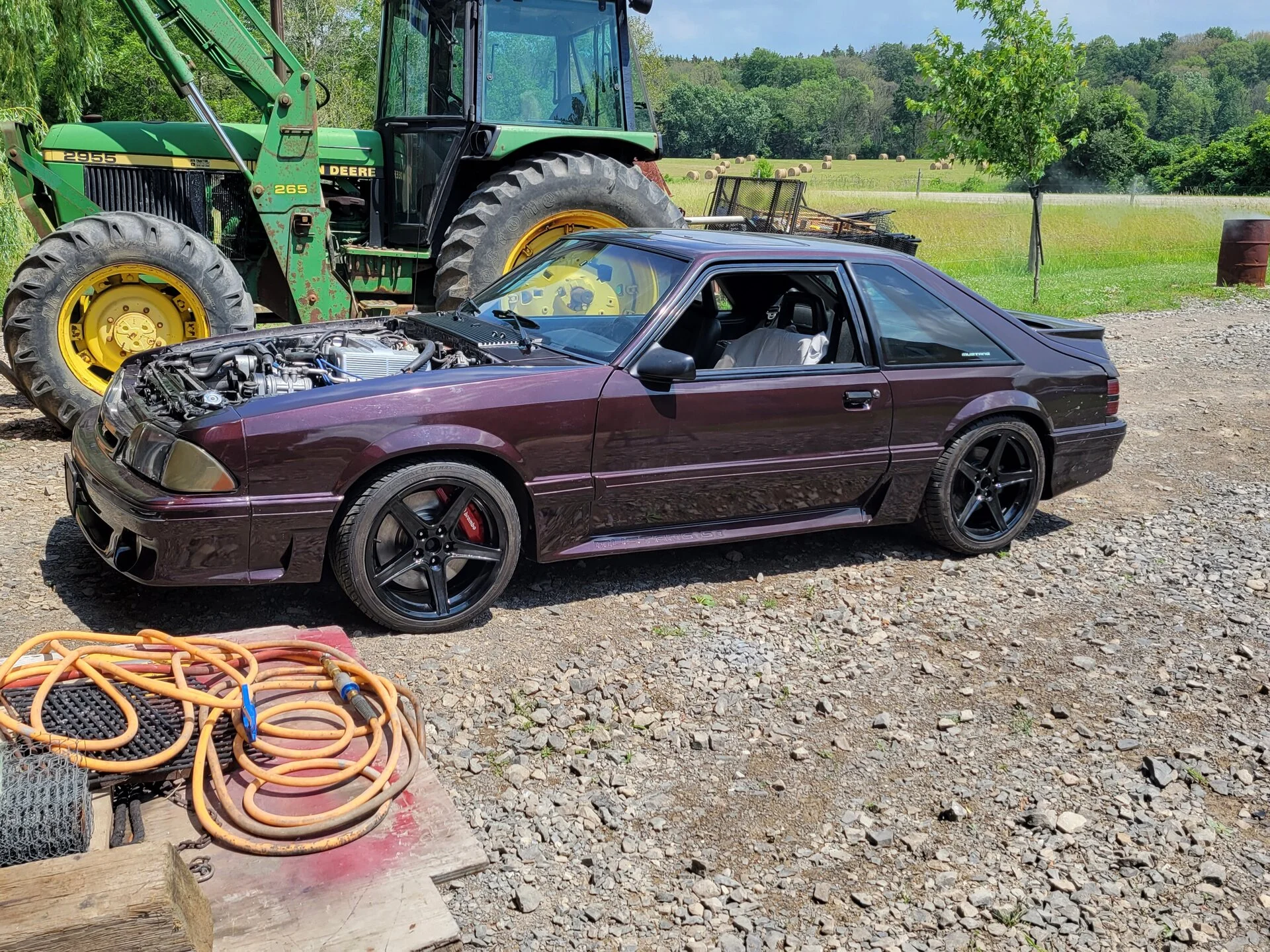

Finished install. Car was just put back on the ground. After the pic I test drove, bedded the new brakes and drove 500 kms later that day. Brakes worked excellent.
Will get some better pics this weekend after she get cleaned up a bit.

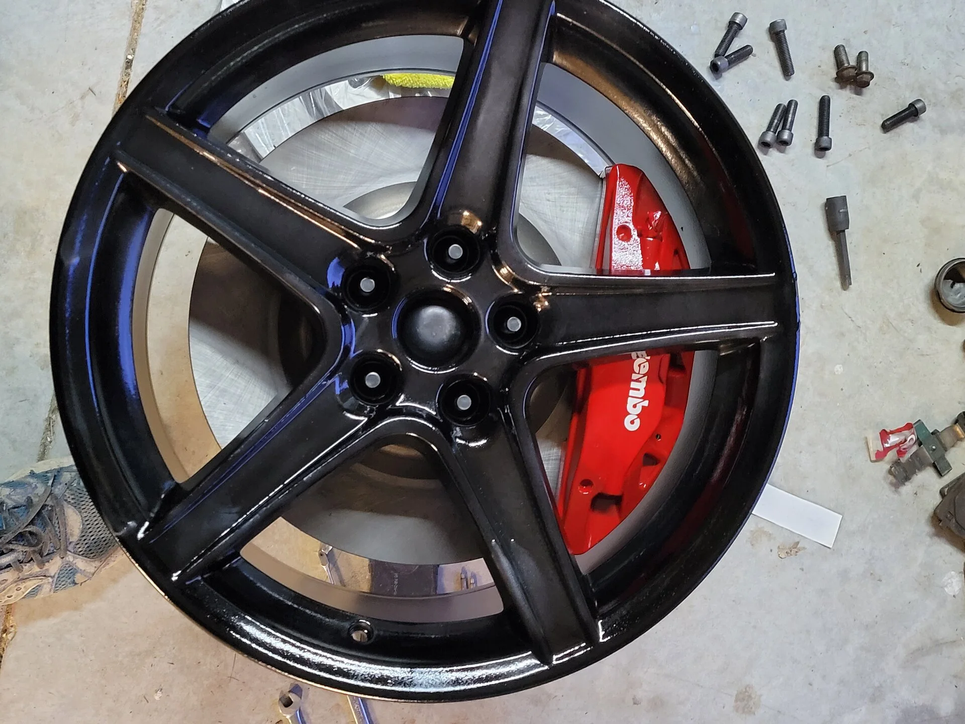

So to summarize what was needed. XTS calipers needed small amount clearanced to bring caliper closer to spindle, approx. 0.075". Caliper mount inserts needed as per Mustang5L5 and those offered by S&S Engineering (or make your own). Installed to lower caliper closer to wheel hub centerline. Front rotors are '11-14 Shelby GT500 14", no mods. No modifications to the factory 96-04 spindles I am using.

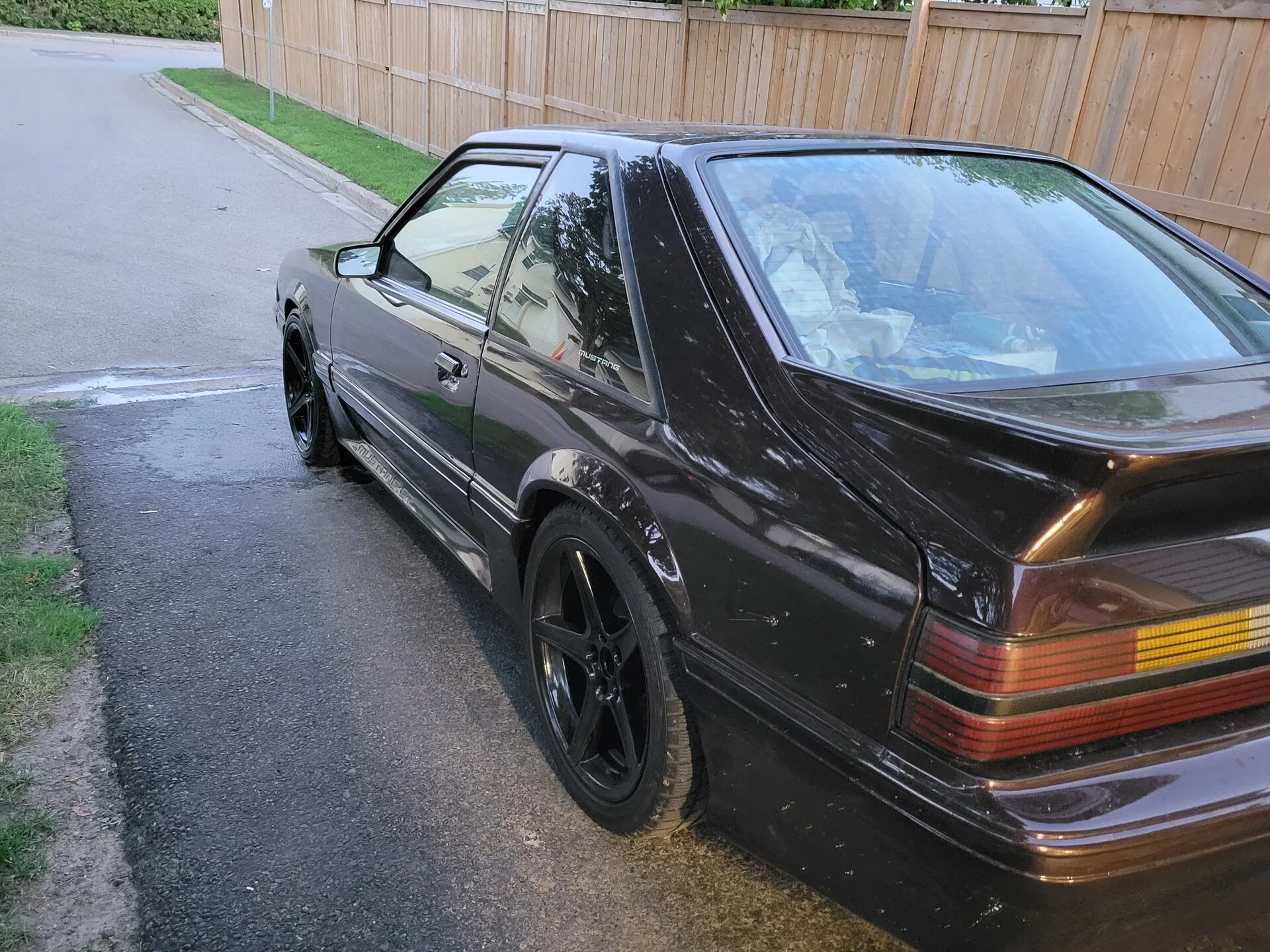

My wheels are 18x9 with 24mm offset. I used a 5/16" wheel spacer (between rotor and wheel) because the rim was hitting my coil-over spring. I believe a non coil-over strut would clear without the need for a spacer. Completing the 5 lug conversion I used Fox length axles in the rear, 11.81" rear rotors from a S197 and '00-02 Lincoln LS calipers and pads (43mm piston). Same rims and offset and used a 5/16" spacer as well because it looked too tucked under without them.
Tires in the pics are 255/35/18 front and 275/35/18 rear. With my previous setup I used 245/50/16 fronts and would rub a little on each side. With this setup there is no rubbing that I have detected so far. No clearance issues in the rear whatsoever. I could have easily gone 285 rear tire (and I still may).
