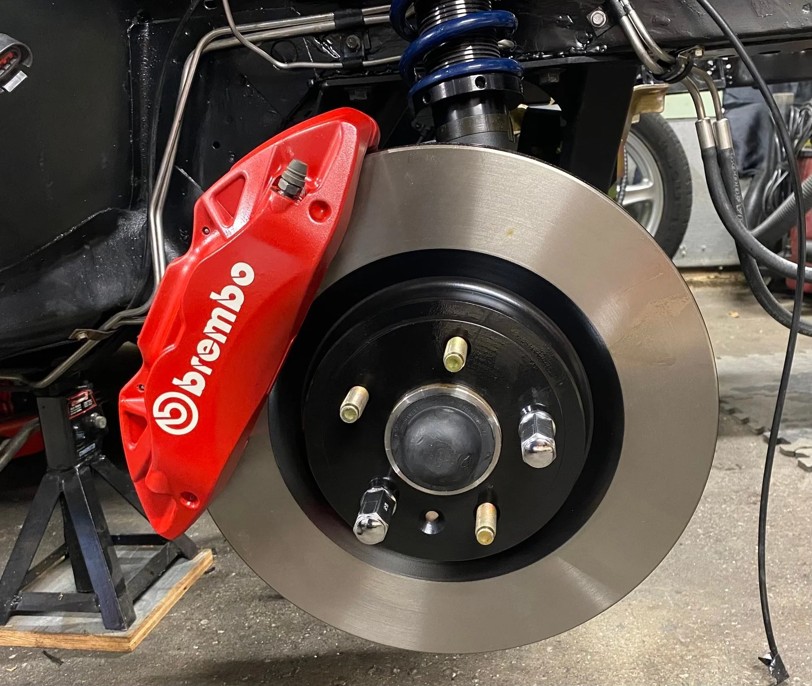

So, I finally got around to test fitting a '11-'14 GT non-Brembo rotor
In hand, comparing to a cobra rotor, the '11GT rotor was 1.2" thick, where the cobra rotor was 1.1" thick. It was also a tiny bit larger in OD at 13.2". The hub area was identical to the Cobra rotor. It slipped onto the Sn95 hub without any issue and was correctly sized.
The main issue with the rotor is the hat depth. It's deeper than the cobra rotor. Without any sort of spacer between the hub and rotor, I couldn't bolt the caliper up. There was no room. So a spacer is required to run this rotor. My calipers were machined 0.075" so I can run the inserts I made without any rotor spacer at all and the rotor would be pretty centered. However, did have a 0.075" spacer I made that I had to throw onto the hub in order to mount the setup up.

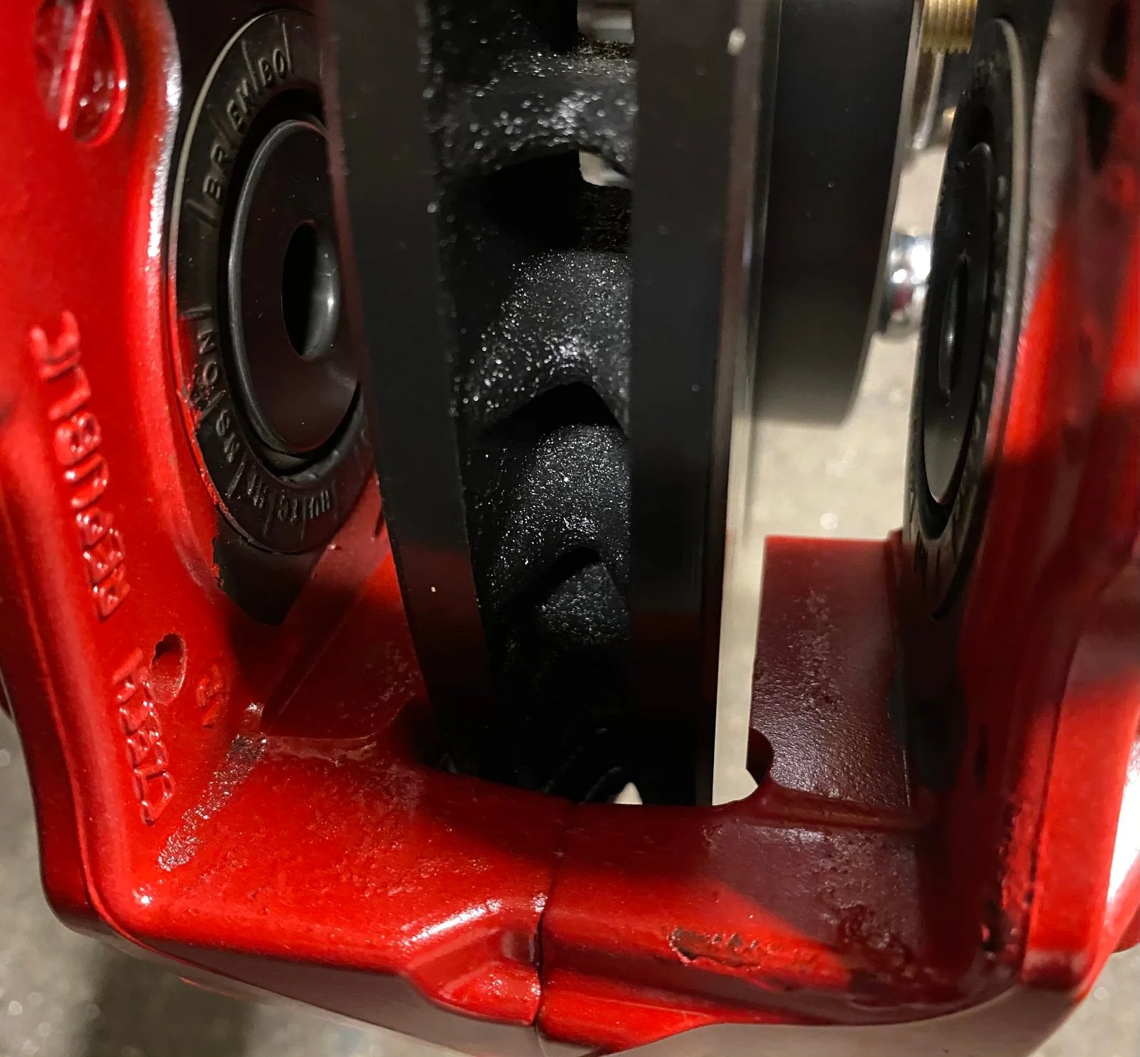

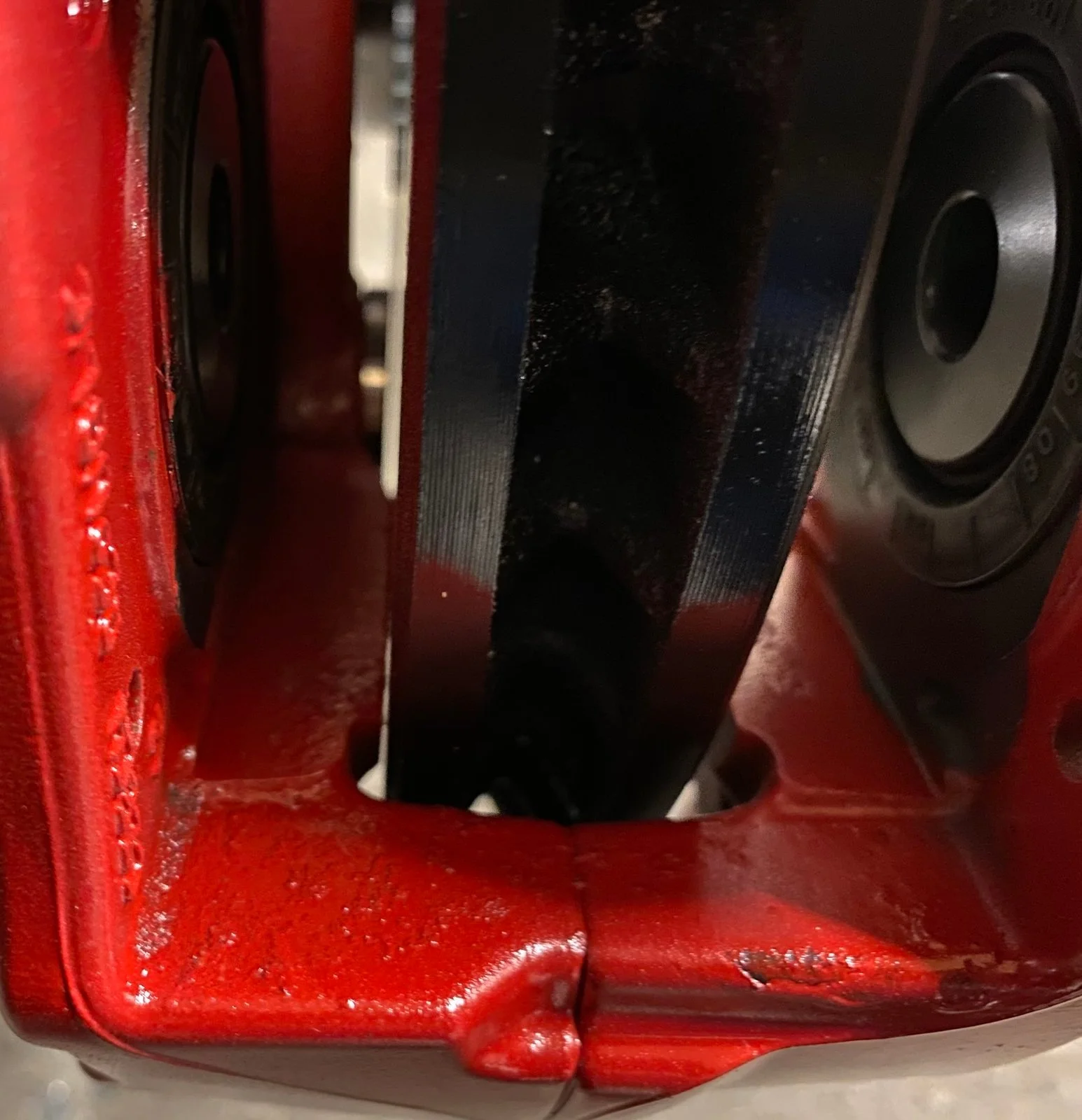

Now, offset wise, this is where things are not quite there yet. I'm using a 0.075" spacer, and my calipers were machined 0.075". That means it would be the equivalent of a 0.150" spacer for those with unmachined calipers. As you can see, not quite there yet.
Left side of pic would be the inner surface of the caliper towards the engine bay, right side is towards the wheel. As you can see, i'm very lightly contacting the inside of the caliper. I can't turn the rotor without dragging. That means in order to run this rotor, I need to add a little bit more thickness to the spacer under the rotor. I'm estimating that 0.025" would do the trick, but i'll need to confirm that.
If that number is right, that means you would need a 0.175" (4.5mm) spacer under the rotor to center up the caliper on the rotor. I think i'll try laser cutting up a spacer in the next few weeks and confirm this.
However, two things make me hesitate in going this route. #1, is the safety aspect of a 0.175" spacer under the rotor. I'm not questioning the use of a spacer, but at what point is a spacer too large to fit under the rotor? I would imagine one would want to upgrade your lugs in this case. And #2, is wheel fitment as you are now pushing the wheel out an additional 4.5mm. In my case, where I machined my calipers 0.075", I only need a 0.100" (2.5mm" spacer.

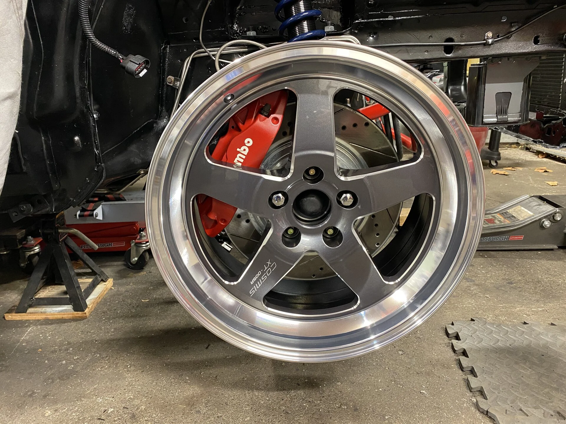

I abandoned the project. I wasn’t happy with the way it fit and it didn’t clear my wheel of choice.
The 11-14 13.2 rotor needs a 3mm spacer to fit. Problem is I couldn’t find one that sat flush on the hub. The hubs have an additional step where the rotor sits. I couldn’t locate an off-the-shelf slip on spacer.
final nail in the coffin was that my wheel of choice wouldn’t fit without enough spacers to push it past the fender lip. So I abandoned it.
the calipers are nice paperweights now. I went back to my PBR 2-piston calipers
