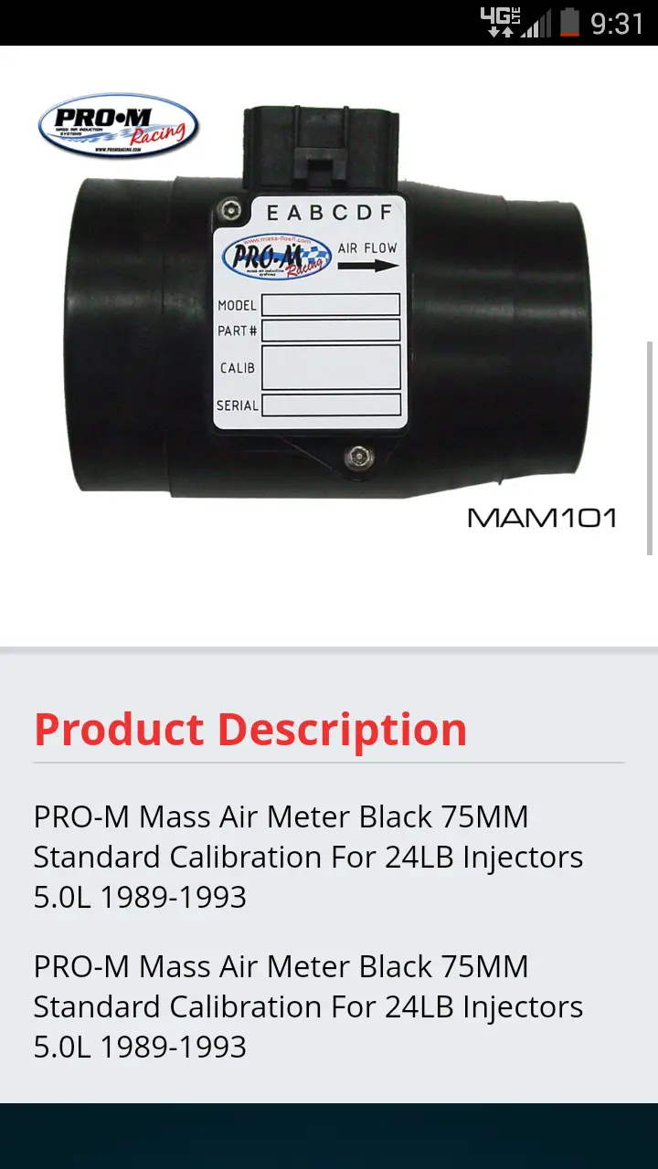

Swap out MAF for one calibrated for 24's.

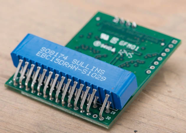

Put a tuner in the ecu and run current hardware.

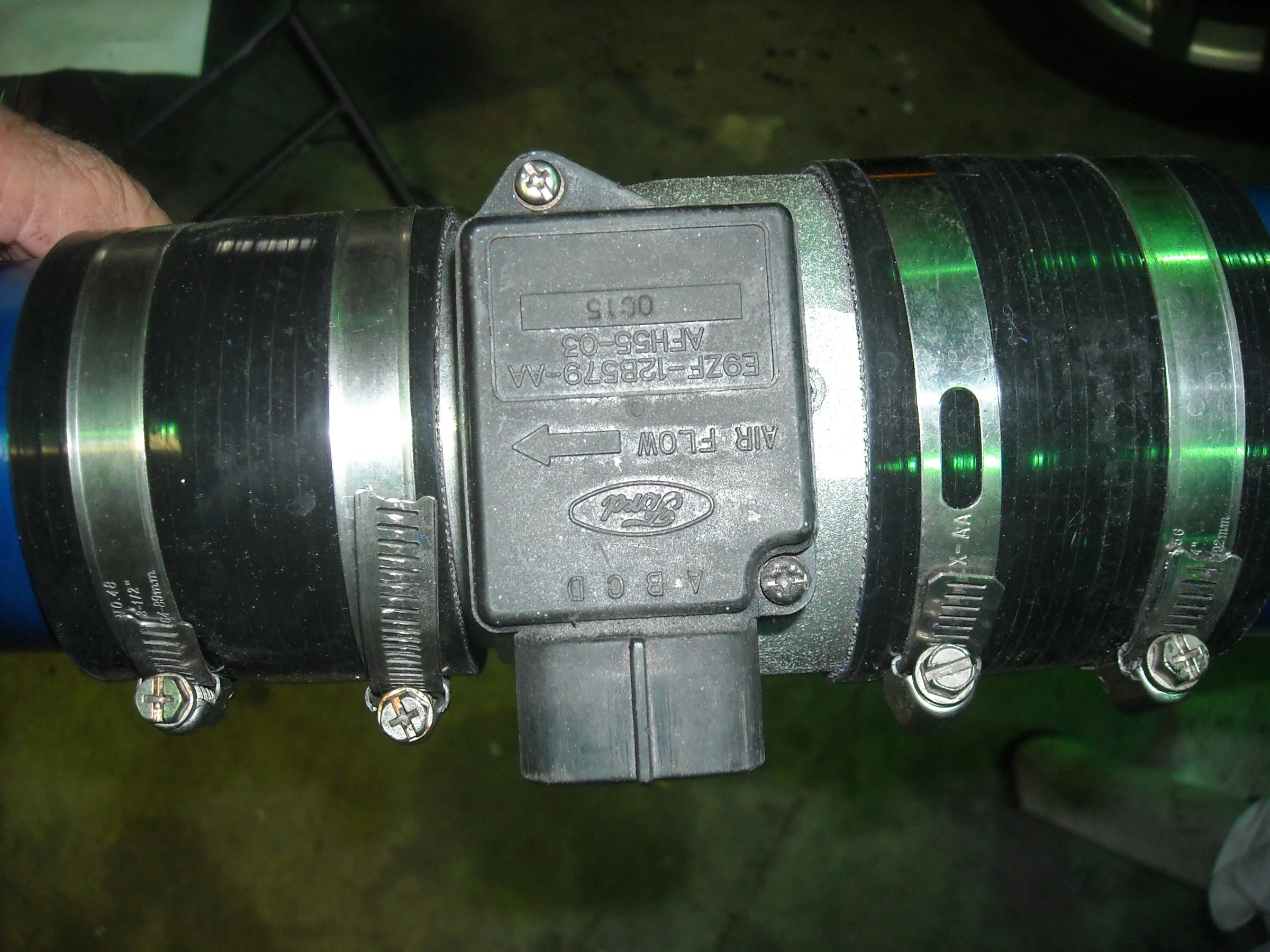

Post pics of your current MAF top bottom front and back
Close ups of any markings
Here is what I'm running. Is a maf tunable, can it be recalibrated?
Apparently no one can tell me what the specs are of this maf?

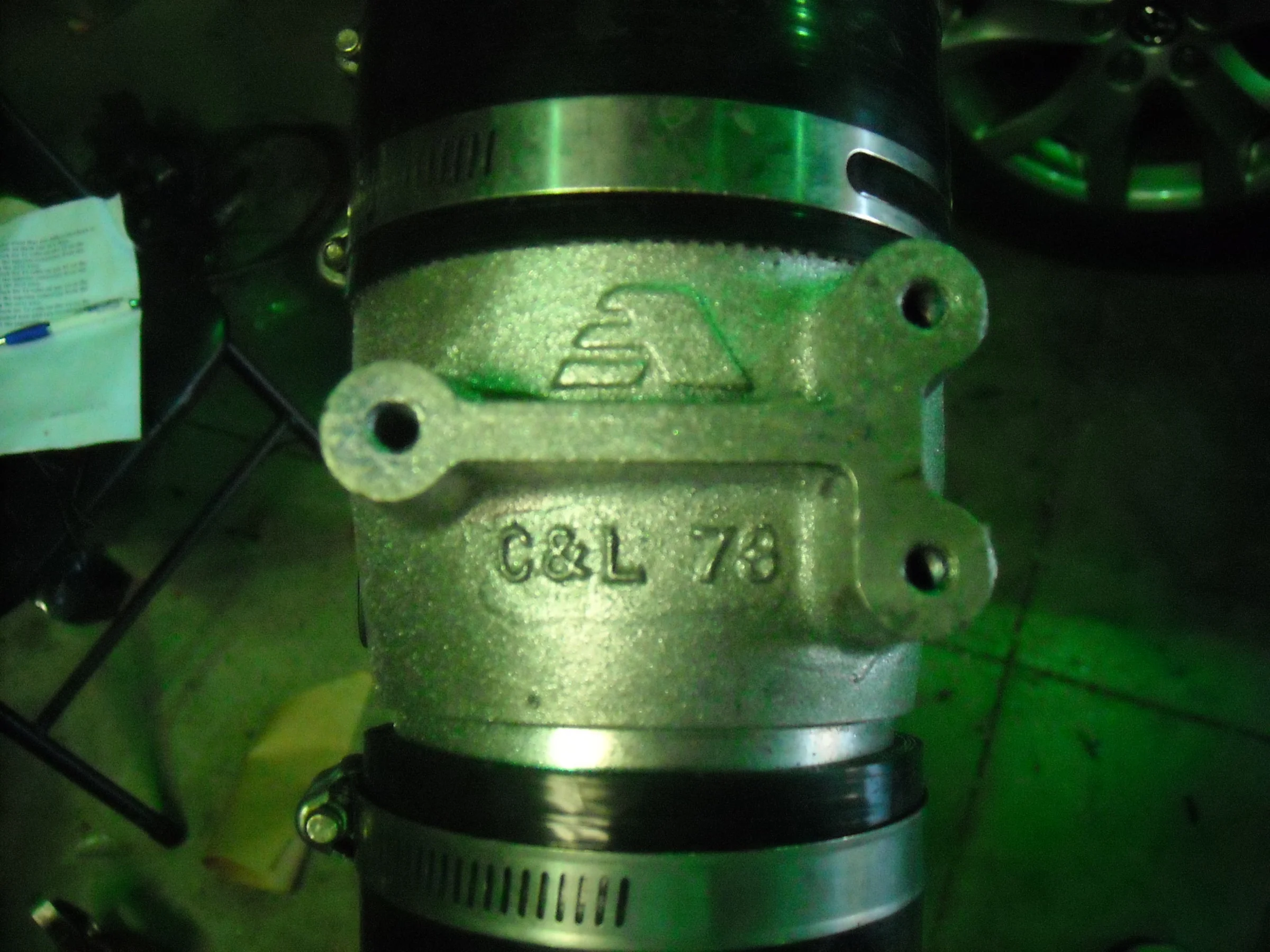

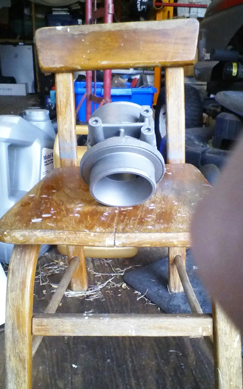

That maf should have a changeable sample tube. It is a C&L maf, I have one on my car but that one looks old style. You can get a sample tube for 24's or do this which I think is a better idea:

You will need to adapt the 4 bolt flange, I have seen a couple that were cut off, just google maf adapter,
According to the e9zf part of the part number that MAF is for a stock mustang 5.0 with 19lb injectors. A stock MAF can't be tuned. The only way the stock ECU can be tuned is with an external chip that connects into the computer. There are a few different ones....
Without the MAF or chip the car won't run right.
If it ran with 42lb and the computer that's in it then it should run if everything that was in it was put back on.
