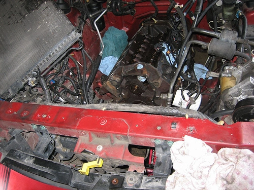

The condenser will rotate out of the way no problemo. No need to discharge the system. Done it on several SN95s.

Here ya go, found a picture, we just layed it over:
Larger version: http://www.flickr.com/photos/wesratcliff/515420126/in/set-72157600270540306/

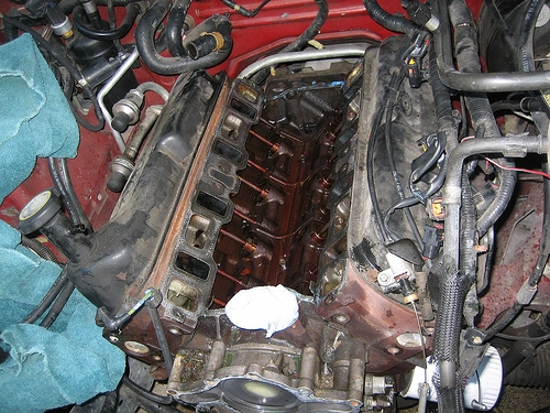

There sure is a spider than holds the dogbones in place, here's a pic of it in the same build:

I just did this. I didn't feel comfortable laying the condensor completely over onto the fender (fear of breaking something) so I rotated it up and over and then bungied the thing to the hood support.
