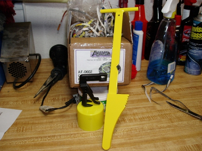

Get the AFM Chain Retention Tool here. http://www.andersonfordmotorsport.com/46-index
Good article in the June 2005 5.0 Magazine on how to use it. More info here http://www.stangfreak.com/

The motor is in the car. There's a couple pictures where Bill explains the concepts of chain tensioners and cam timing. If you look at the rest of the pictures, the work is done with the engine in the car.
