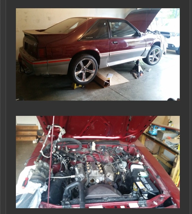

Hey guys, sorry for the delay getting back. Mike helped me through some things to check inside my A9L, as well testing the EEC relay and power to the A9L from there. Everything is looking good, so I am comfortably moving on back to @jrichker 's checklist.
The thing with this whole no start situation of mine is that the car ran when I last shut it off. I simply pulled the upper intake and valve covers to adjust rockers, and magically have no spark out of the coil, and no firing of the injectors.
The coil has power going in, the fuel pump primes, and the car cranks. All connections under hood appear good, and to this day I have still not disconnected the salt and pepper shakers since buying the car. I cant find a cut wire, all fuses are still good, and the car fired on all 8 and ran decent when I Iast shut it off, so I know my firing order is correct.
I need to revist "the list" find where I left off, and get back to it.

As I went through the list, I ended up taking the distributor apart and replacing the pick up, as well as the TFI module with brand new Motorcraft parts. Changed my coil also.
