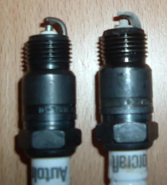

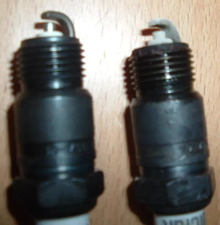

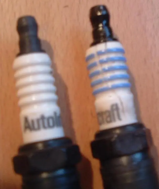

hmmmm .... is this bad? it is the plug that was on the wire that melted.
i think i found the problem

well that wasn't it :(
maybe i cracked it when putting it in before or maybe while i was taking it out ...
