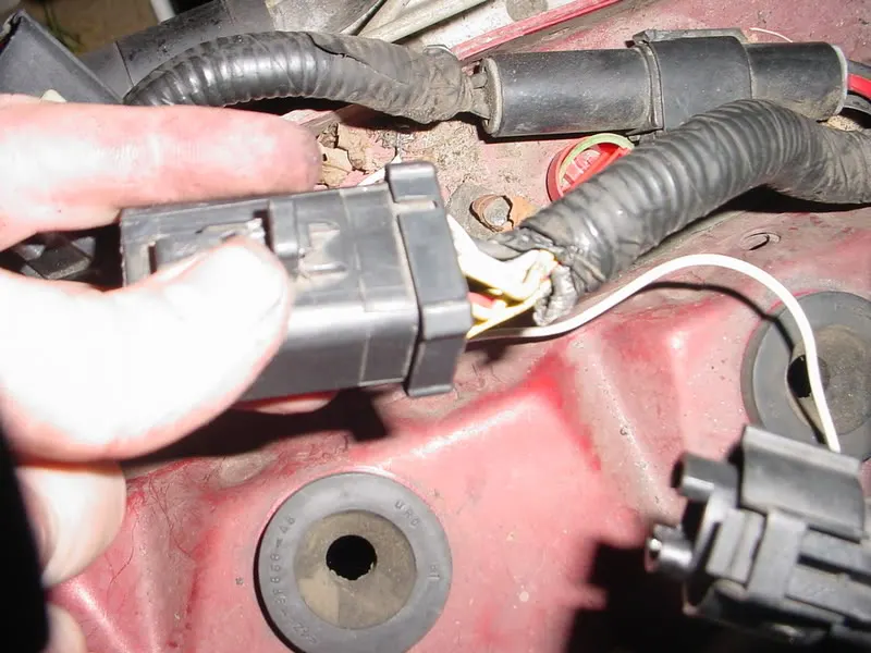

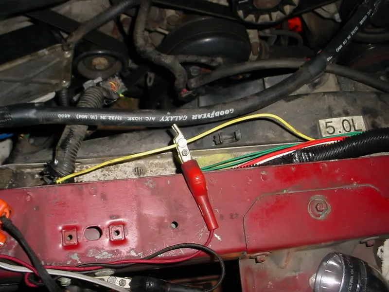

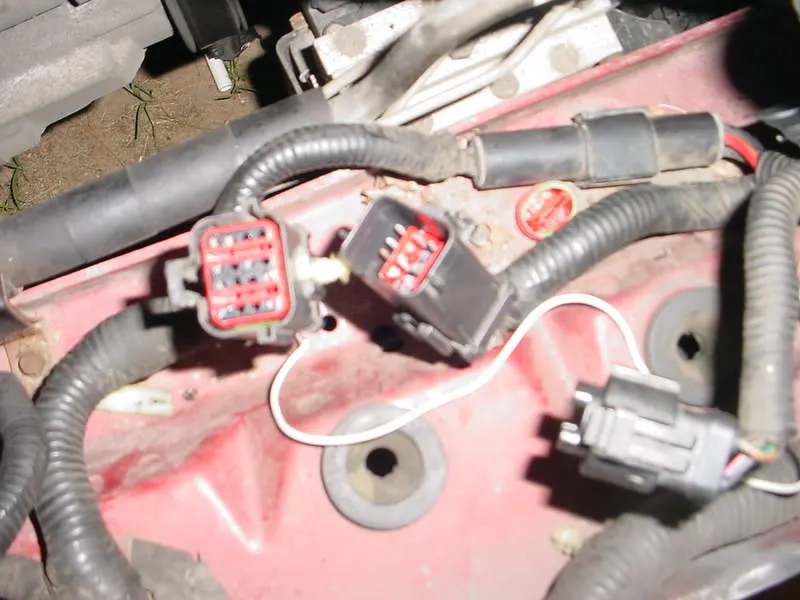

This is what ive gotten done... i think ive tracked down the wire... with the CCRM plugged in... and the connecter under the CAI unplugged the fuse stays fine.... I started jumping pins from the one connector to the other untill i found a wire that blew a fuse... It was a thick yellow wire that we traced with a tone device over to the EEC fuse... we clipped the tone device on the other side of the wire and traced it to #11 on the CCRM which if i read the diagram correctly goes to the fuelpump relay in the CCRM.... I spent some time looking at the diagram... Then realized that if i cut the #5 wire on the CCRM... For the fuel pump relay and the fuse still blew.... It has to be in the computer or before it..... SO we cut the #5 wire and there is still a short... Could my CCRM just be bad... or does this yellow fellow have a hole in it somewhere im not seeing????

no the ignition switch is good im pretty sure it was clean when i took it out... i think it has something to do with this yellow wire.... cause as soon as it is hooked up... the fuse pops...
when the ccrm is connected and this is unplugged the fuse dosent blow:
this runs through the top loom under the battery and EEC fuse

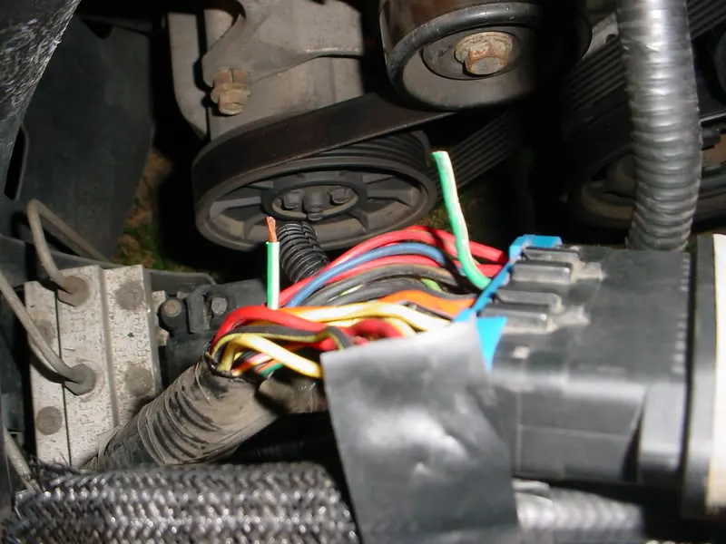

And in the other direction in to the CCRM... wire #11 and from the diagram... it goes to the fuel pump relay... i cut wire #5 which goes to the fuel pump realy and the fuse still pops:

I have to get this done tomorrow.... my car is in so many peices... but i think that this wire is the cause... because with that connector unplugged... it doesent pop... with that wire jumped... it pops...
