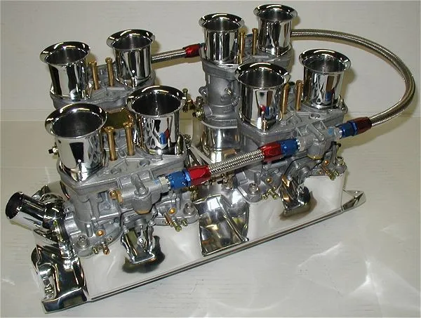

Can't say that I have... the $2500-$3000 for a set of downdraft Webers and a matching intake manifold is out of my current budget range...
Check out Wild V-8 Page if your pockets are deep enough to afford this WOW! kit.
now THAT would be a PITA carb setup to tune. But, for the looks alone I'd do it in a minute (that is after I find the 3.5k to buy it.)
