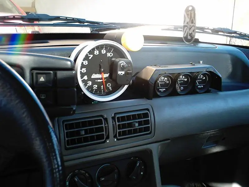

If Frankenstang can post a shot of her notch's dashboard, take a look at the black frame surrounding the oil/water/volt gauges on the passenger's side of the dash. That black doohickey is actually the bracket that once held the factory amp of that car (an '89) back when I had it. I just cleaned it up and zip-tied it onto the triple-gauge setup to hide the wiring and such ... and because I like to ghetto-fy my rides with cheap ways of rigging things up.
As stated, on an '88 it should be right there behind the stock radio, bolted down onto the trans tunnel hump. If it's already been removed, you're going to have to fish around for the loose connectors. Also, you're going to have to get a wiring harness for your CD player for a "Ford premium stereo" configuration - it's different than the standard harness used in most Fords and has a funky little square connector you need to use to bypass or run through the factory amp.
