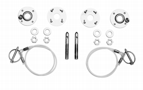

tjm73 said:
If you must buy hood pins, only buy stainless steel kits (Ford's is stainless I think). Chrome and other crap will rust and look like....well....crap.
M-16700-A Stainless Hood Pin Kit MSRP $34.95
http://www.fordracingparts.com/parts/part_details.asp?PartKeyField=1279
