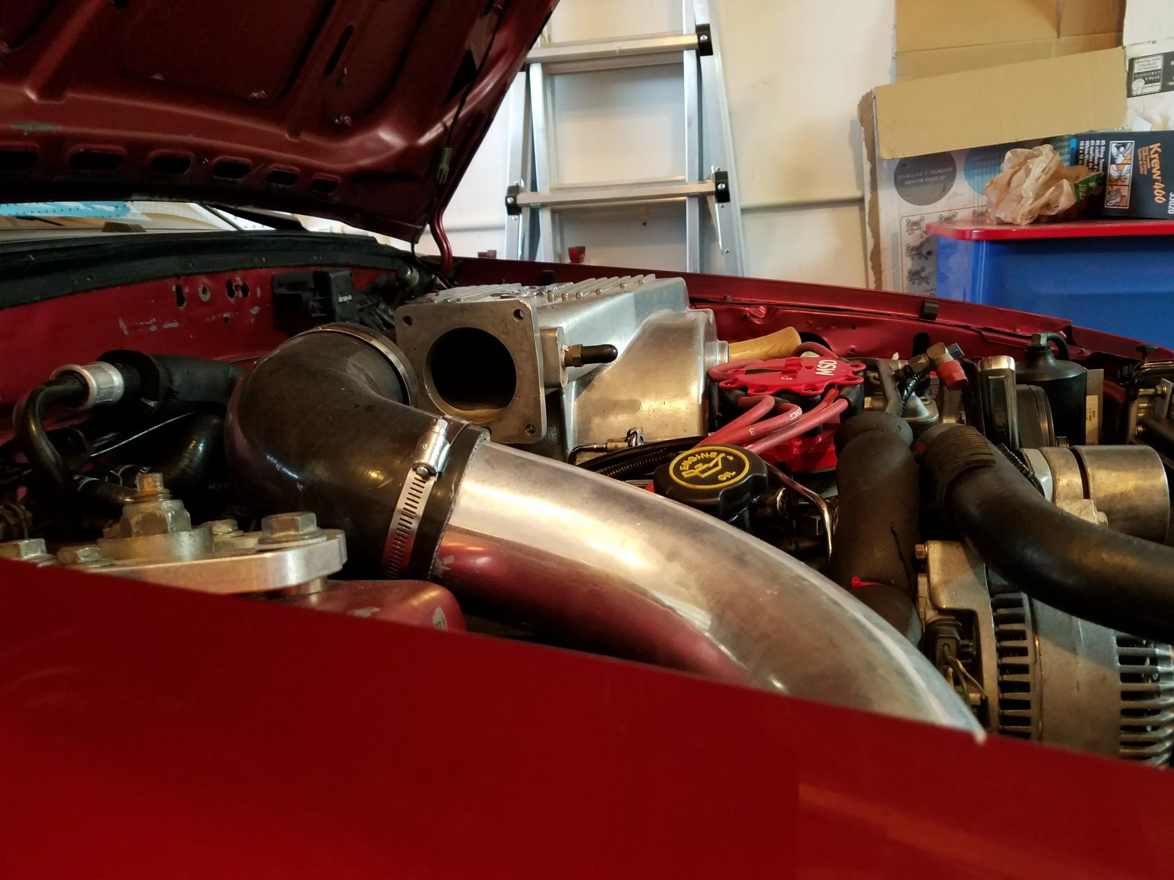

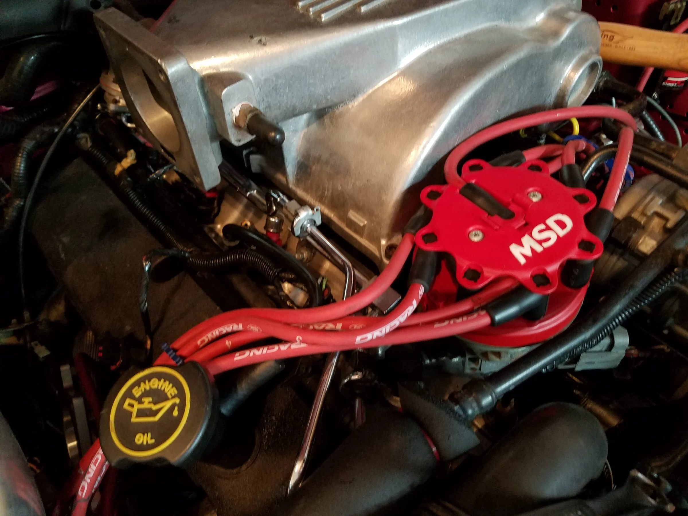

Well, my motor mount modification worked out. I test fit my 3/4" plenelum "spacer" today and it clears the stock hood.
